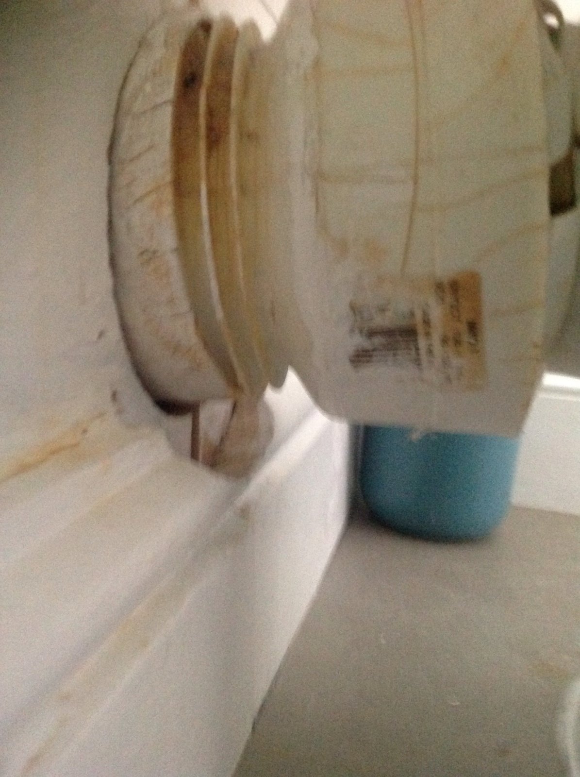

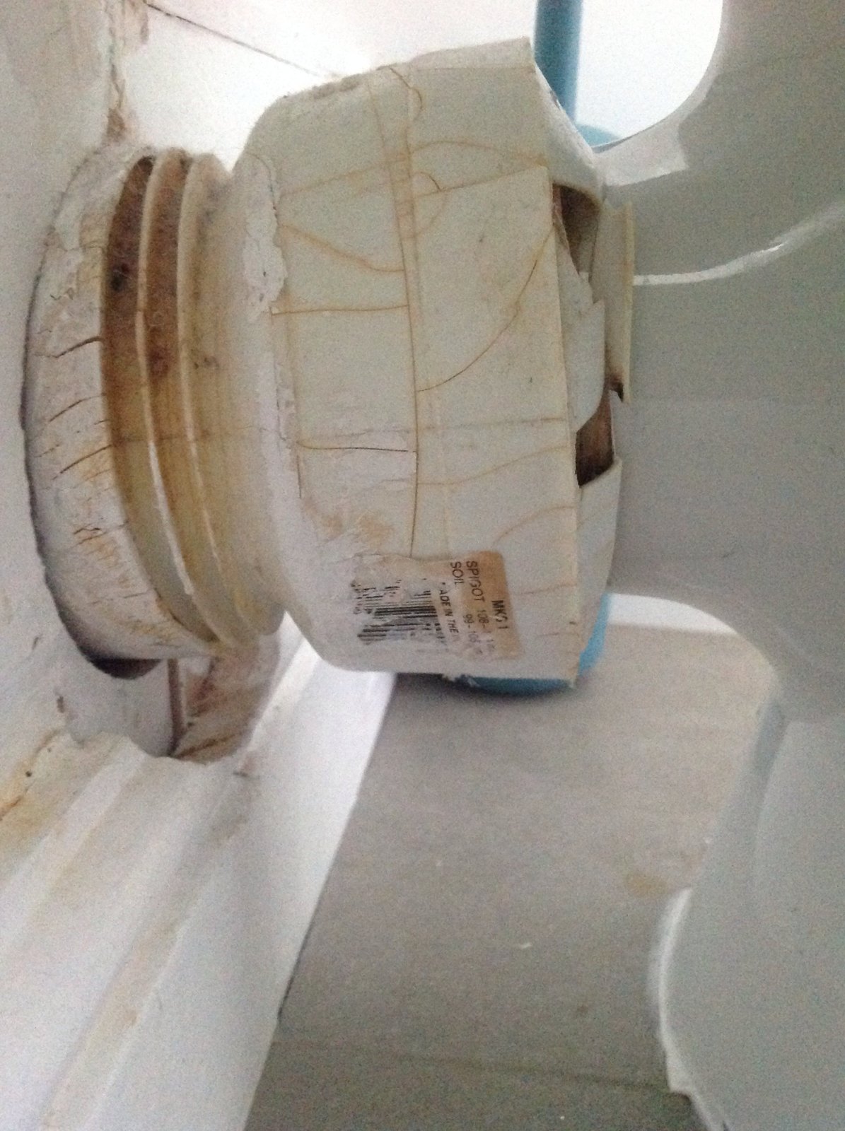

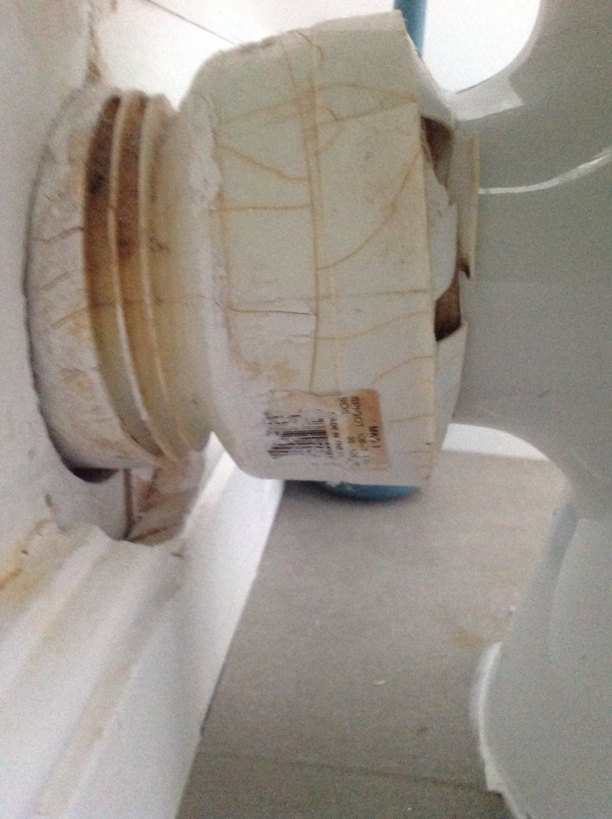

Morning the waste to the soil pipe is started to cracked and needs replaced it is not leaking just looks rubbish I have enclosed so pics is it easy to replace and what is the replacement needed called thanks
Its a short straight pan connector. The toilet pan is almost certainly going to have to be removed and replaced to get a new one in.
It tells what it is on the label. It's a multikwik MKS1 straight pan connector.
Don't think the pan needs replaced though. ;)
Thanks I wil get one thought I would get away without moving the pan but needs must. Thanks again
Depends, if the connector pulls out onto the pan spigot enough to clear the pipe, you might get away with it. Give that a try 1st.
