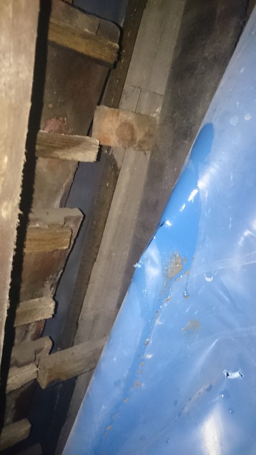

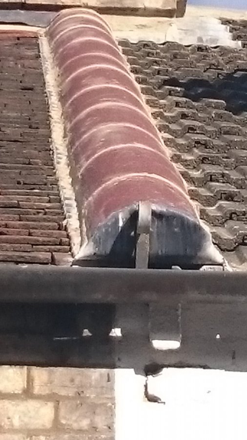

Hi
I've been having trouble for few years with the join between mine & my neighbours roof, eventually landlady admits liability, agents get in contractor, roof still leaking...
Now I'm not a roofer (neither was he I don't think) but I think that grey stuff should be underneath the tiles not on top...

1.The existing join between the roofs is not the best way of making such a join. "Joining Gutters" are the best practice.
2. The loft pic shows a lack of underfelt below the join, & lack of batten support.

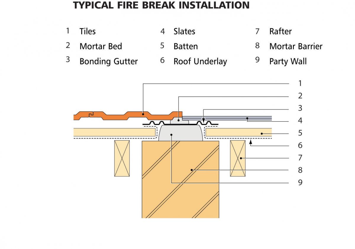

3. The party wall should run up to just below the join - this is a privacy and fire risk issue.
4. At the base of the chimney stack you have lead apron flashing - there should also be a lead saddle flashing from the apron over the first half round tile. Its possible that the leak(s) is from that position - but its irrelevant in that whats there should all be stripped off and a Joining Gutter of some kind be installed. Repairs wont work.

I think some kind of joining gutter has been used, but not in the right place. It looks to me as though it has been put on over tiles rather than under.
There is no felt under my tiles, roof is original, 1890s, next door has had new roof at some point & whether it was never done properly in the first place or just wear & tear, water's coming in.
There is no party wall, I agree there should be, there is one with my other neighbour.
Had new flashing round chimney few years ago, rained a couple of days later, leaked. Didn't make slightest difference, except to my pocket.

7. are you saying that there is a joining gutter below the half round tiles?
8. neither roof has tile from the 1890's? Whats the situation with the roof at the back of the house?
9. the indications are that the roof is leaking at the join not from the roof plane(s).
10. a pic of the stack would still help?

Yes there is something between the tiles & the half round tiles, the grey stuff. Isn't that what's supposed to be between the battens & tiles?
That is the back. Front is pretty much the same.
It's been dripping/ running down the walls of both bedrooms, front & back for at least 2 years. I can only get to the inside at the front, by crawling through the eaves? in the attic room, to the void between the 2 houses where some kind of fire wall should be.
I'm assuming the front & back are identical.
I just assumed mine were original as they look it.
What is the roof plane? The inside pic shows my tiles on left, neighbours on right, the edge of her tiles are dripping wet. Visible drip on the blue.

The "grey stuff" i presume is the sand and cement mortar bedding-in the half round tiles. Its an irrelevancy in the scheme of things.
The "roof plane" is the large area of your roof covered with tiles as distinct from the join - the other side's clever solicitor could claim that its leaking from your roof plane and appearing in some mysterious way on their side of the join.
Why not post a pic of the front roofs? Dont assume anything - post pics or describe.
