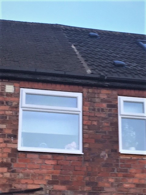

leak between neighbours and my roof

My neighbours roof was renewed some years ago and were it joins mine it hasnt got a roof drainage channel in between just cemented at the joining tiles He had leaks there this week and a roofer told him what was wrong and told me the water has made some of my wooden lats go rotten My roof is original so didnt need the channel .Who is responsible for the damage
I was also made aware that the dividing boundry line is over my side with there tiles I have never noticed with " senior" eyesight How do you resolve that What a mess .I am bl00dy mad about it
