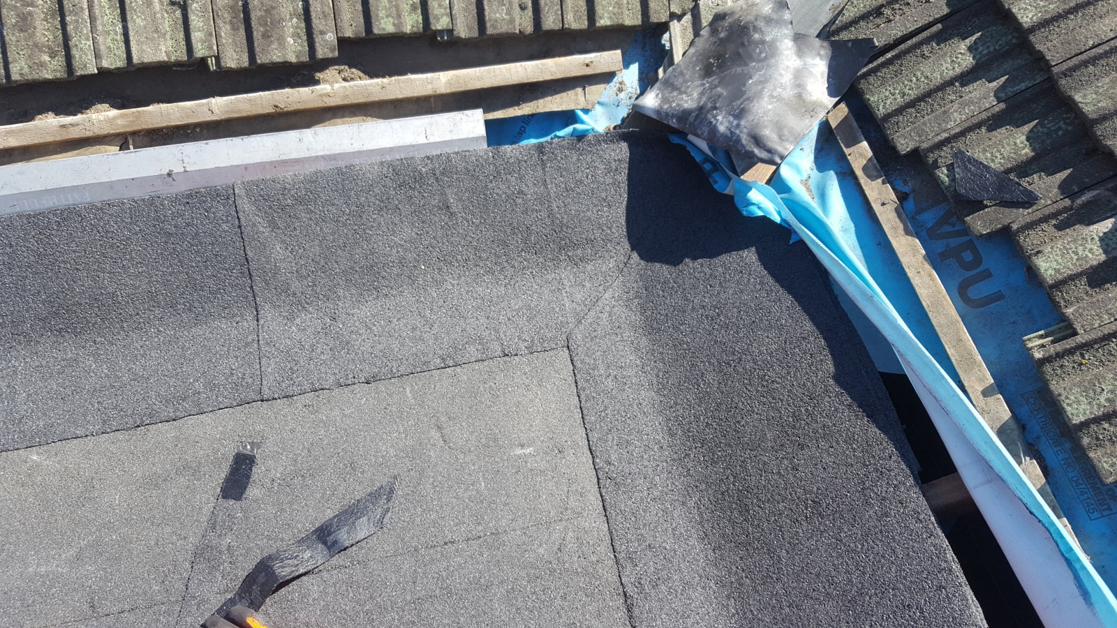

I did the Firestone EPDM contractors course in Cheshire some years ago, it is more suitable for DIY than other materials like torch on felt, with Firestone they have a technical dept with a bloke who's job it is to deal with customers enquiries about how to fit EPDM his name was Carl Bailey, so anyone who bought Firestone could if they had any queries about fitting EPDM could ring firestones and talk to this bloke.

What if it rips. Or stretches to much over time it will degrade one hole I find problems so I still prefer torch on felt 3 layer system as you see rubber is 1 layer torch on has 3 layers witch more protection
Three layers does not offer any more protection. If the top layer is breached, the roof leaks just the same.
Does not rip or stretch .
