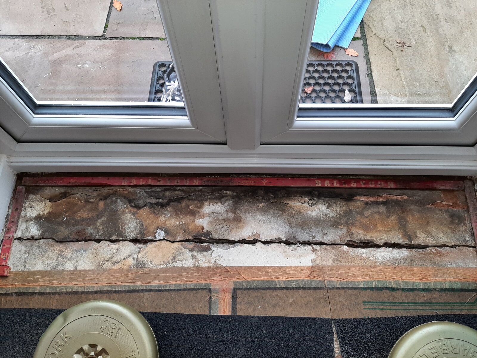

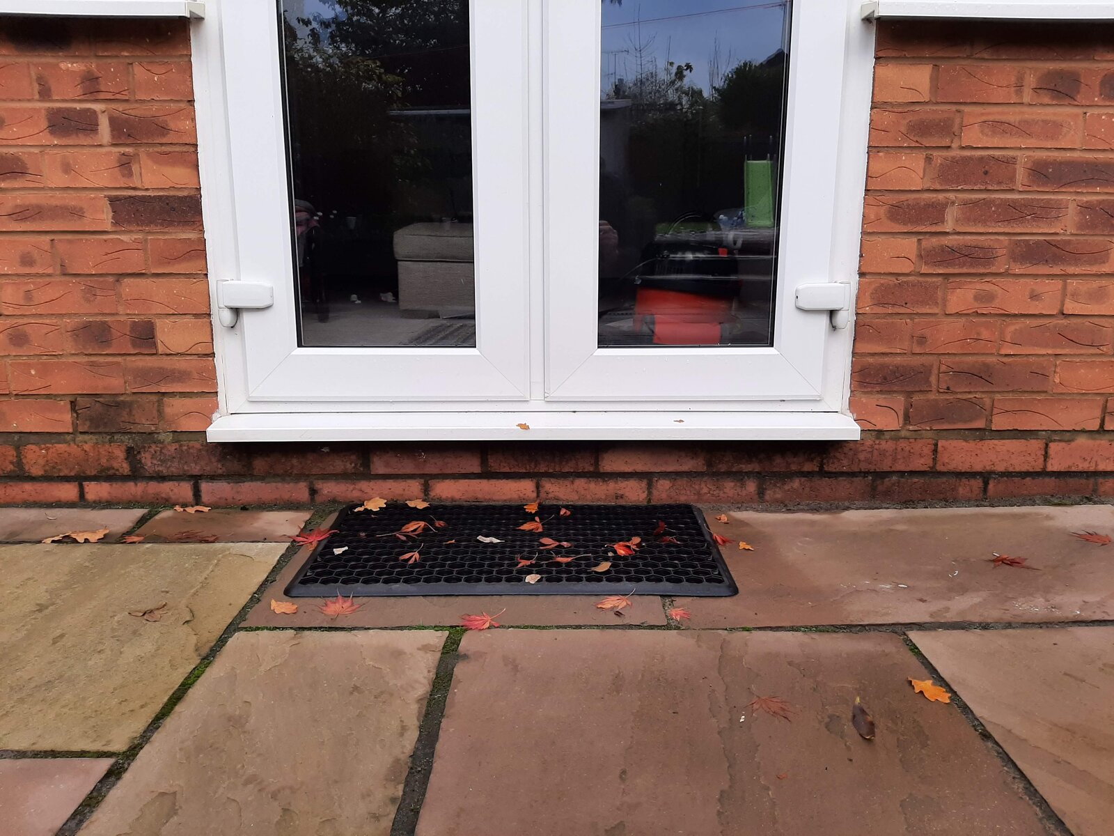

I have a damp area by my upvc french doors.

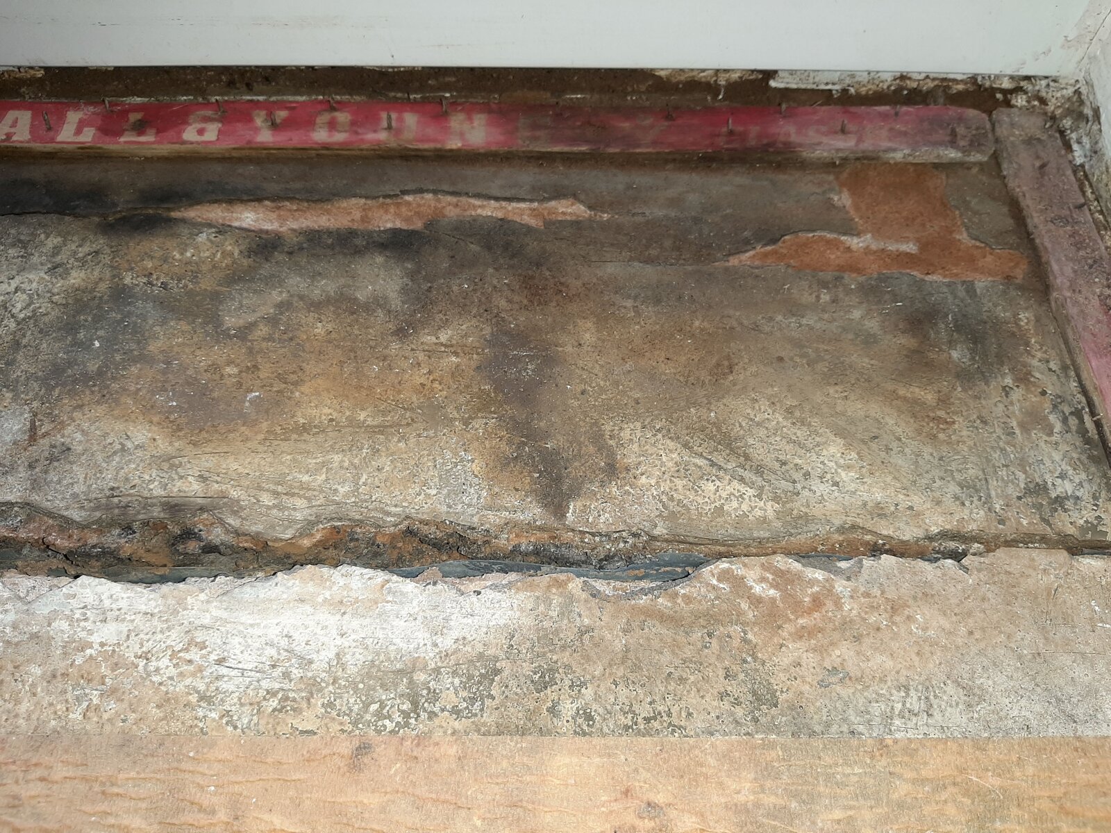

There is a crack in the concrete floor approx 16cm from the doors. In this crack I can see what I presume is the plastic floor dpc? I've attached a picture. Should this run all the way up to the door?

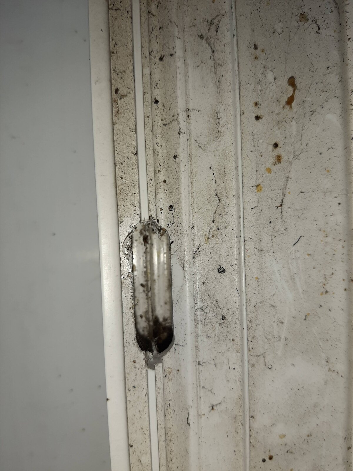

Should I be able to see a hole at the bottom of the drainage hole?
What can I do to resolve this?
Thank you in advance.
Looking at it again, it looks like the plastic floor membrane runs up to the inner wall skin of concrete blocks (where the crack in floor is) Could I take up the thin screed layer and paint a liquid dpc up to the door?
