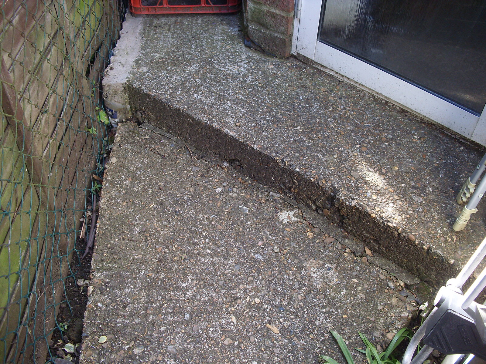

Pic of the front corner:

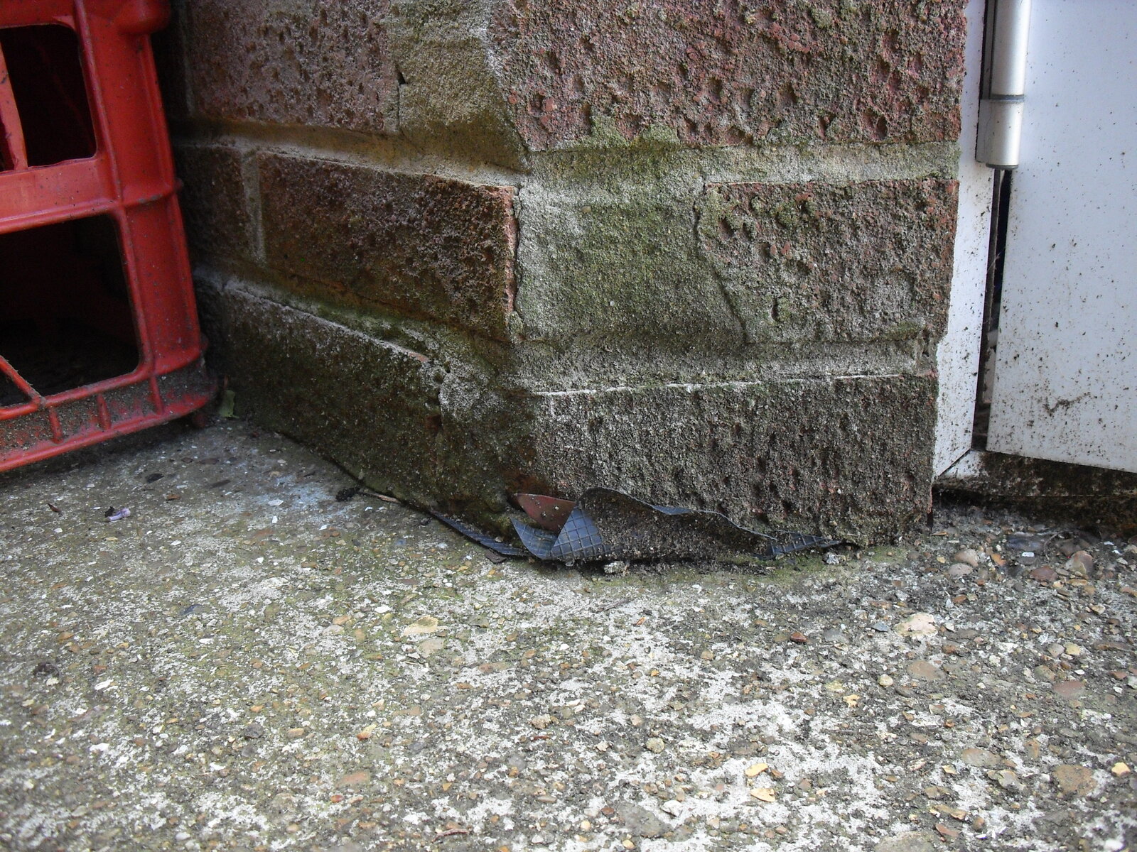

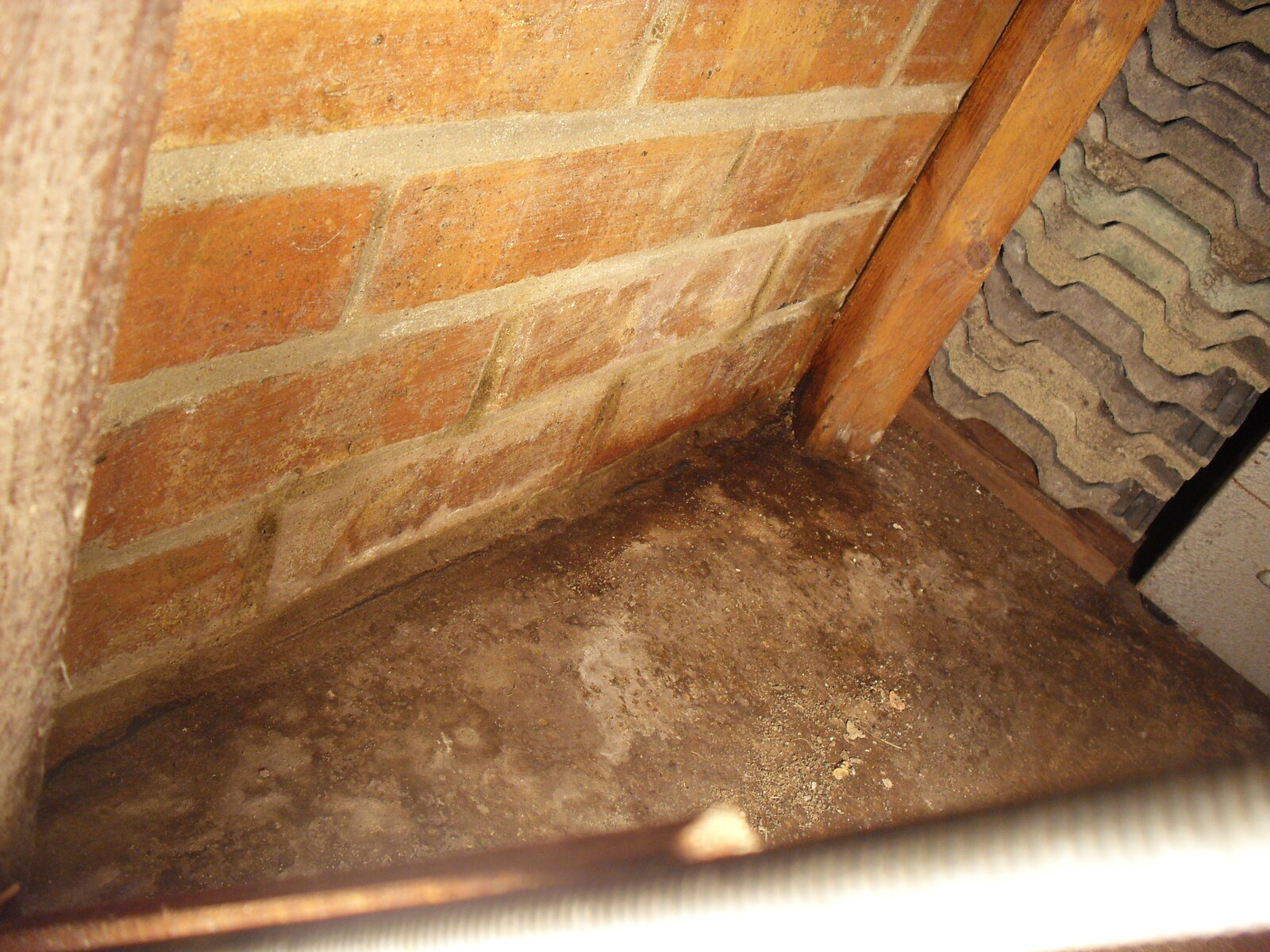

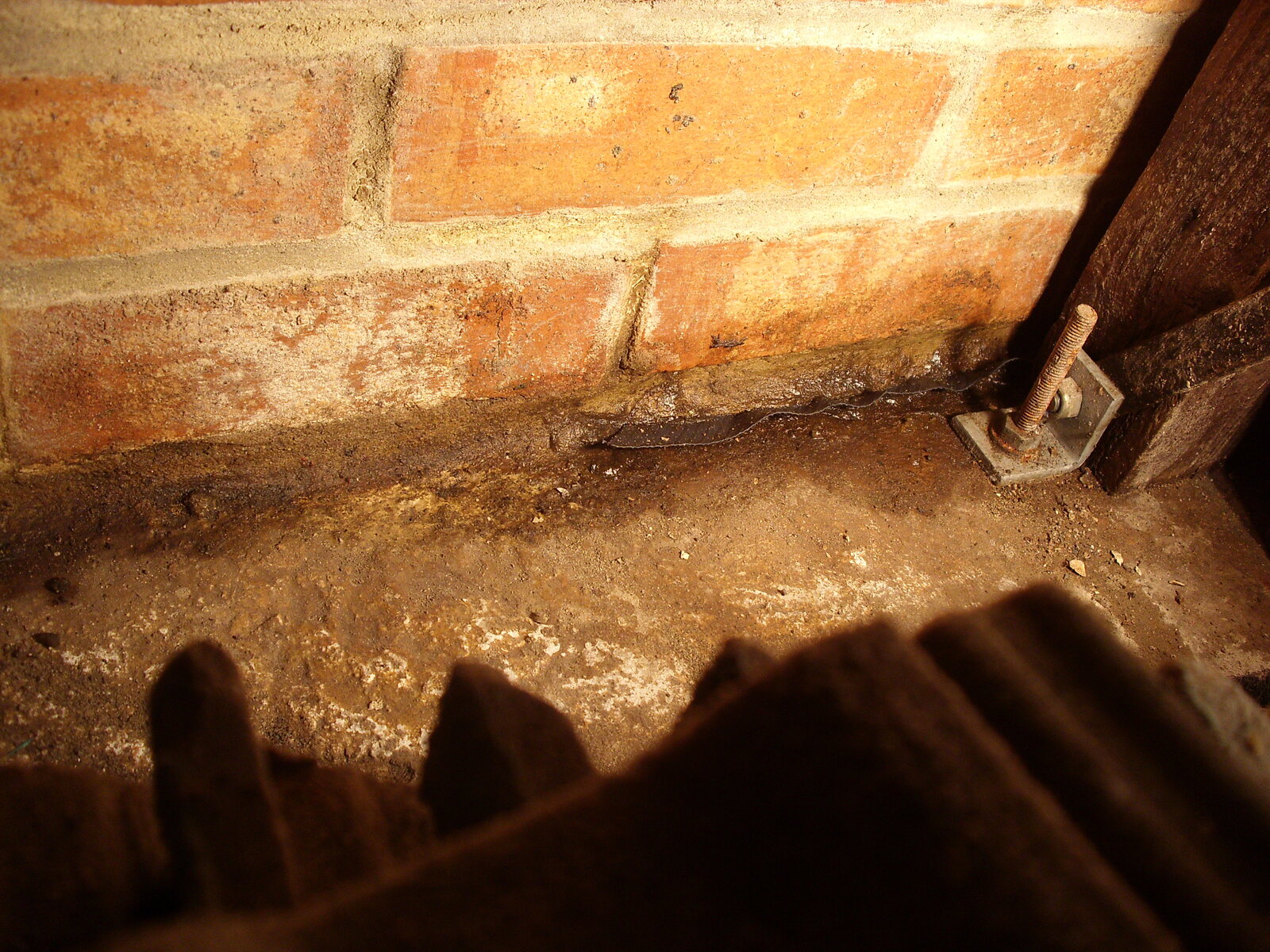

Having a big sort out recently I've removed loads of the accumulated crud and found the floor is very wet along part of the wall to the left, it's obvious the rain gets under the DPC.
I've thought about silicon sealant but it doesn't feel like the right solution.

I'm assuming that's a pic of the outside, in which case the dpc should be ideally at least 150 mm above exterior ground level.

Yes outside, also:
Basicallt this shows a triangular step. roughly 75mm AGL and the slab 75mm above that. the whole slab slopes down directly left of pic. The lighter colour strip on the left was added last year to stop the gap filling with dead leaves and animal poo, it drops down steeper than the slab.
Other than chopping the slab away (like I did on the back wall) there's not much I can do about the design.

I'm guessing it's a design flaw, and you're kind of stuck with it.
If you add a filet of cement to the outside, you're bridging the dpc.

The slab was there when we purchased the house, there was a shoddy timber framewith the slab poured around it, ie the posts were set in the slab. Sheeted with corrugated clear plastic roof panels. Estate agents described it as shed requiring attention in reality it was more like a greenhouse.
We had 3 builders quotes and all said they'd brick build in the same manner.
After the initial trouble it was dry for ages. As can be seen we have a 100 roof tiles and matching peg tiles following a little building roof for 12 years so we lost sight of the floor under the bench since then.
