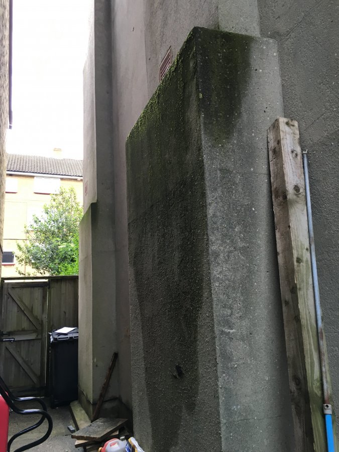

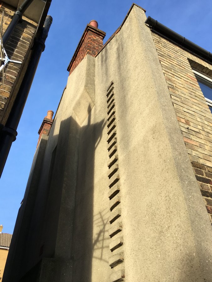

My 1880s end-of-terrace house is suffering with rising damp/rising salts in the flank wall & chimney stacks and I'm stumped over how to fix it.

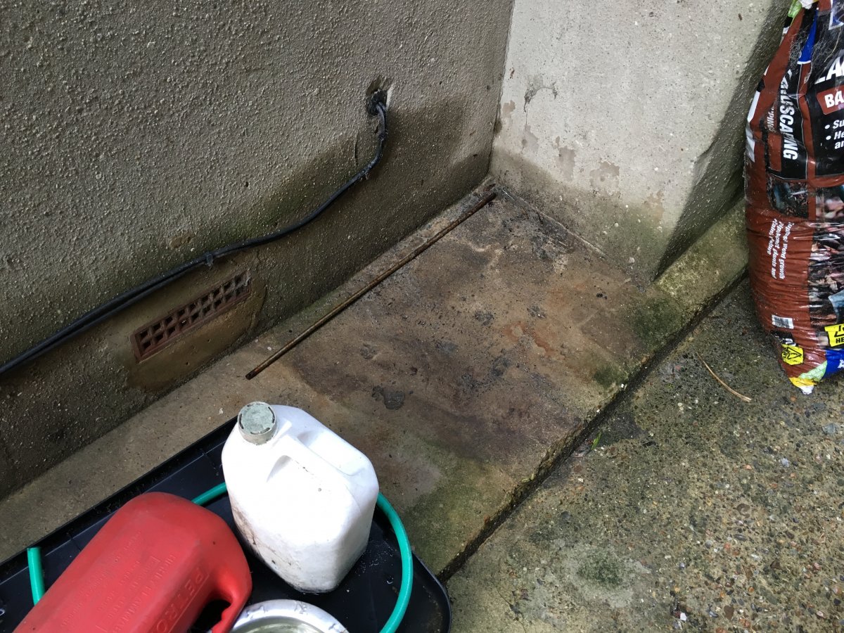

The house was a mid-terrace until WW2 when the house next door was bombed, so the external flank wall was originally built as an internal party wall. Therefore, the slate DPC is just 1 course above sub-soil level - far too low to be effective.

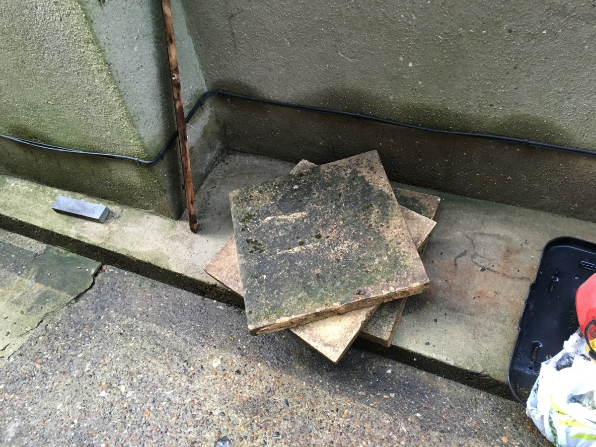

The external face of the wall was rendered with a sand/cement mix (presumably around 1940) and has a concrete 'upstand' at the wall base which acts as a soakaway.
I've received mixed advice from surveyors and builders. An independent damp surveyor recommended I just use a meshed membrane internally, but I would really like to fix the problem rather than just cover it up. He was concerned that the concrete 'upstand' is of structural significance, but I don't see how or why this would be the case.
I'm interested to hear people's opinions on what to do about it.

- Remove concrete upstand and install a shallow french drain to reduce ground levels and improve drainage

- Remove moss from 'shelves' of chimney stack and treat with Stormdry biocide
- Rake out and patch up any cracks in cement render
- Spray entire flank wall with Stormdry (breathable microporous sealer)
