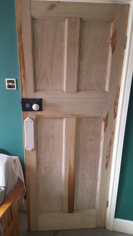

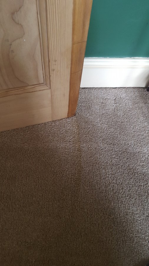

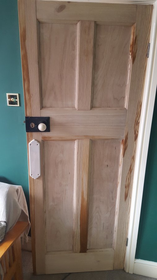

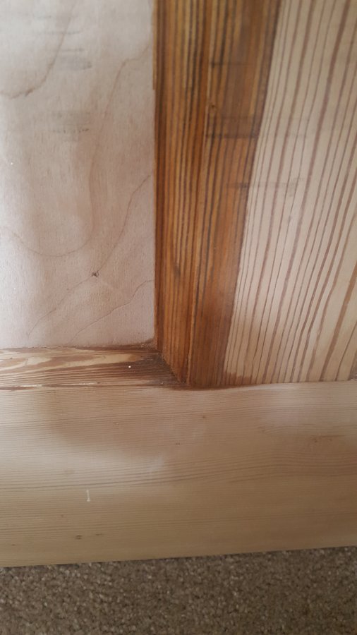

Hello. I've very recently bought a house and having just moved in it appears that a lot of the internal doors are weeping in places. I've not observed any drips of fluid, they just appear to have damp patches, though at least one is staining the carpet brown. All of the affected doors are unfinished (no varnish or paint).
Is there anyway I can stop this happening? I was hoping to paint/varnish the doors, but I'm not sure how good the finish will look given the damp patches. Any advice is greatly appreciated. Thanks.

Looks like the doors have been dipped and not allowed to dry before refit, I would take off the doors and dry outside in a covered area before reinstalling.Could be nasty fumes if chemicals have not been cleaned effectively.
Thanks for your reply. I've looked up what you meant by dipping and it seems like quite a nasty process. I certainly don't like the fact that they could be leaking chemicals into the local atmosphere. I've noticed a few splits on some of them too, which backs up your hypothesis, from what I've read. And it's perfectly likely they still haven't dried out yet after several months (we first viewed the property 4 months ago and they were hung in their current stripped state back then)?
I wish you hadn't told me that! That's going to bug me something rotten.

I'm not sure they are upside down; my grandparents' house had doors where the upper panels were smaller than the lower panels.
Which is larger, the top rail or the bottom rail? I'd say the end with the bigger rail is always the bottom, irrespective of the size of the panels.
E.g.
http://www.ebay.co.uk/itm/Reclaimed...ed-195cm-x-76-cm-c-w-lock-knobs-/131767535826
http://www.ebay.co.uk/itm/Reclaimed-four-panel-internal-solid-wood-beaded-doors/272297221133
Or is there some other clue about the orientation?
