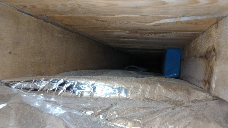

I also did some work under the floor in the adjoining dining room in 2012 installing insulating foil using a staple gun to the joists. At that time i recall being able to see through an air brick into the kitchen.

When you had the floorboards out, did you see something like a piece of slate between the brick courses below the joists? If there is nothing like this, and no other DPM, there might be some damp rising from the ground, which might not evaporate quickly on the side with the radiator but not on the other.

I finally got under the floor boards today in the adjacent dining room behind the affected wall and discovered the likely reason for the damp.
There is a physical damp course on which sits what looks like a 1" high by 'brick width' plank of wood.
I'm assuming because there is a vertical 1" piece of wood attached at some point to this horizontal piece of wood - rising above, that this was to attach the skirting board and was installed when the house was built in 1906.
Anyway this wood is rotten and spongey below the damp patch on the other side of the wall. I can push my nails in and took a piece of that out in my hand. :(
I also borrowed my mum's damp detector thing and it beeps off the scale at certain points along both sides of this internal wall. But some points are dry along the skirting so it is localised.
I did note that the pipe to the radiator touches the brick, as does a shielded electric cable, but the water pipe is dry and no drop in pressure has been noted in the boiler.
This radiator did spew water out of the pipe - soaking the wall when my OH removed it to replace 4 years ago, so it could have soaked the wood then but not conclusively.
I also had to remove some very worrying expanding foam that I'd sprayed in that area 5 years ago, when I installed/stapled special insulating foil blanket to the joists, below the dining room's original floorboards. The foam was to stick the blanket to the wall and I did that due to the cold drafts coming up in Winter.
I wish so much we'd just laid underlay and forked out for engineered wood as I did my back in too but you live and learn - a lot it seems!
So I may have blocked an airbrick in this area (not sure as haven't got under there fully yet but today I spent an hour tediously pulling away all this foam from the wall and pipes (sore thumb nails now). It was touching above and below the damp proof course.
Could expanding foam bridge the course? It was dry but very brittle like cinder toffee around an old decommissioned gas pipe.

I had another look tonight and the floorboards look fine underneath and joists not bad for possibly 112 years old. No movement in them.

the air brick seems to be to high to vent below a suspended floor.
you need lots of through ventilation under the kitchen and through the main house.
the boards an joists in the last pic dont look to be over 100 yrs old.
you dont show the rot you complain of so i cant say anythin except hardener is useless for your probs ..
