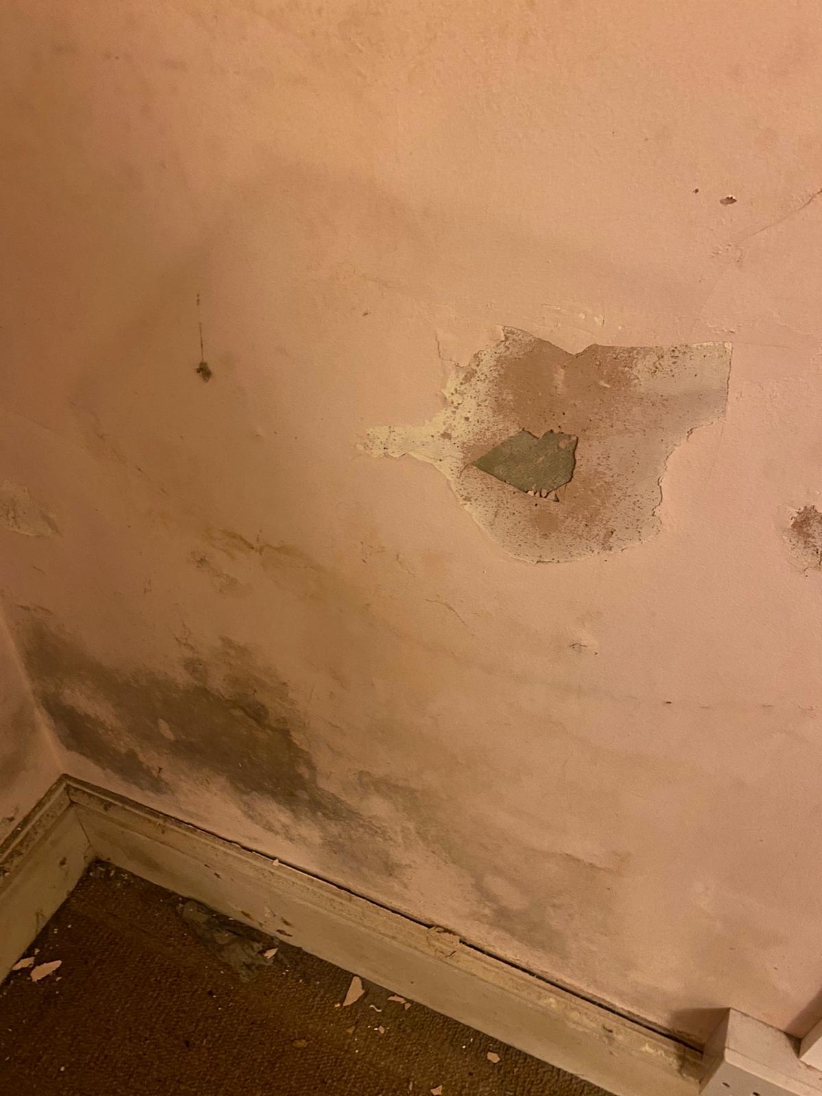

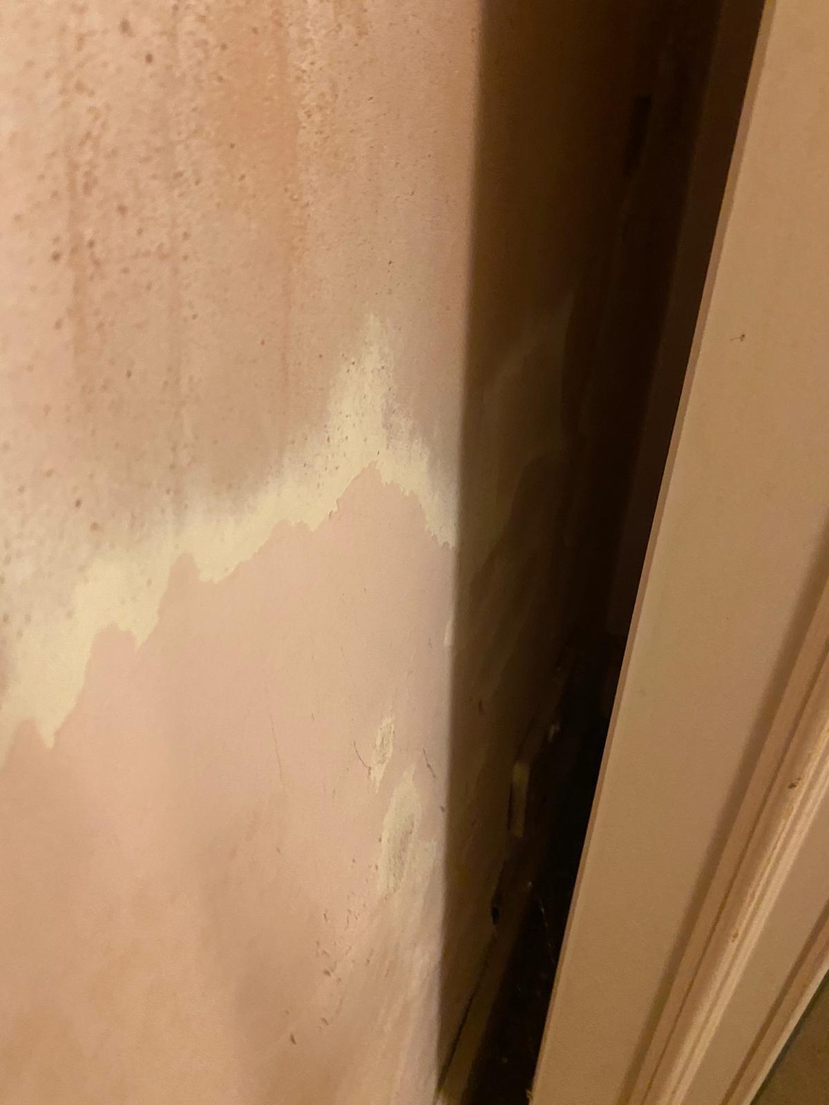

Damp issue in Victorian basement flat - please help!

I'd much rather get advice from people who have experience dealing with the issues themselves rather than trying to push me to spend money on treatments which may not be effective!

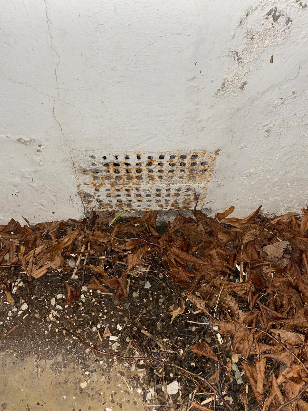

Not quite. The front elevation is sunk into the ground, but the rear elevation is level with the garden.

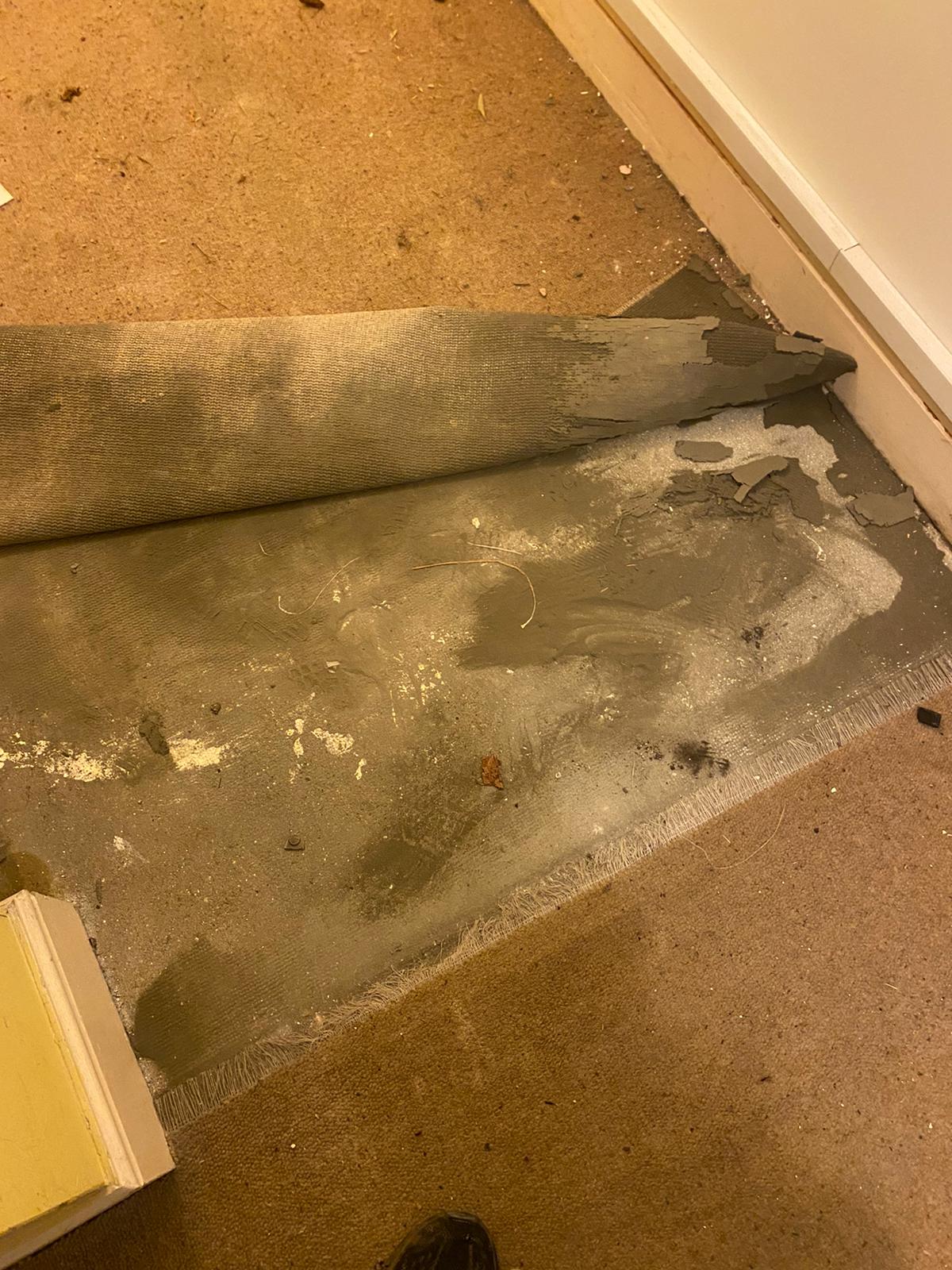

well to start with you have 2x issues, the level of the ground outside, and the concrete base.
if there is damp on the party wall might be worth asking the neighbours if they are suffering from damp issues.
Yes I think we'll be introducing ourselves straight away to see if they have any issues there.
So what do you think is the issue with the concrete base? is it the fact that it's too high and bridging the DPC or that it might not have a DMP.
Thanks for your help on this by the way
As Benny said basically.
But Its also highly possible that the concrete floor hasn't been laid correctly either
