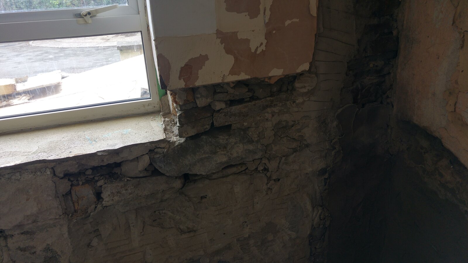

The meter gap I mentioned is between the outside rock wall which is almost always damp and the back wall of the kitchen.
I found a pic of the kitchen wall as it was being built. Id forgotten there was any insulation there. The gap where the insulation is isnt more than a couple centimeters thick.
I was told the walls are made of stone (from the rock behind the house) and plaster.
Seems you have stone house, I'm guessing exterior walls are stone, possibly some interior walls are brick?
Do your neighbours have same issues? I see another stone house through the window.
Is the fake wall you mentioned (musty smell) the one with the plasterboard and insulation on as the photo?
