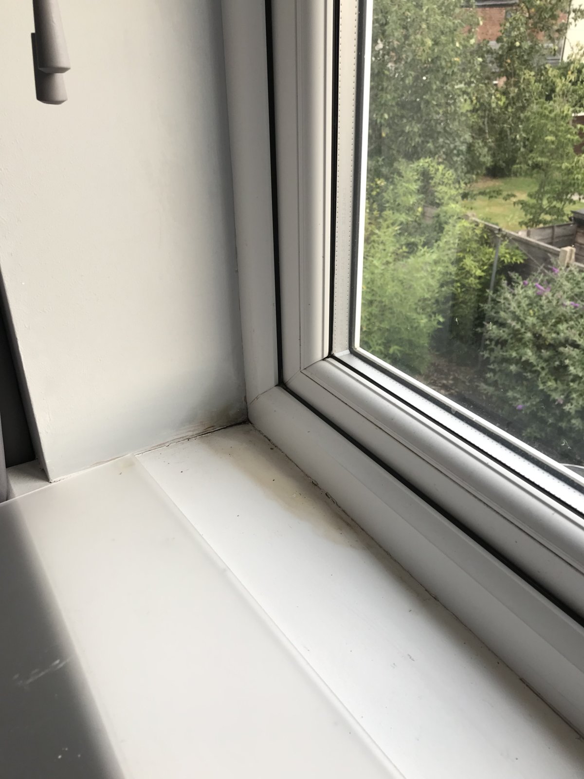

good morning
Looking for some advice if possible please. My double bedroom has double glazing same in all rooms. Do not have any issues other places just this corner. I have checked with the previous owner who was a builder who suggested the seal from outside could have shrunk in, however cannot see evidence of this.
Can anyone offer any advice in who I can call upon to get this looked at and resolved please.
Help is appreciated
Cheers
I would say condensation caused by cold bridging, or the window wasn't sealed to the cill as it was being fitted allowing driven rain to get between the cill and window then tracking sideways, it wouldn't explain the water pooling on the cill but would certainly show up as damp on the plaster, however maybe enough damp could cause pooling water, difficult one, being an upstairs window and very unlikely you'll want to take the complete frame out and seal the window to the sill I would chop away the wet plaster and se if you can silicone seal the end of the window/cill to divert the water forward. You could then fill the void/cavity with expanding foam which is waterproof itself, once dry trim it back and polyfiller over the top and theres your cold bridge sorted as well
Thanks for the advice, appreciated.
I have found that water is not pooling and there does not seem to be any moisture inside, just the stain. I always leave that window open at a crack.
Is it possible that it could need sealed from the outside?
Condensation would not soak in thru the paintwork, it looks like penetrating moisture at the window board which would have not been sealed allowing moisture to enter thru its edge.Rakeout seal outside and re-instate. Think the builder advice was spot on.
Awesome I’ll give that a go!
Would a glazier do this for me? I’ve not got the right tools or a long enough thing ladder.
