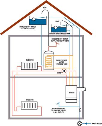

Fron the diagram it would appear that there are meant to be roof vents above the water tanks, which there isn't on my house. Do I need to get these installed?
The vent refers to the open ended pipe that is bent over the top of the tanks. They allow for expansion of water in the system as it heats up and also the escape of air.
