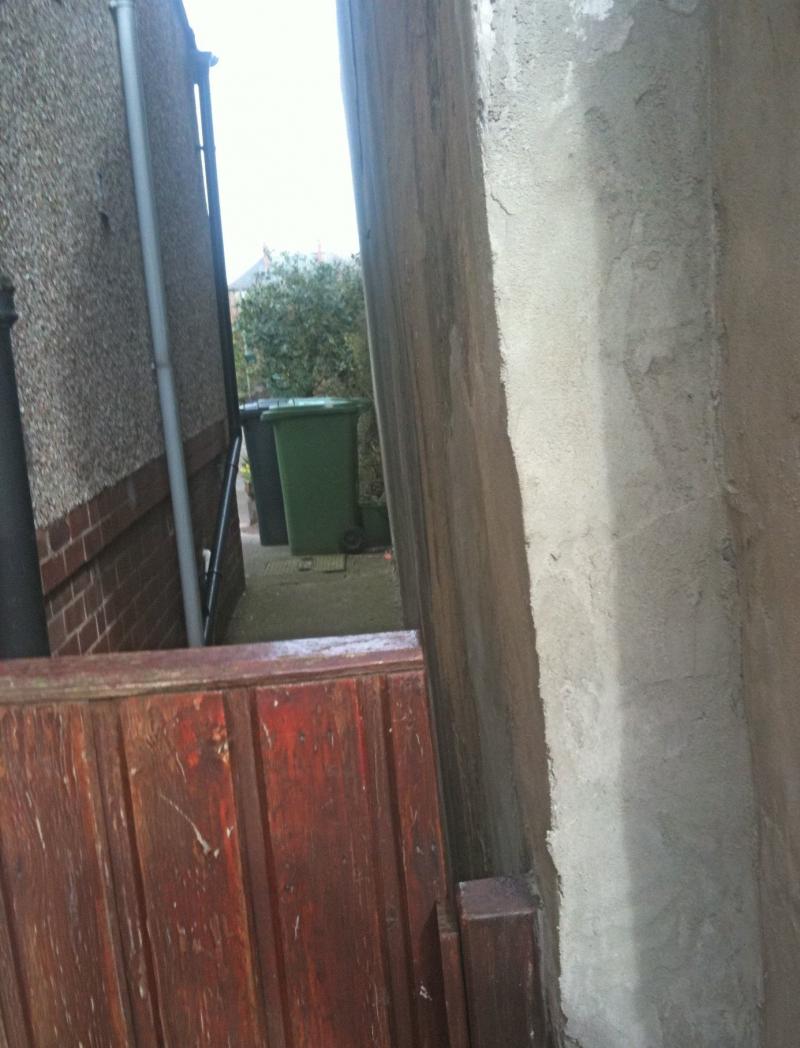

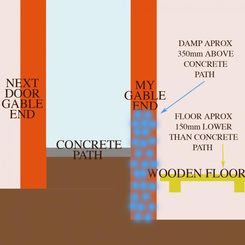

Hi, I have bought a small semi-detached cottage that I am busy renovating (total DIY amature by the way), which has a problem with damp on it’s gable end. The front and back walls are cavity brick, but the problem gable end wall is just a solid brick wall with no cavity. It seems like the damp problem has been a long on going thing with this wall as it looks like the previous owners had tried various things to remedy it. Such as chipping off the bottom meter of the origional plaster work and running some kind of render internally along the room with about a meter return on the adjoining walls. I don’t think this worked though as I remember the wall paper was in a bad state in these areas before I removed it. I think a lot of the water is run off from next doors concrete path which runs along side my house and is aprox 150mm above my suspended wood floor level. The concrete path in question dosent have anywhere to run off aprt from my and next doors walls and always looks a bit damp and mossy. I tried to add some pics of the wall etc but I can't seem to figure out how to up load them???
Sounds nasty. I wonder how long the path has been at that level? Does it slope towards your house or your neighbours? You'd hope the path would be 150mm below your damp course, which would be 150mm below your floor level. Could your neighbour drop the path by 450mm? :LOL:

My dodgey diagram of the wall and next door path:

A not so good photo of the path and alleyway:
[/url][/img]

No their floor is above mine and the path. I've been told that my cottage and the one that's attached to mine were amongst the first dwellings in the village, built for dairy worker families. The other houses in the street came quite a bit later on and it appears the one next door to me was built a foot or two higher, the street is on a slight slope.

A big problem with damp bricks is the risk of spalling (frost damage). I'd check the condition of your bricks above your neighbour's path. Ventilation to dry the bricks from the inside can be important in protecting them from damage.
When you get a heavy downpour, check to see if water is running/standing against your bricks. You'll still have a problem of splashing wetting the bottom 2 courses.
If the concrete path is made with ordinary Portland cement, it could prevent water from getting into the subsoil. Old lime concrete will let water through.
Cheers for the info ajrobb I'll have a sneaky peak next time it chucks down, shouldn't have to wait to long knowing the great British weather! I'll also try and measure up properly where the path level is up to internally on my wall and see if the dampness is worse above or bellow it etc.
I was just wondering the other day would a little drainage channel running along side my house on the path help? Its quite likely next door wouldn't be to up for me putting this in the side of their path though I suppose!
