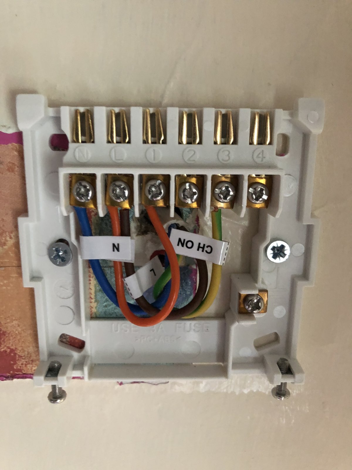

Hi I wonder if anyone can help. I have just purchased a Hive heating kit for the Central heating (Combi boiler) and it looked pretty simple but now as I come to install it I’m a little unsure.
I have attached a picture bellow
L. L
N. N
1. Live (linked from 1)
2. Empty
3. Empty
4. I guess it’s CH On ?
Can anyone please confirm
Hive
N. N
L. L
1. Live?
2. Empty
3. (Number 4 CH On)
4. Empty
Could anyone please help?
Assuming that you have the single channel version of the Hive for Combi boilers then it's a straight exchange of the wiring as it is, except that the green / yellow wire goes into terminal 3 instead of 4.
So:
Brown wire in Hive L
Blue wire in Hive N
Green /yellow wire in Hive 3 (Htg on)
Link between Hive L and Hive 1 (Com)
BTW It's bad practice to use a green / yellow earth wire as a live conductor which has been done in this instance. It should at least have a brown sleeve on it to identify it as a live.

Thank you for your reply. I’ll have a fiddle over the weekend :-).
Fitted! Thank you for your help Stem. Have a great weekend.

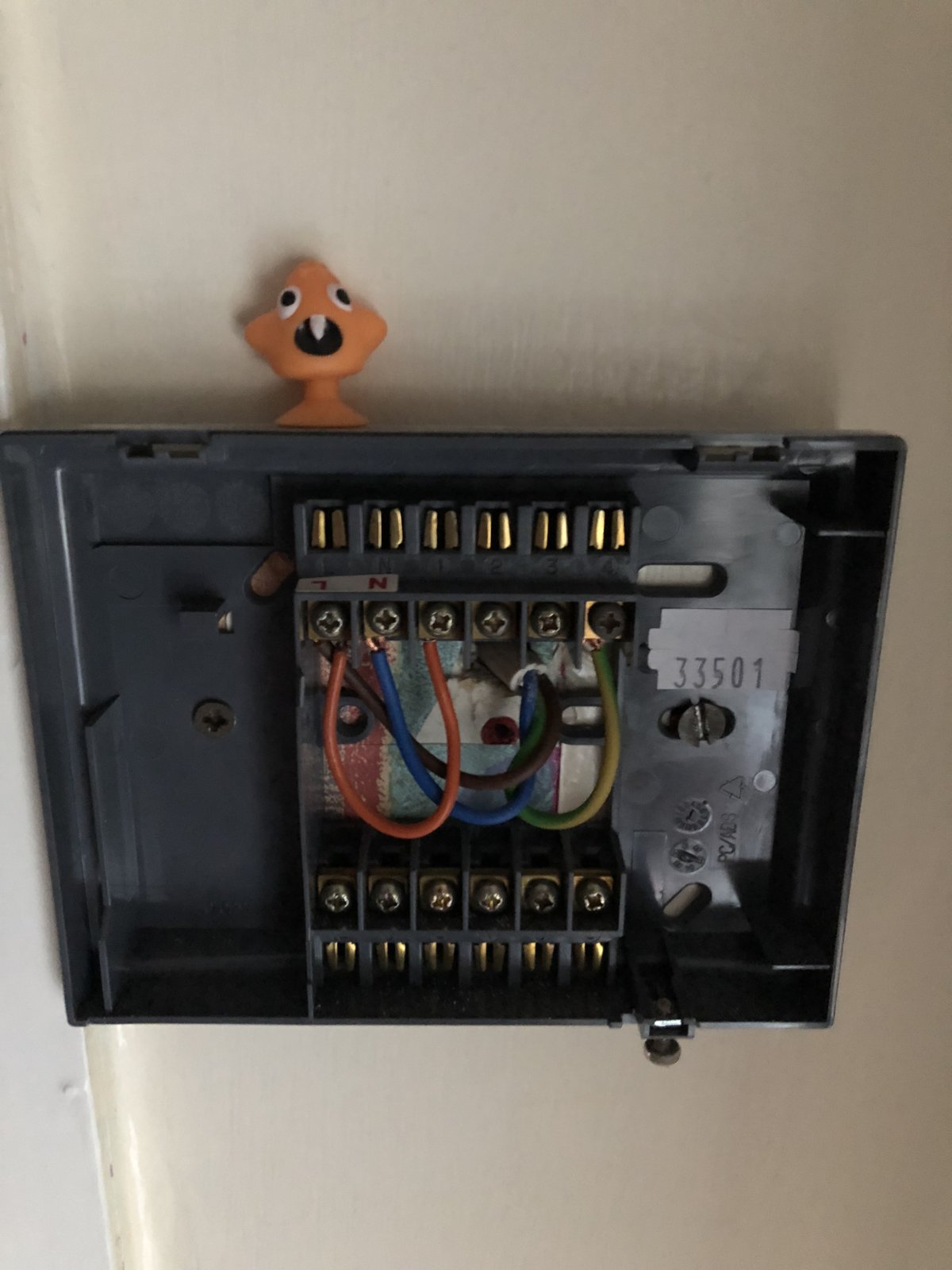

Sorry John, of course you were :-)... Your advice was invaluable! Watching lots of YouTube video’s can get rather confusing and I saw contridicting diagrams of what my danfoss electric timer wiring was supposed to be. Anyway, I took pictures just in-cause and labelled the wires.
