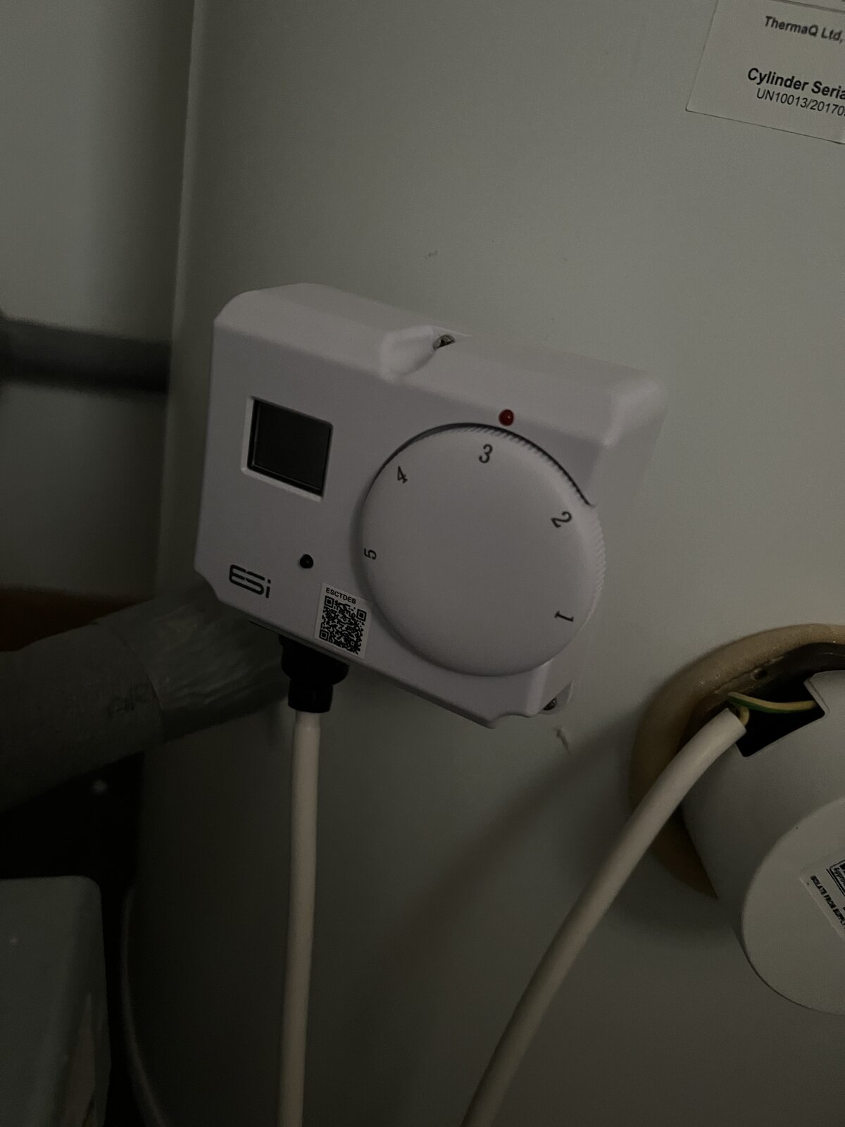

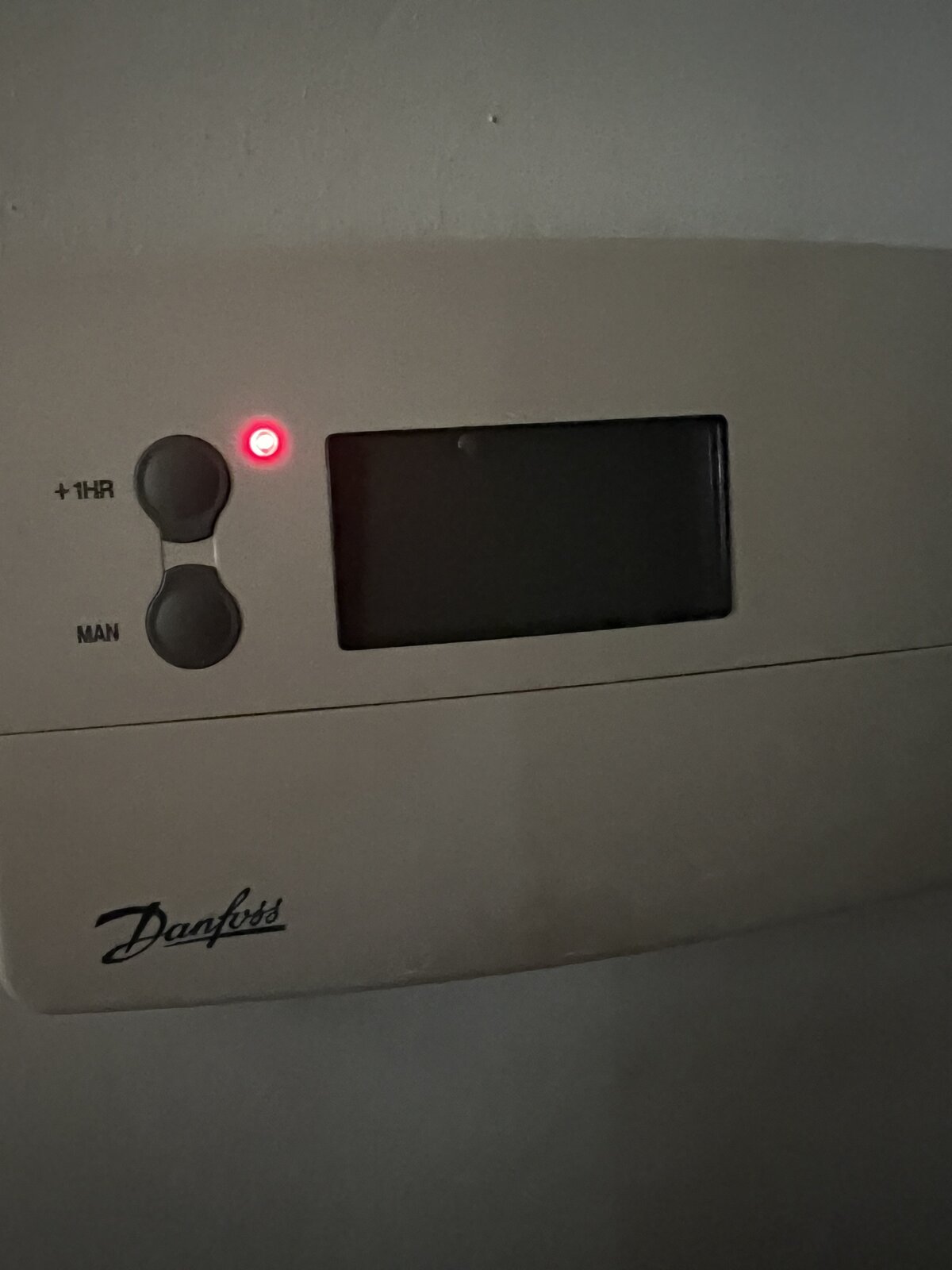

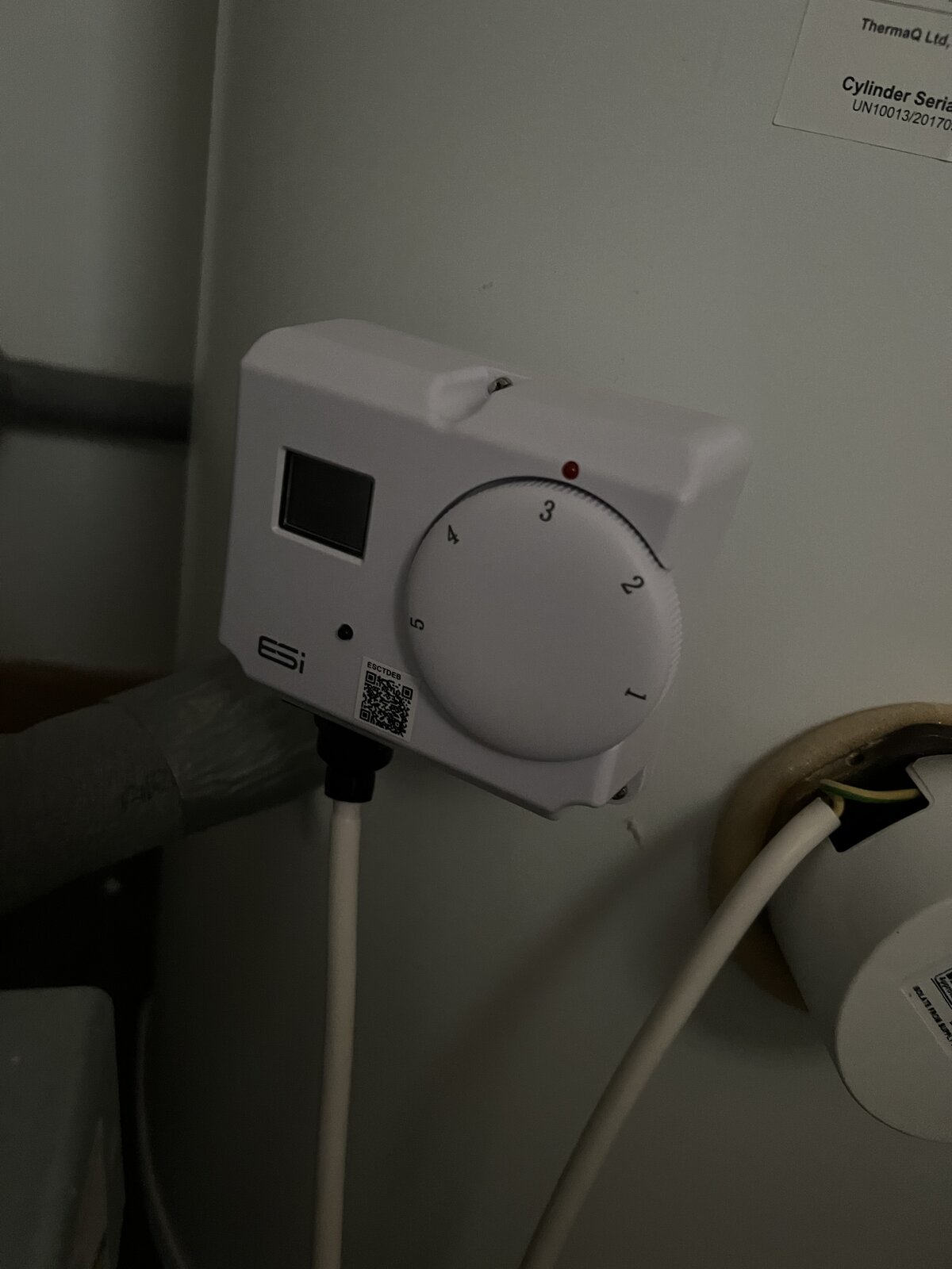

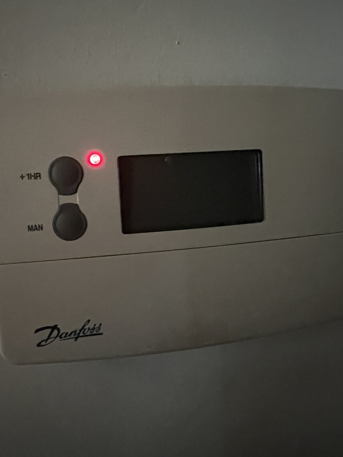

Hi there,
All of a sudden I have no hot water. My system is a Baxi Megaflow combo boiler with a Unicyl hot water tank. I have a Danfoss TS715SI panel with an ESI thermostat fitted to the tank.
I’m trying to get to the bottom of the issue, which I initially thought was the ESI thermostat, but having replaced that, it’s we still have not hot water. The ESI thermostat shows no digits or temperature on the lcd display, but neither does the Danfoss TS715SI. The red light is on on the Danfoss, however it’s jammed on and I can’t change any settings. I’ve enclosed pictures of both the Danfoss and ESI. Anyone see the route of the issue? Should the Danfoss be displaying on the lcd screen and not be blank?

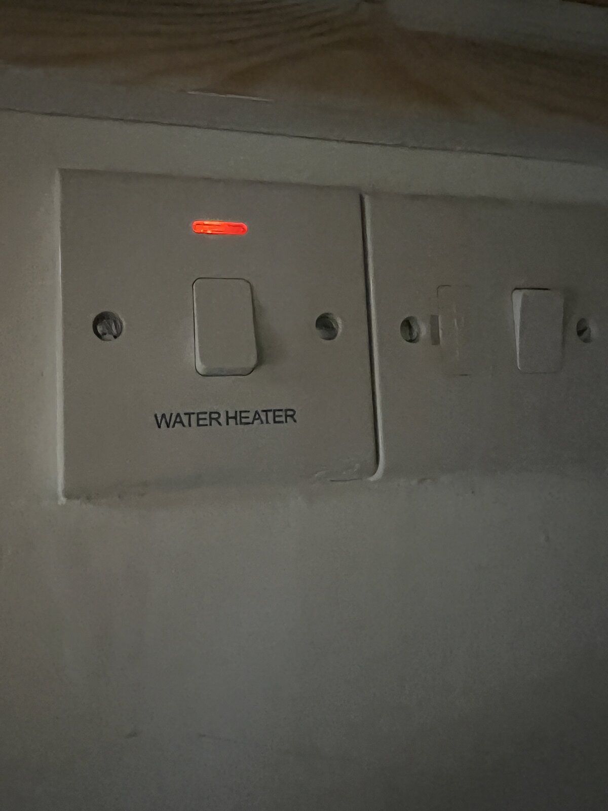

I’ve also enclosed a picture of the water heater switch which heats an element within the tank. I’m assuming that this switch should be off In general?

Yes the immersion switch is generally off, unless you want hot water electrically heated, but if you’ve no hot water I’d say it’s off anyway, could be wired wrong for the neon to be on. The danfoss - does definitely do the hot water? If yes, check the batteries, iirc most of those types do. Next port of call might be the motorised valve, but unsure why the cylinder thermostat isn’t lighting up, unless it’s via the switch live of the mv.

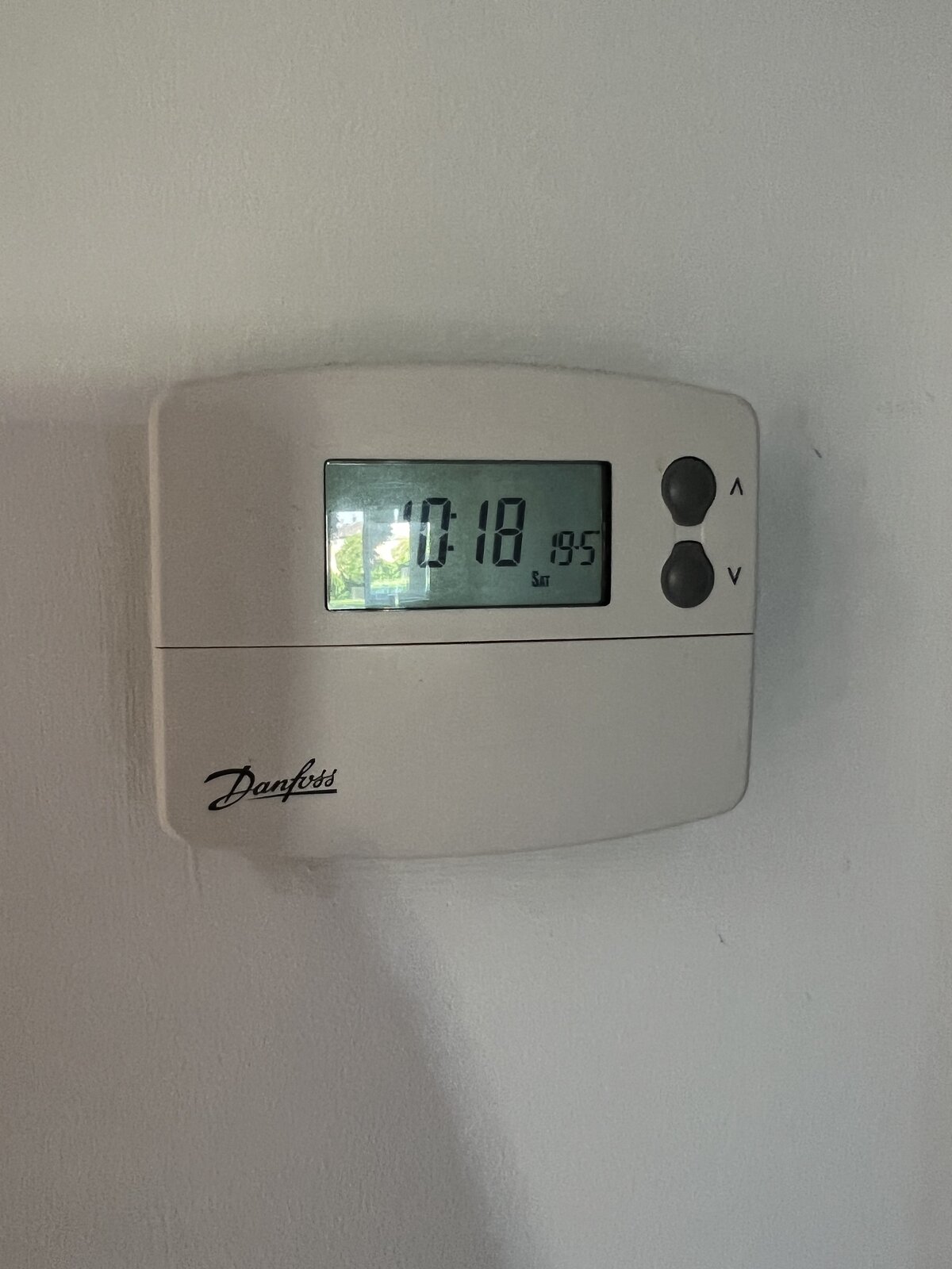

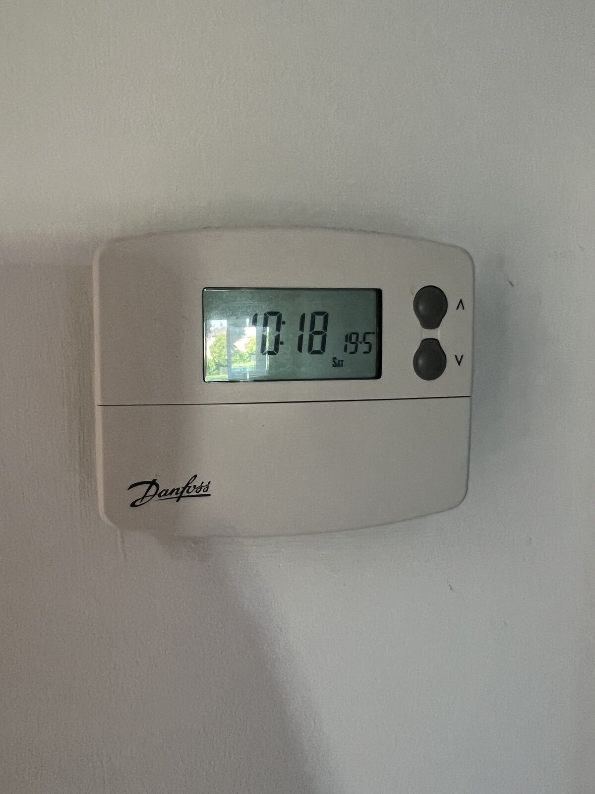

To be honest, I’m unsure if the Danfoss does hit water. Could that just be the main control point for these (pic enclosed). Still odd that the thermostat fitted to the water tank isn’t showing any signs of power.

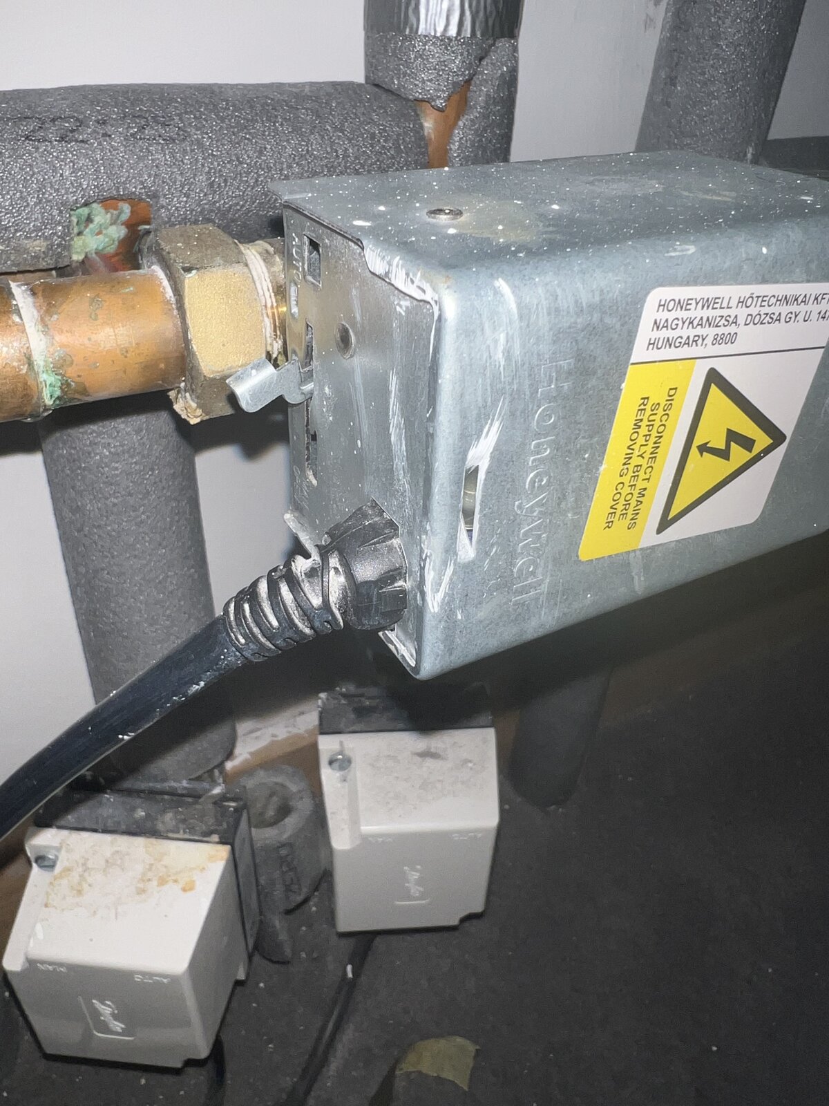

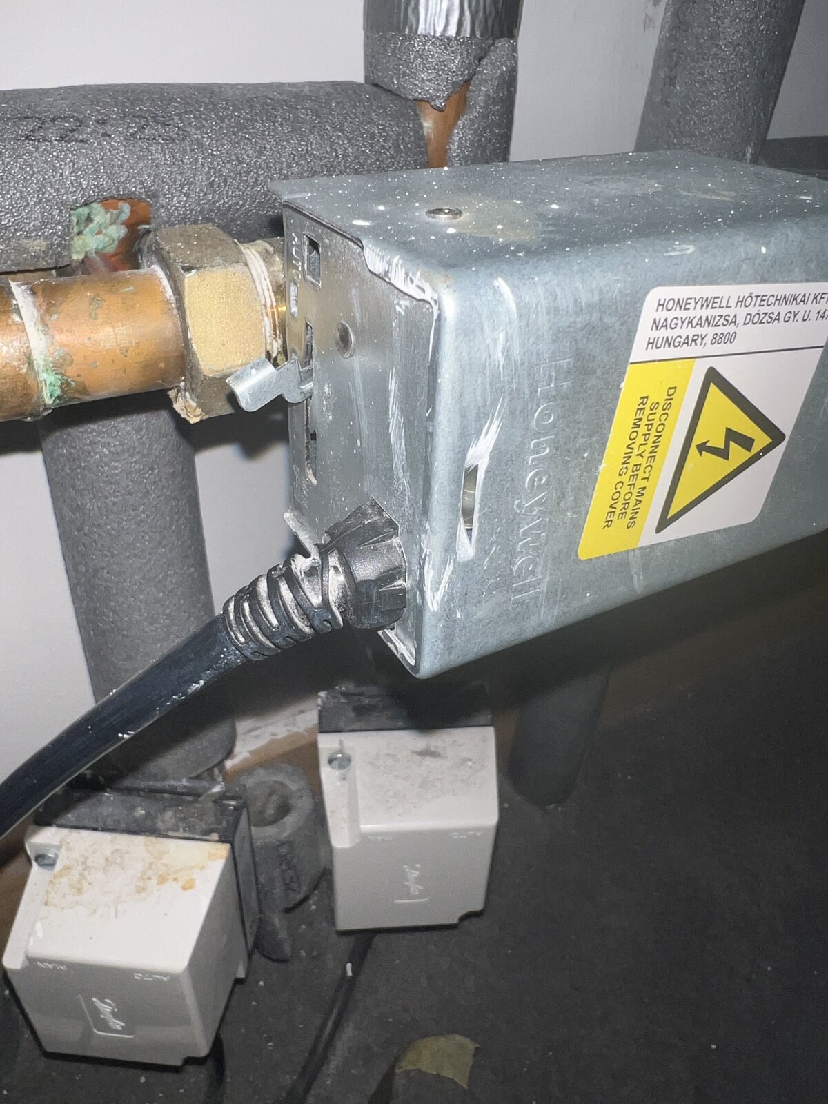

Is there any way to check if the motorised valve is working?
Here’s a photo of the valve. Looks like the wire going in is pulled downward - could be a loose connection?
The central heating is working fine. It’s only hot water that’s the issue. I’ve moved the switch to manual and jammed it on for the valve shown. Yes there are 2 valves that look different from this one below.
No don’t jam it open, see if it’s loose at all. If not, then the microswitch might not be making.
