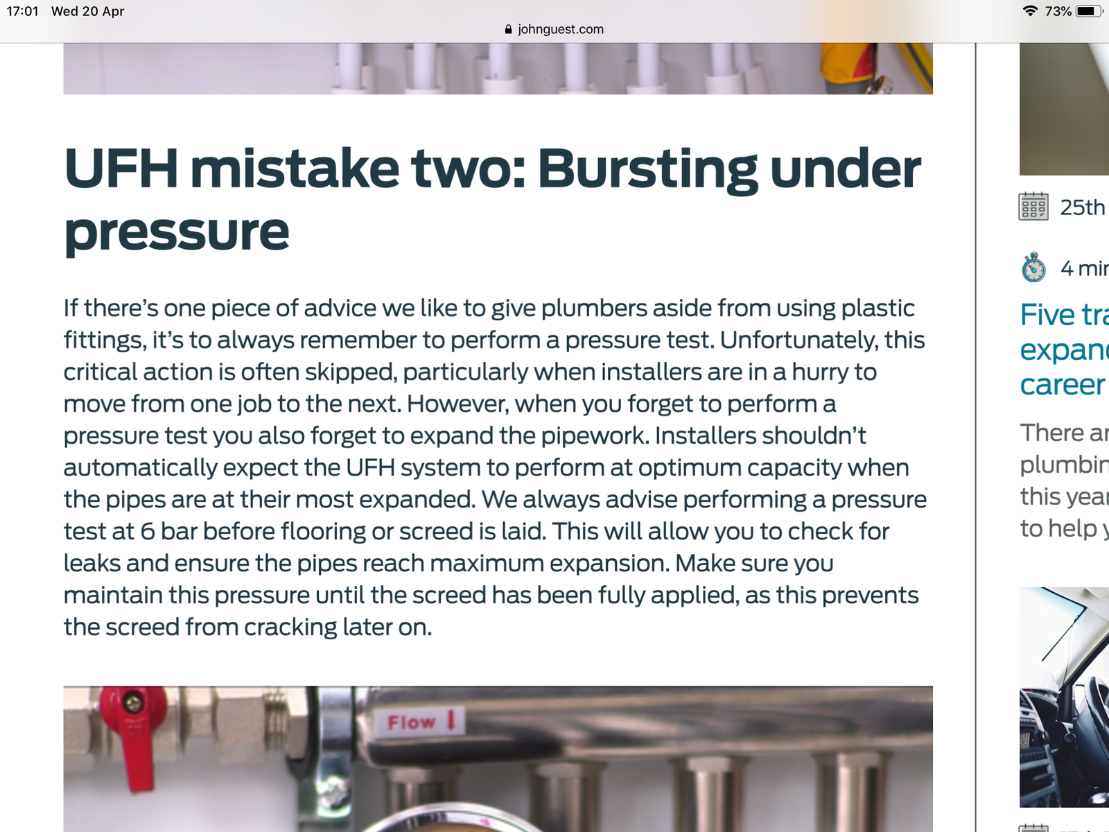

I was going to cap ufh pipes as I wasn't going to connect it straight away.
From the research I did, the advise was to pressurise the pipes before laying the slab to test for leaks and to leave it pressurised while the cement cured so I fitted a manifold and isolation valves.
Agree, although just filling with water and making sure it is sealed and there are no air pockets should do the trick, it wouldn't have to be pressurised.

Agree, although just filling with water and making sure it is sealed and there are no air pockets should do the trick, it wouldn't have to be pressurised.?
https://www.johnguest.com/gb/en/res...derfloor-heating-mistakes-during-installation

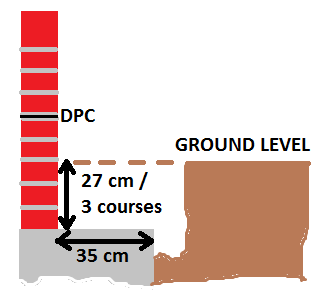

OK an update. I finally had the time to carry out a little survey.
  • I drilled a hole vertically down into the floor somewhere in the middle of the building, far from any walls. The drill bit broke through the concrete at around 20 cm deep (the point at which there was no resistance).
  • I repeated this next to one of the exterior walls where a raft should be thicker. Same result.
  • I then dug a small trench near the wall outside to inspect the edge of the foundation, the sketch shows a cross section of what I observed. I don't know how deep the concrete pad goes.
I now reasonably confident that these are normal strip foundations (or at least, not a raft). Any thoughts?

Yep...those sound like strip foundations, your internal floor is above the foundations as its 200mm thick, which is a standard floor,150mm concrete, 50mm screed. Ie The internal floor starts above the foundation top level, they are not connected.
