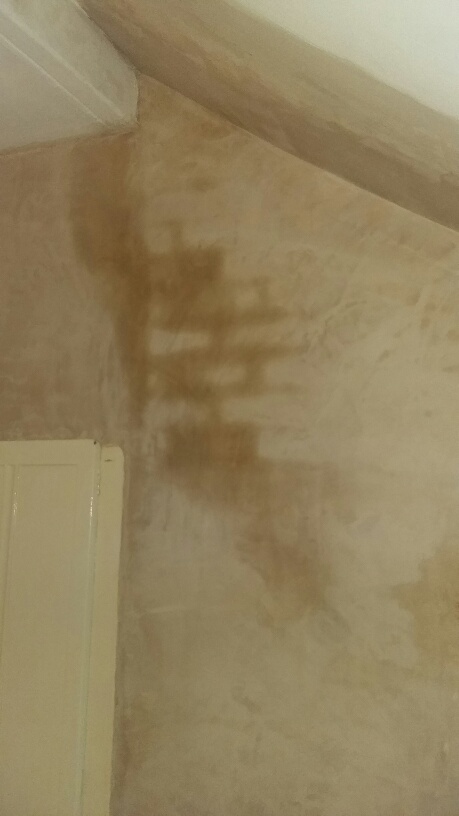

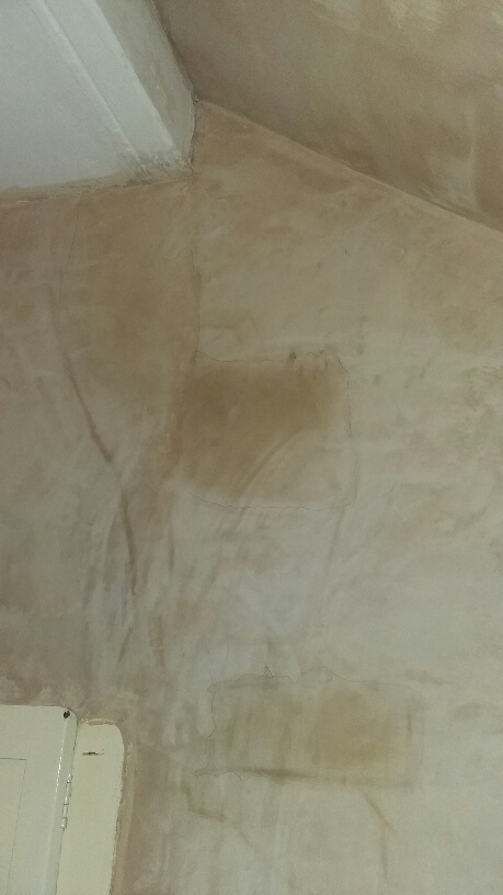

Hello,
I have had an on going problem with darks marks that won't seem to go away. These marks are not wet, greasy or even colder than the rest of the wall, you can simply just see them. They were improving and going away but have recently appeared again (Not after rain, just generally cold weather). The never grow or change in size or appear any darker than they originally did but they have just reappeared in the same place. The area underneath and to the left of the beam is plasterboard, to the right is the chimney breast.
We have had various work completed.
:-This started off with having the wall taken back to brick with a salt neutralizer adding to the brick and left to dry overnight. A plaster coat applying to the area that was stripped back to brick and then a skim coat applying to the chimney wall and plasterboard area connected to the chimney wall.
:- We have had the chimney repointed, chimney cowl checked and confirmed there is no problems, lead flashings and underfelt completely redone around the chimney. This appeared to solve the problem but it has shown again in the exact same place. (I have had 5 separate roofers check the work who have all said how well the work has been completed and they can't see any problems.)
Does anyone have any idea what this could be? (a leak still, condensation, salts somehow still (Despite the salt neutralizer).
Any advice or even guesses would be appreciated.
Please see below pictures.
Original - 2 weeks later - 3 weeks later - 4 weeks later - 4 and a half weeks later

Is it an outside wall? Is it solid? What undercoat was used? Are you sure it's not wet? As the bricks are ghosting and the plasterboard right next to it looks wet how long ago was it plastered?
I am no expert, but had a few problems with unused chimneys before. If I read your post correclty, you got the wall replastered before the chimney was repointed and the flashing redressed? If so, between the jobs the new plaster could have soaked up moisture and along with it soot and perhaps salts from the chimney, which might show now. I think a SBR slurry followed by a sand and cement scratch coat ahead of applying plaster would have been better in stopping soot and salts oozing from the chimney. That's at least what seems to have remedied the problem we had (and I used a "renovating plaster" that was lime based).

Given the information we have to work with, the most likely possibilities are in the first pic: its a back gutter problem and/or a non-vented flue(s) problem.
As for the 5 roofers business: what next - six Geese a-laying?
Thanks for the replies everyone.
Just to explain a bit more, the first picture is before the repair work on the roof and then subsequent ones are after the roof repairs. We don't want to use any waterproofing product as we have been advised against this due to the age of the property (Solid wall house built in approximately 1900).

The ghosting that appears on the first picture is before the chimney/roof repair work. I'm not sure what undercoat was used and I can't be sure there isn't still a leak, I am going by touch/feel and it doesn't feel any different to other parts of the same wall. It feels very cold but completely dry but this isn't surprising I don't think as it's the only external wall in the room.

Hack off back to brick as suggested above and also remove any damp stained plasterboard. But dont yet take any remedial measures.
Open up all blocked off fireplaces and sweep the flues - when covering a fireplace opening a vent must be inserted, and an appropriate ventilation terminal inserted in the chimney pot.
What do you intend to do about examining the back gutter - nowadays, many roofers will take pics of the stack before & after any work.
Pics are best for any post-mortems.
Close up pics of the back gutter & stack would help.
