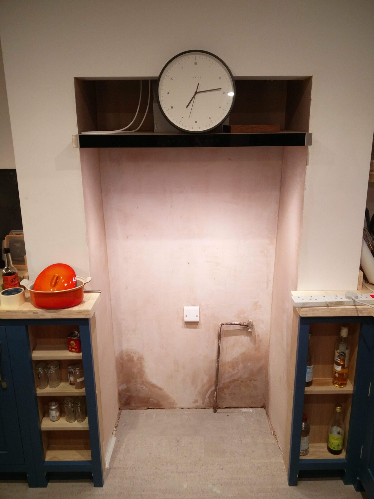

Here is a photo of the whole chimney breast.

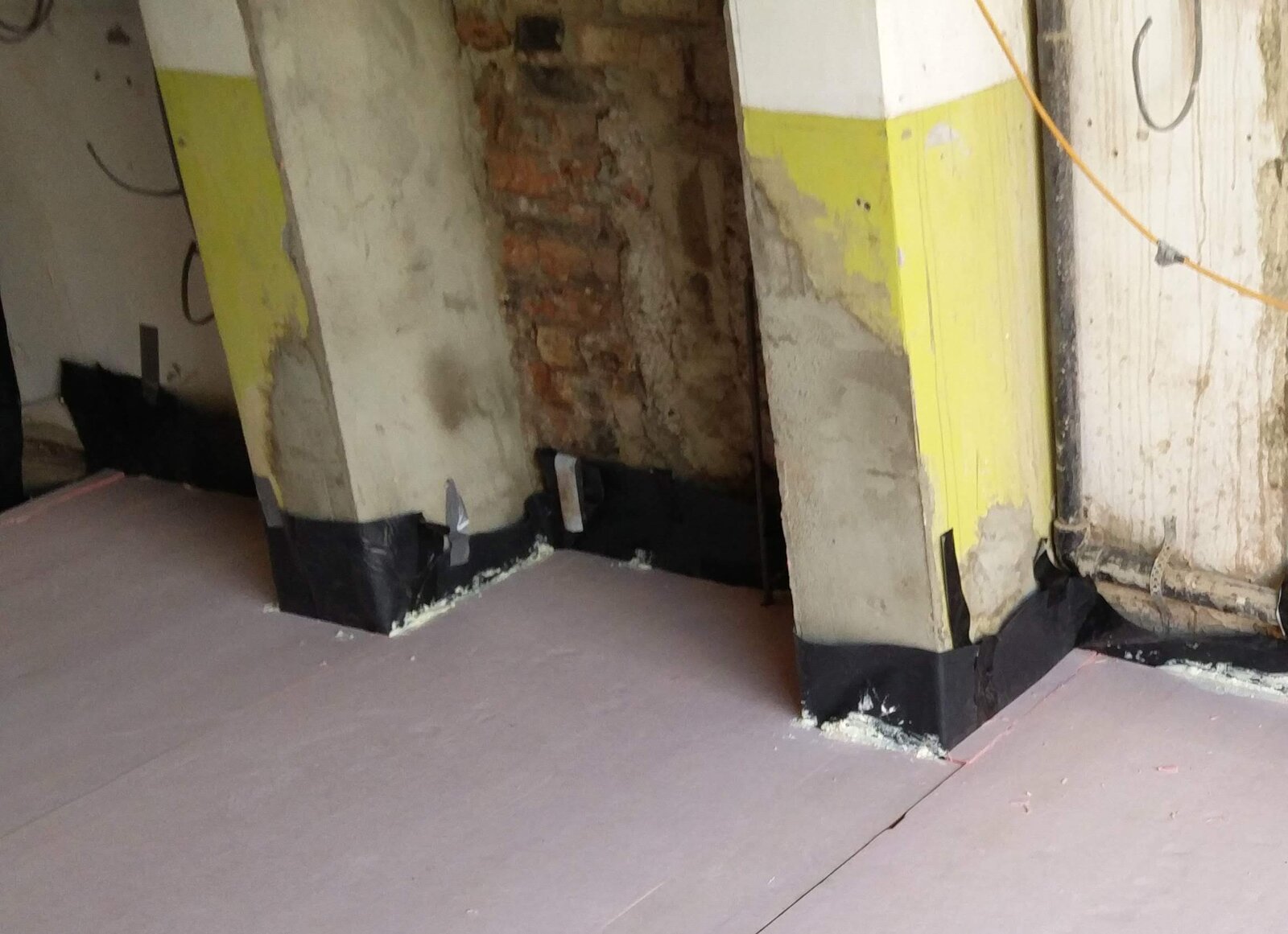

I've tried to find some earlier photos of the chimney whilst the works were taking place but don't have many decent ones unfortunately. I've included a couple below for reference.
Regarding what is below the finished floor, there is a 50mm thick concrete screed slab which had a damp proof membrane installed prior to being poured (see above photo). Below the concrete slab for the rest of the floor is a suspended beam and block floor, but inside the chimney breast my builder just threw down a bit of concrete to bring the level up to the same as the top of the beam and block. From memory, there were concrete blocks below this.
On the above photos you can see where my builder rendered on the sides of the chimney breast with a sand cement mix. The plasterer applied a bonding coat to the back prior to a skim coat. Does this bonding coat need to be removed up to where the damp is occurring?
chop the back off . inject a chemical dpc cream in the lowest mortar bed , tank the wall then render with sand cement with sbr.
cant for the life understand why a builder would render the sides and not the back.
bonding coat is totally the wrong option.

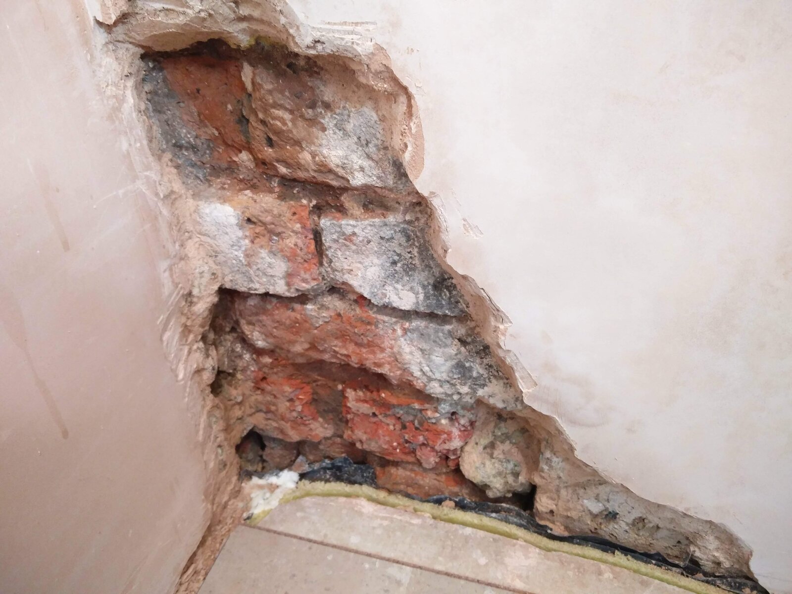

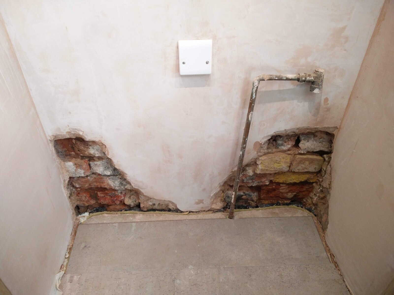

So I've just chopped off the plaster and bonding back to the brickwork where it is damp. See photos below.
you need to take it off 1 mtr up from the floor and chip and wire brush off the plaster on the sides up to 1 mtr also.
inject a dpc cream into the lowest mortar bed. then fill all the loose brickwork and missing pointing in with sand and cement . tank the back wall and sides , render the back wall with sbr in your mix and skim it all in.
