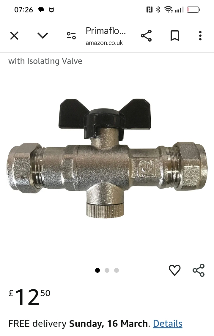

Instead of putting separate isolation and double check valve?
Normally they are usually used for filling loops, rather than on a pipework feeding outlets but can't see any reason why not, as long as they are WRAS.
