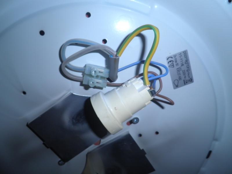

I have had to remove a ceiling light and am wondering what to do with the wires supplying the light.
Am planning on re-installing another light, or possibly set of downlighters (possibly LEDs) - not sure exactly what yet, as this won't be happening for a while. Also have to get the ceiling re-plastered.

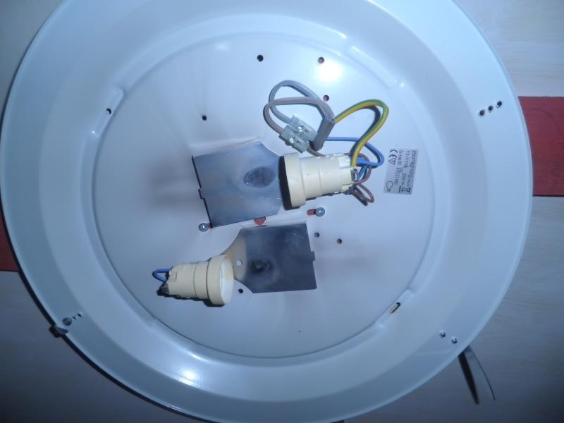

I'd like to know the correct way to temporarily make these wires safe. I have taken a photo of the fitting to show where each of the wires went, and now want to remove the fitting itself. Would leaving the wires in the (white opaque) connector strip be OK? OR should something else be done?
I'd be very grateful for any directions here..!

Looks like you'd have to cut the connector away - only the incoming wires have a screw terminal, and that would make the old light less useful if it should ever be needed again.
But a 3-way piece of strip in a choc-box
will be fine.
And even though you are absolutely sure that you cannot possibly ever forget where the light is, and where the cables are, before it's all plastered over and concealed, take photos and make measurements, just in case you do. :wink:

After having removed the fitting, the only wires protruding from the ceiling are the three: exposed earth wire (with green/yellow sleeve), brown and blue.
I presume this means this light is not part of a radial circuit, so can't be connected in the same way as those choc box examples.
This room has some wall lights (controlled by separate switch) which will be sufficient for the space while work is being done, so if I can make this ceiling light cable safe for this period (al least next few weeks), all will be well.
**EDIT: I've just found the junction box under the floorboards above - and located this cable. So should be possible to simply remove it from there, being careful to avoid disrupting any other connections inside. Will make sure I take photos of before and after, just in case...
