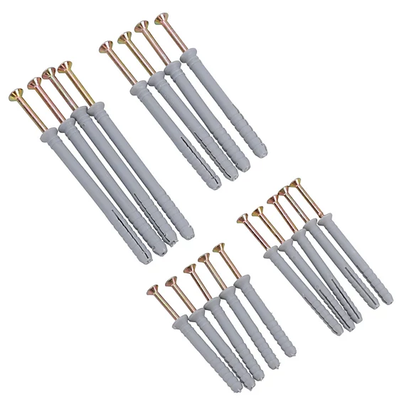

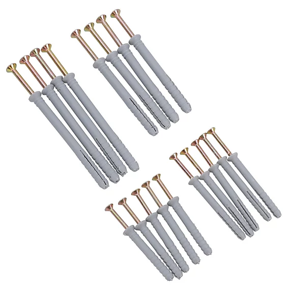

Tube columns? You want bolts all the way though into the breeze block. Is the block med/high density? If so then just use wall/masonry bolts with plugs - say M8 x 80mm similar to these but with a hex head
