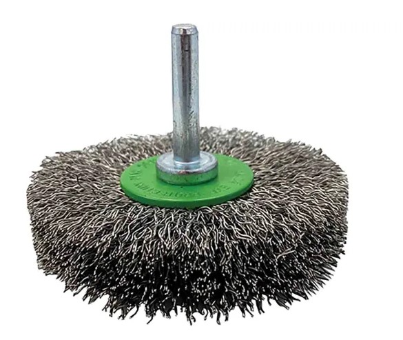

I put a large 2 level decking project in the garden, teated ut each year by decking cleaner scrub & when fully dry reoiling with decking oil.
got to the point now that many of the small grooves are full of caked oil & crud.
Need to remove it .... don't want to pressure wash as it will lift the grain, need something like a rotary wire brush as in pic ... but plastic .... would dig out crud without harming the wood - anybody aware of one, or a better method

That or any wire brush will do far more damage than a jet wash.
A 3M type scouring pad grey (course) or red (medium) would be better if you are intent on scrubbing.
Or one of those painter's hook tools or similar tool for weeding paving joints.
I used to believe that jet washing was bad for decks, but not now. Well, not for older decks that already have some wear. Jet it, let it settle for a week or so then re-oil.
