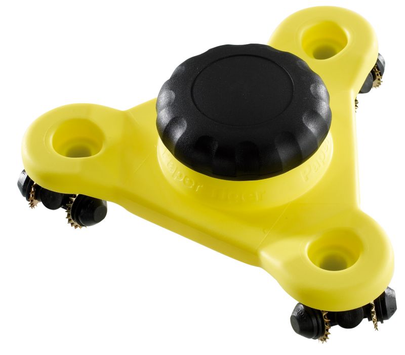

Cheapest DIY alternative is to purchase a Steam Wallpaper stripper
these are about £25 from DIY merchants, plus a wallpaper scorer which will make holes in the existing wallpaper and with the steam and a bit of scraping will remove the wall covering.
Fill and make good, apply a "blinding" coat of emulsion, size, and cross line with a good quality lining paper, then either Emulsion or wallpaper.

Instead of a steam stripper get a sprayer and use warm water and some fabric conditioner once you have gone over it all with a scraper and pulled off whatever you can to allow the water to penetrate better.
Steam can easily result in damaging the plaster, and a tiger (wallpaper piercing tool) can too if used too hard.
Conditioner helps the water 'grip' onto the wall for longer so helping it penetrate better - you only need a tiny bit.
