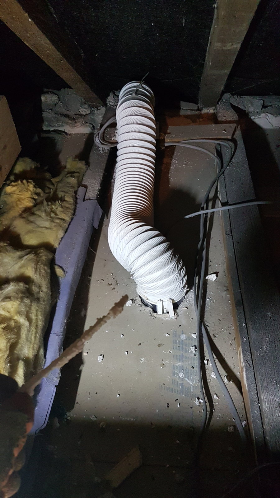

Can anyone tell me what this is, it's attached to some ducting in the loft that's to the bathroom extractor fan.
Looks like a mouse found it tasty at some point?
Oh ok, I figured the fan was mounted in the ceiling. Must be just a downlight then, I thought it was a fan with a downlight in it??
Ok thanks.

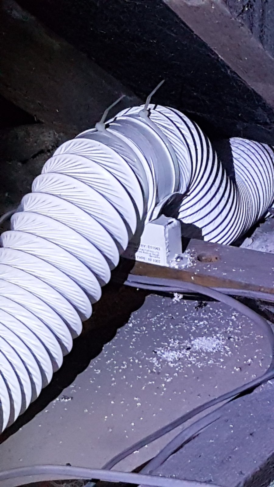

One more thing, whoever installed it, they have the ducting venting out through the eaves, in-between two rafters. Is this normal?
Yes, as long as the duct vents properly to the outside. The duct should also be insulated to stop condensation on the inside, this often then runs down the motor wires and damages the timer circuit board for the fan. These are cheap fan kits, often with poor performance. The bit in the ceiling is just a vent grille with a lampholder in it. The sagging parts of the duct can also collect moisture.
Ok, thanks husky. I'll be removing this one anyway, it's directly above where a shower cubicle will be going.
Possibly, the light is directly above where the shower head will be, wasn't sure if it was ok or if the steam would be excessive. I'm not a fan of downlights anyway, so want to get rid regardless.
Pete
You could keep fan and pioes, and simply get rid of dowlight+grill bit and change to a grill only above shower (best location if you ask me).
