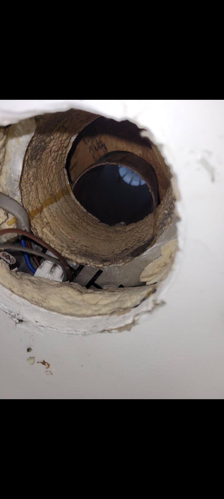

Hi all,
Hoping someone can provide some helping suggestions.
My extractor fan has stopped working, so removed to replace it.
Turns out that the extractor fan was never fully connected to the ducting. Nor properly lined up.
See images to give a better impression.
What I need is to connect to ducting down another 6-7 inches to join the fan.
As you can see from image the ducting coming down from the outside vent is not fully lined up with the fan and likely can't be ceiling joists.
Anyone able to suggest material/ducting I could use for this?
Thanks Tony.

I often used pan connectors and soil pipe as vent pipe. You can play with the stuff in DIY prior to buying.
What size is that duct
Chop the insulation and plasterboard so that you can fit the fan in line with the existing outlet; fill with expanding foam and plaster/filler.
(I can see the bare ends of a cable on the left; do you know what that is?)
Those cables are for the currently in place extractor fan.
I only uncovered this situation when the extractor fan stopped working (after 7 years). Called a British Gas Homecare electrician to replace the extractor unit and he uncovered the out of line ducting.
Refused to fit new one until ducting was fixed.
Yes. Pan connector and soil pipe fits the 100mm. A toilet waste at the back is 100mm. I've always found soil pipe brilliant for ducting. I know it says 110mm but the connection is 100mm.

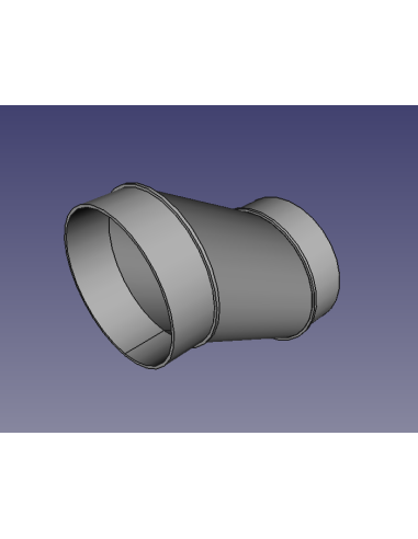

One of these
So push one end into the soil pipe? And attach the other end to the extractor fan?
I have about 7-8 inches between soil pipe and back of extractor fan
One of these
abit too long for 8"
try
