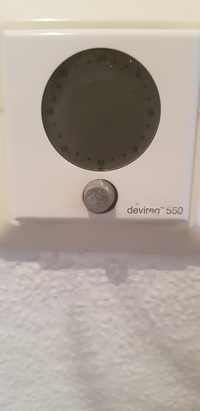

Hi, I have attached a pic of the display. Pressing the button it twisting either way does nothing. Haven't used it ever and it was installed in the bathroom about 10 years ago.
Your picture shows the stat with a display showing. Does this display disappear if you turn off the power?
What do you get when the power is restored?
Hi, it stays on whether the power is on or off. I'm not quite sure why though.
It’s printed on the screen then.
Do you have a voltage test device? Not a neon screwdriver!
Your next step is to check if mains voltage is actually getting to the stat. Have you checked the fuse?e
We thought we would put it on to see if it works. I remember the installers tested it when the fitted it at the time of the new bathroom so it did work.
I wasn't home last night so will check the fuse today.
