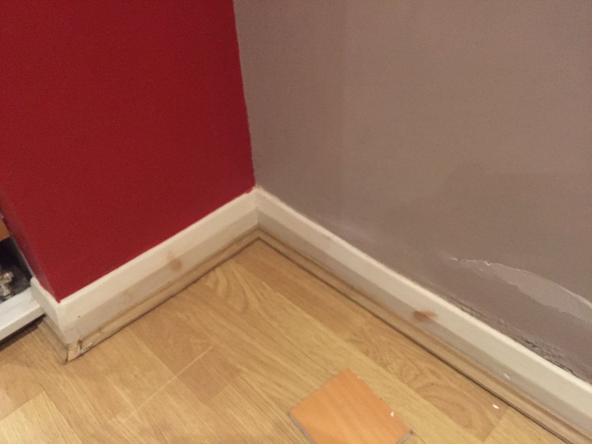

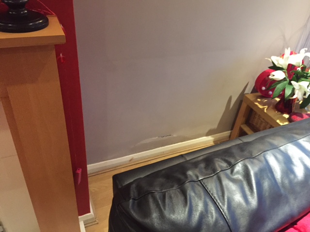

When I moved into my gaff (mid terrace, built 1966) in 2009 I noticed that the paster looked shot at the bottom of a wall next to the chimney breast, and was coming away a bit. (See pic below)
I didn't think too much of it, thought I'd deal with it at a later date, put an armchair (the black one in the pic) in front of it and forgot about it.

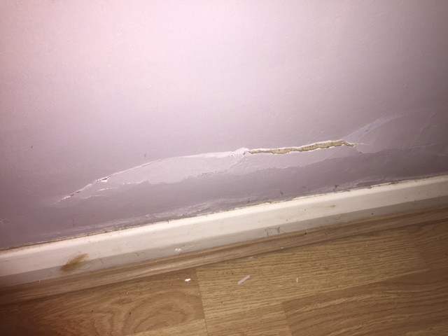

When I pulled the arm chair away this morning I noticed it has got worse over the time. It looks to me that the plaster is blown, but there's also 'bubbling' at the bottom bit directly above the skirting board.
We was flooded a bit (not very deep but water penetrated the walls) in 2012. The armchair is permanently in that place so does not allow much airflow.
The only thing that concerned me was that there is an unused gas fire to the left. It hasn't been used since we moved in and it switched off at the safety valve in the wood fire surround, but I just wondered (as a very long shot) that the gas pipe wouldn't be buried in this (solid) wall? Like chased in? and it was causing the damage to the wall?
This is on the far wall away from the kitchen (where the boiler is) the floor on ground level is concrete and I would have thought the gas pipe feeding the fire was buried in the concrete flooring? My only concern was that if the pipe was in the wall that it might have corroded and be causing these issues. There is no visible gas pipe in that room, and to the right of the picture is the front of the house, and the cavity wall, but I have no idea if there is a gas pipe in there)
I plan to pull the damaged plaster off (which smells 'musty' underneath, not 'of gas!') and let it dry out for a while, then treat and make good.

Looks to me like normal dampness.
Usually from faulty damp course or similar.
But what is on other side of the wall?

Thanks for the reply Tony. It's a party wall, so next door's kitchen.
Have you ever heard of gas pipes chased into party walls though Tony?
FFS Seeing as the plaster is already fooked and needs replacing. Carefully remove some of it and check !!
Could there be water leaking in the kitchen next door?
Gas pipes chased into walls don't cause that effect.

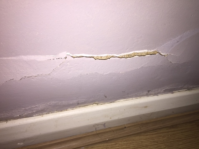

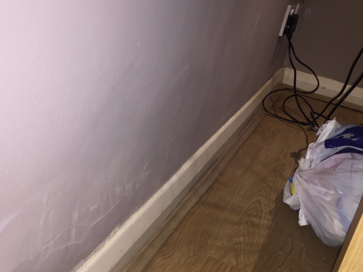

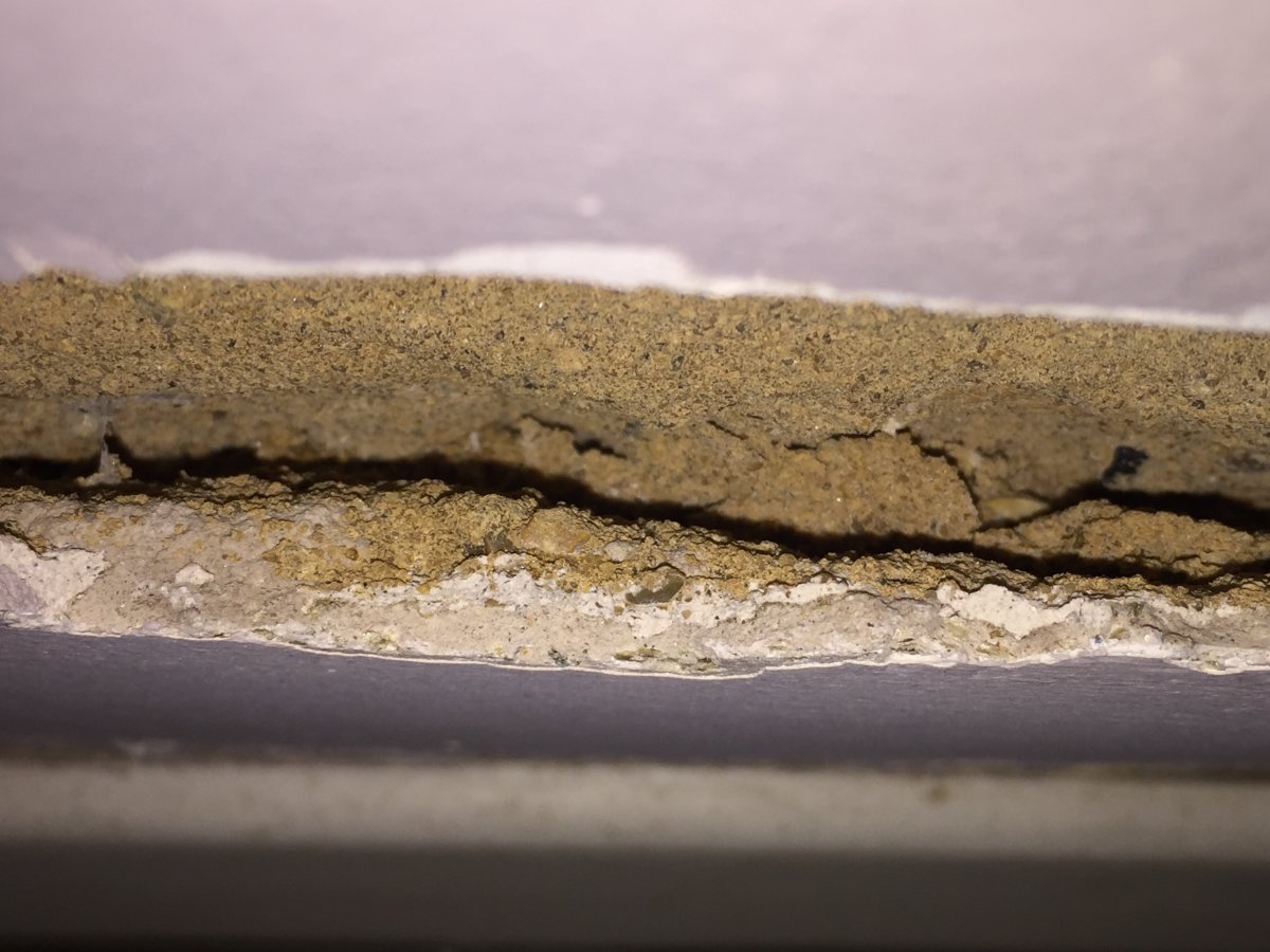

So, tonight I took a bit of the plaster away. This is looking down. You can see the skirting at the bottom. No smell of any gas - just very musty and damp smelling. It does not make the room smell damp though and never has - just this localised area. At no other area of the wall does it seem damp or problematic

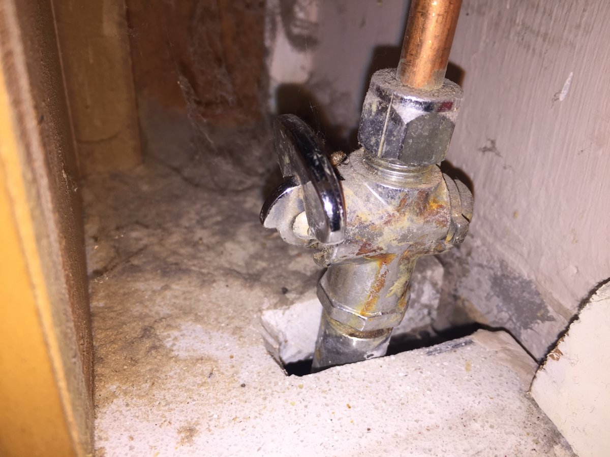

Below is the proximity to the chimney breast, which again does not show signs or feel of damp.You can see the gas switch off valve within the wood surround at the bottom
Below
The switch of valve, disabled.
Below:

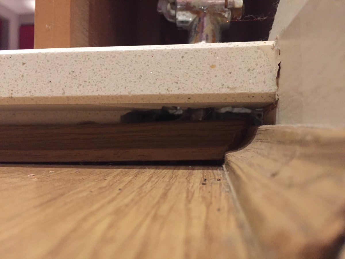

Looks like the pipe is going into the concrete floor rather than the wall. I'll pull out that laminate edging at the weekend to check direction

My only other observation was the construction materials of the wall - this is a 1966 built party wall. Looks unusual to me...No cracks or other issues throughout the house.
First off, determine whether the gas to the appliance is live (with gas in the pipe)? Or if the gas supply has been isolated closer to the meter?
Next take the perished plaster back to masonry up to 150mm from the floor - it would be an idea to also carefully ease off the skirting, and knock off some plaster from behind it.
Then post photos.
Doing the above would prove if a pipe is present, and should give some indication of any damp.
There's a shadow line about 1000mm above the floor indicating previous plastering/rendering?

I'd be wanting to know what is going on the other side of that wall to start with. Have they got a leak they are unaware of? Not impossible the gas pipe could be buried in the wall, first rule is never assume anything, but as you can see it going under the floor, I think its a fair assumption it runds underneath the floor and wont return upwards and along the wall.
Either way, no gas pipe is going to cause damp issues in a wall to my knowledge.
