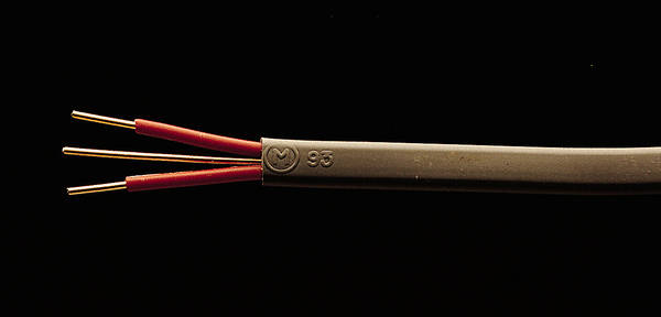

:( I am replacing a 2 gang light swich in the kitchen with a dimmer switch. When I opened the switch plate to replace it with the new one, I thought all I had to do was replace the existing wires into the new switch, but when I opened the switch thinking I would find 2 red wires and 2 black wires so I would know what was live and what was neutral, what I found was all 4 wires going into the switch was red, 2 into the top and 2 going into the bottom with a red wire connecting the bottom 2. I think the bottom connections must be the live do not want to do anything withouy advise. any comments on this would be helpfull. thanks in advance. jim bob
They are all live
Live feed and switch live. There are no neutrals connected to a switch or dimmer.
change it like for like, and yes there are no neutrals, also note my signature

As the others have said, the black at a light switch is switched live, not neutral.
Red/Red cable is sometimes used for switch drops in lighting circuits
Probably - but this is one of those instances which show that when working on electrics a multimeter is as essential as a screwdriver...
