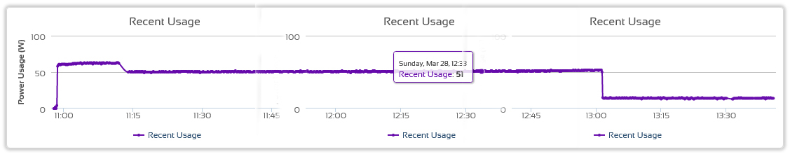

Car is a Jaguar XE, over pandemic hardly used, so on Sunday used for first time in months, and wife tells me there is a warning lamp saying the battery is discharged, the drive belt is OK and on putting on charge at returning home, using a energy meter supplying a smart charger so know battery took around 10 Ah, Used again Monday lamp still on, but the charger on return took seconds to switch down to very low rate 0.1 amp, less than would have been used if not charging, so it seems some how the car is reporting a low battery erroneously, so it seem likely some thing needs resetting.
Can't find a Jaguar agents in a reasonable distance in Wales, and as yet not allowed to go into England so any idea how to reset?

Last time charged it was on for over a week until charger was turning on at 11:20 am each day then off again clearly the car was turning some thing on at 11:20 am every day. This it seems was stopped on the 16-01-2021 so around 2½ months since last time charged, and this time did not reach point where actually dropped to zero, but it did drop so it showed fully charged this was the charge rate.
3 watt = about 0.1 amp which is rather a small charge rate.
