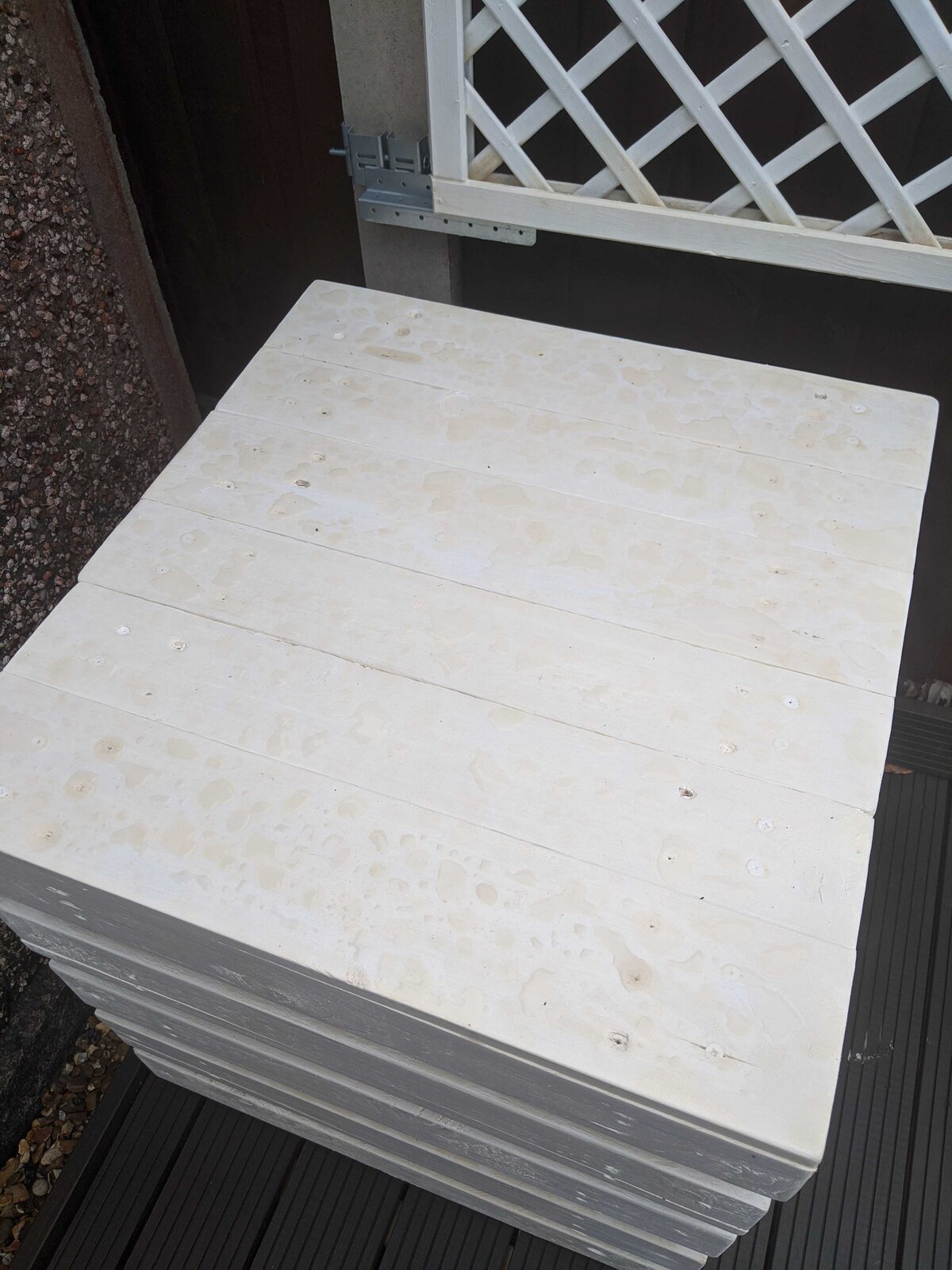

Hello, this is a bit odd and maybe nothing, but I was wondering if anyone with more experience of painting exterior woodwork might know what's going on.
I made a rough table out of pallet wood and gave it three coats of Cuprinol Garden Shades Daisy White. It looked fine in the dry of the garage but after a week out on the deck and a couple of rainstorms, the water lying on the top has a strange discolouration (see attached photo).
The trellis behind was given the same three coats about a month back and has similar discolouring, which I put down to rusty staples leeching into the paint. There are no rusty nails in the table though.
I'm not sure if this is down to the paint I used, it only seems to be happening on the surfaces that have standing water on them. I'm kinda thinking it might actually be the rainwater that's discoloured.
Anyone seen this before?
Hi There.
It might be oils and sap leeching thru from the wood. But a white tinted colour always going to be a pain in garden with the rain. Try giving it a clean with some bleach kitchen spray.
I thought it might have been the crap wood I used for the table, but then the trellis is off-the-shelf treated and a different beast altogether. It definitely looks like the paint doesn't like prolonged contact with water, which would be odd for a 'garden' product.
