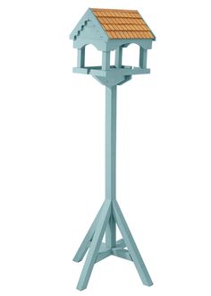

I am about to build a large bird table for my garden, and I would like it to be painted rather than left natural.
I will use exterior paint, but I want to ensure the wood doesn’t rot and the paint doesn’t discolour or flake.
Can anyone advise me whether I should use pre-treated wood, or would plain untreated wood be fine? Also, should I use any kind of undercoat?
Many thanks, and any other top tips much appreciated.

I know what you mean. JohnD, but this is the sort of thing I'm hoping to achieve... (see attached image)

If it was me, I'd use oil-based Aluminium Wood Primer (it is grey, not silver)
It's the most durable primer I know, it also seals knots.
For cut edges, soak in Cuprinol Clear wood preserver and allow to dry fully before painting.
In the garden, I would always prefer treated wood, and like to soak the ends. I believe Tanalised is an empty-cell pressure treatment. I don't think I've ever painted any, though I have used fence stains and decking stains (which seem to be better). Water can get in through knots and shakes, and rot it from the inside.
You can paint over Cuprinol Clear, once it's dried, it's a solvent based preserver mostly used indoors as it has no water-repellents, so doesn't need weathering. I've used it with Aluminium Primer and found it very durable.
I sometimes go to a woodyard that has remnants from boat-builders, and have been lucky enough to get bits of teak for important outside work. Recently I've been using linseed oil on outdoor joinery. It is not damp-proof.
I use Sadolin Superdec 2 coats onto bare wood - job done;)
Thanks Nige. I've Googled Sadolin Superdec and it looks like the best/easiest option.
Many thanks for your advice.
