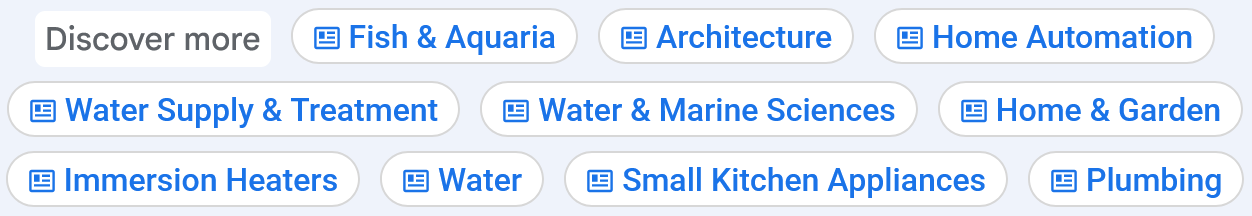

1785938106245.pngThis keeps coming up, so I had a look. As I am getting older, I find getting up to do minor tasks harder and harder, and falling asleep in the chair with the TV, and waking as it times out is not unknown.
So sitting there, trying to find something to light my way to the light switch.
But such a simple task, can be done so many ways, auto turning on lights ½ hour before dusk, using the mobile to light ones way, using the mobile to turn on the lights, using speakers like Nest Mini's to turn on lights, fitting a power failure torch 1785938750027.pngis likely one of the better options, once you move in darkness it turns on, and is also there in a power cut, but is that "Smart" no internet involved, no voice recognition, and even with a total black out, it still works. I personally think they are a very smart idea, even if not classed as a smart device.
But we read this and there's not even a mention, not that I expected one, but sometimes we must look back to basics, why do we need it?
