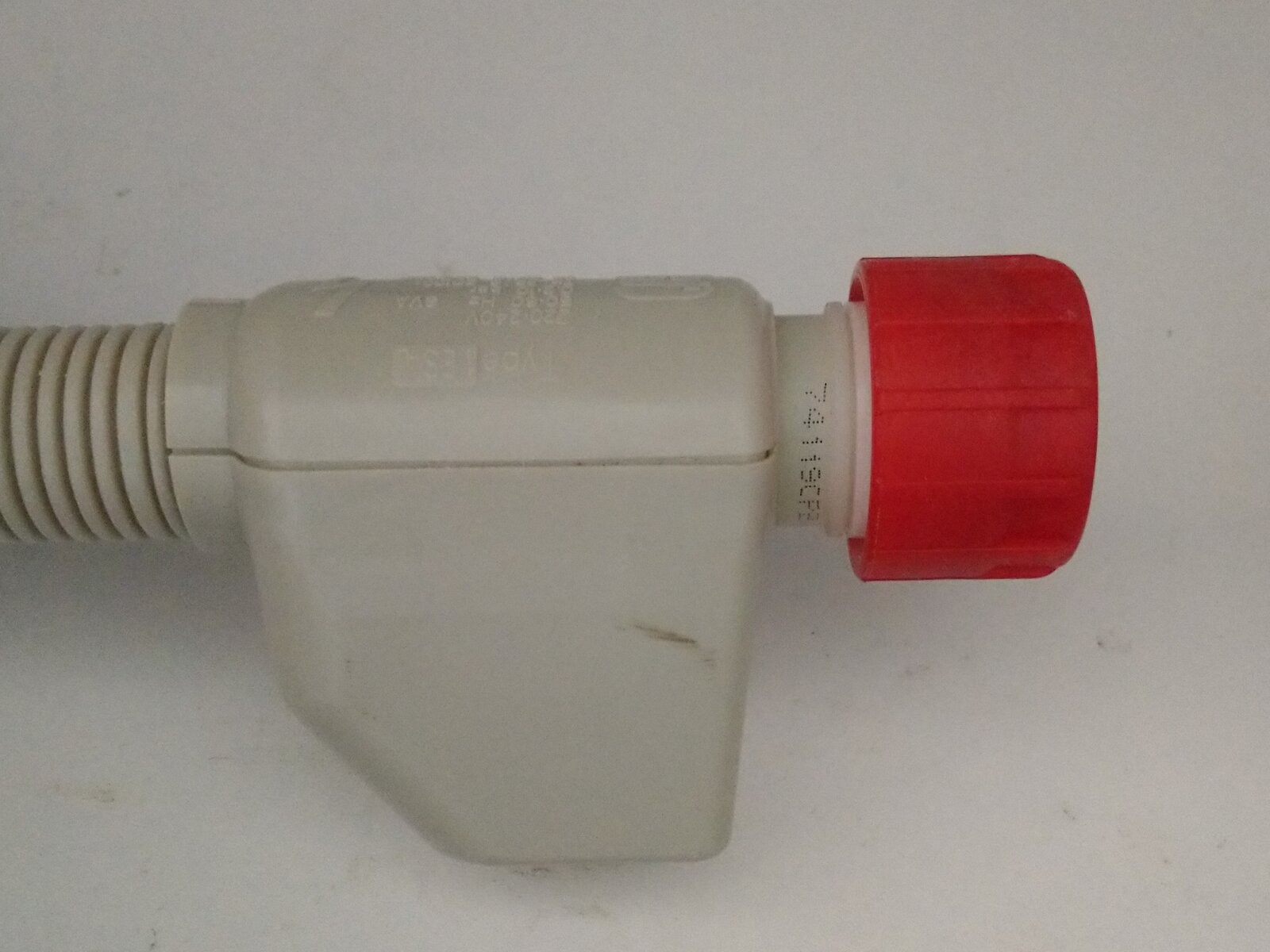

Evening,
Probably an easy answer but what can I use to connect my aeg dishwasher to my push fit polypipes (15mm). It's a 1es-l red connector. I thought it was 22mm so bought a 22 to 15 convertor but it doesn't fit. It's very close to fitting but not quite . Prefer to use jg if I can.
I've attached a pic so hopefully someone can identify it.
Looks like an anti flood device . I assume the red plastic is a nut with internal female thread ? If so it's thread should be 3/4 BSP . And the valve suggested above ok.
Yup, just to be sure tho, take a pic of that red connector end on so we can see the inside of the fitting.
As suggested it should be a 3/4" bsp but if there's one thing I've learned is never to assume in this business.
I would also prefer to use a brass appliance valve rather that plastic but that's just me. ;)
