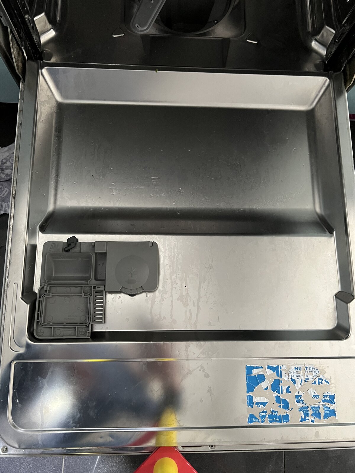

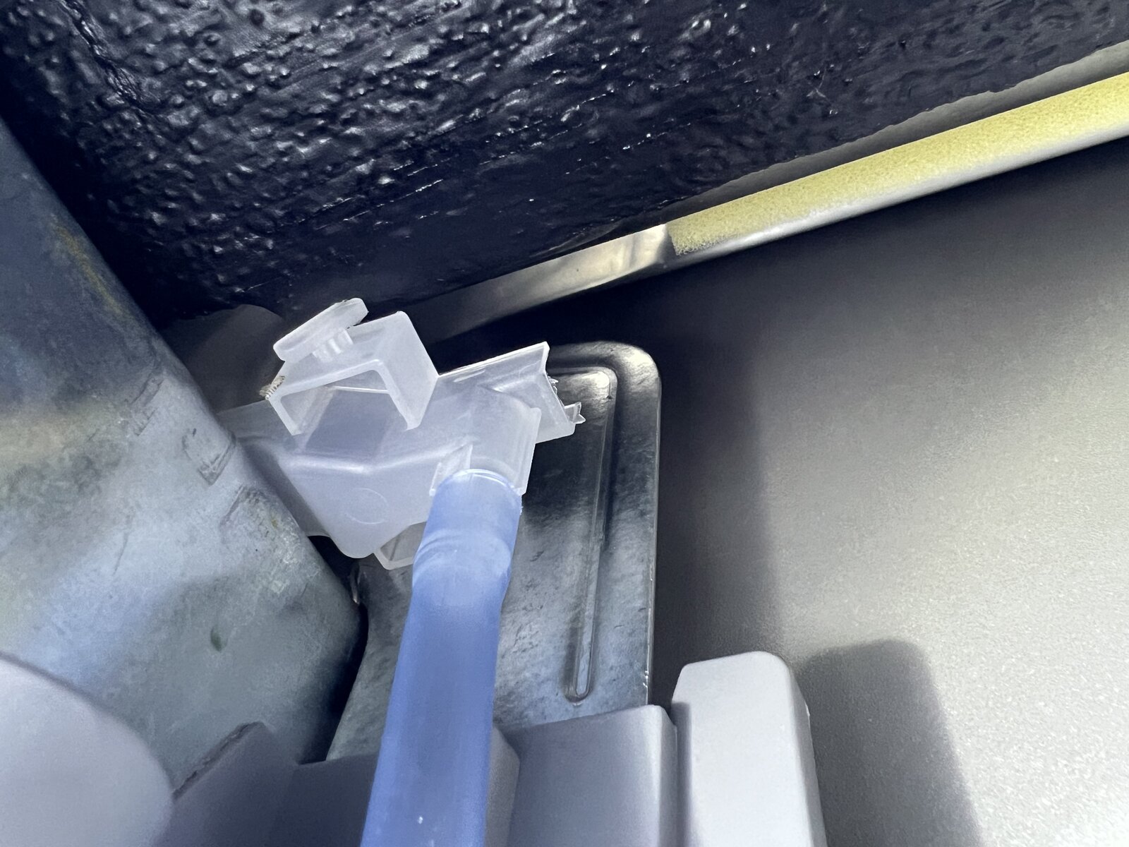

People can't do much without pictures. Is the float inside the washing compartment or down at the base plate of the machine?
The float is on the base of the machine

I think the water is coming from the door there is what appears an overflow tube, on the bottom corner at each side near the door. I can only assume that water is building up inside as the pump is not emptying it and when it gets to the seal height it goes through, this gets to the float lifts it up and the pump kicks in to empty the dishwasher. I have checked for leaks elsewhere and had the dishwasher propped up and can not see any.

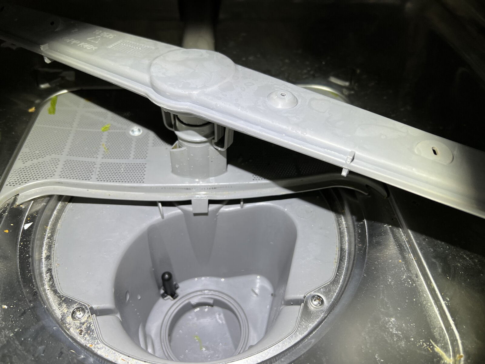

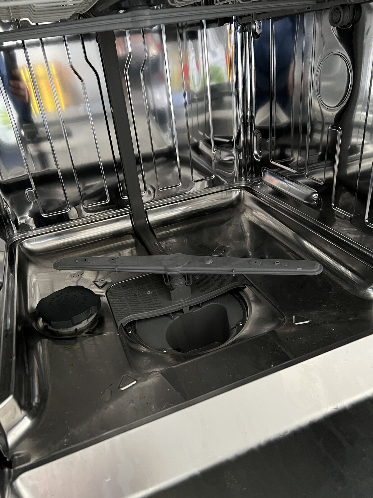

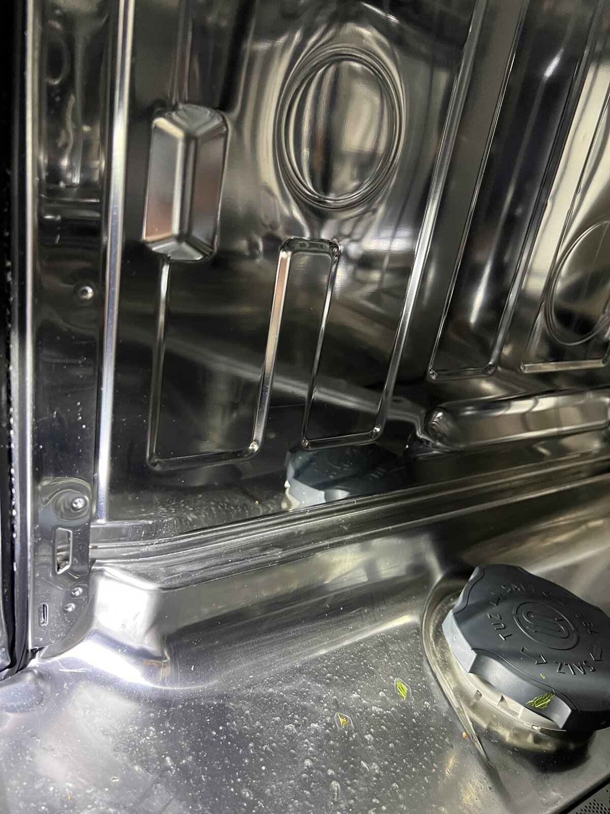

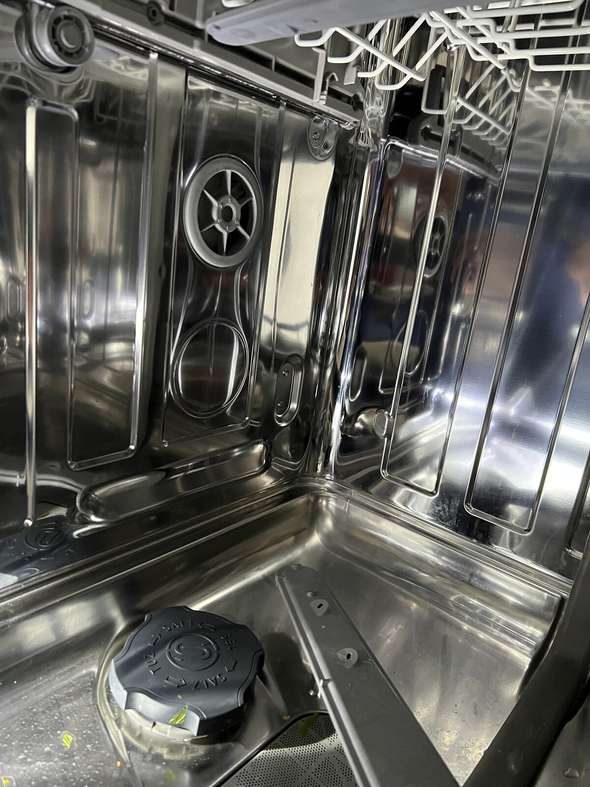

There should be a float inside the washing compartment. If that is stuck at the bottom. The machine will think the compartment is empty and not turning on the pump. Find the float and assess if it is stuck. A stuck float could cause an overfill that leaks to the bottom pan.
Ah great I will have a look, can’t say I’ve seen anything obvious.
It will be below the water jet blade, and about the level of the bottom of the door when it is closed. It could be under a cover fixed on by screw.
Just to clarify a few things, the anti flood in the base floats when you have a leak hits a microswitch and makes the drain pump run continuously also gives you the P1 fault code. It appears you have an overfill situation if water is getting high enough to reach the overfill escape tube. Your fill is controlled by a flow meter, bottom left with the two reinforced hoses on your last picture which regardless of your water pressure will take in the same amount. Flow meters are fairly reliable but broken wires in the door harness to the fill circuit are common on Beko dishwashers.If you remove the lower white door panel have a close look at the wiring harness for broken wires.
Thanks for replies. I’ve tried locating a float inside but can’t see anything. From the photos can you point me in the right direction.
I can’t get to the flow meter as I have put it back in place, but will take it out in a few days. Even if the flow meter had water scale would this affect the pump turning on.
