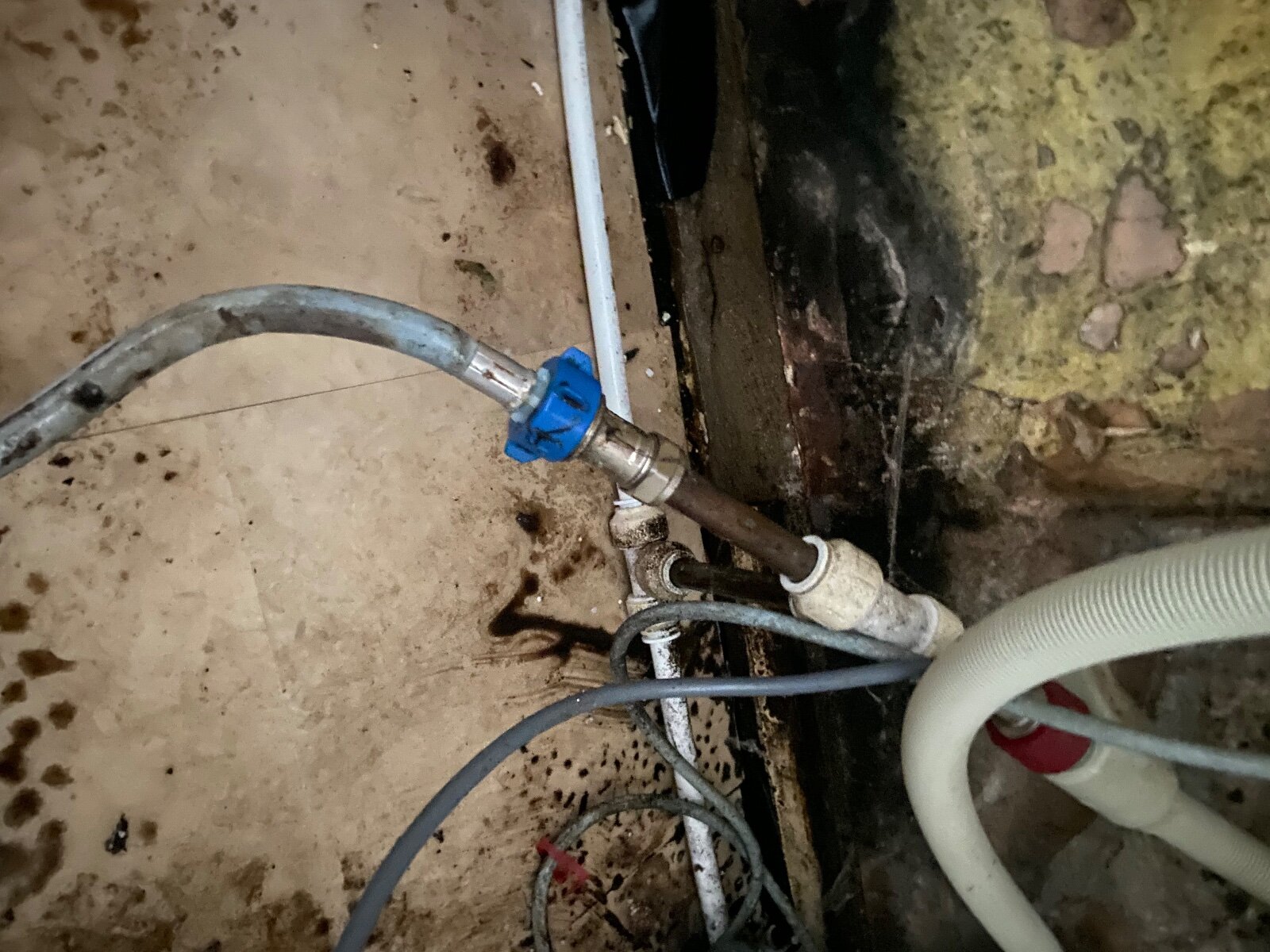

Just pulled washing machine out to access sockets, check cables etc, and noticed we had a leak from the compression joint which supplies water to the washing machine. Photo attached. Can stop leak with the isolator, so it’s the washing machine end of the valve.
Is it likely that the leak from supply to one appliance tripped the other appliance?

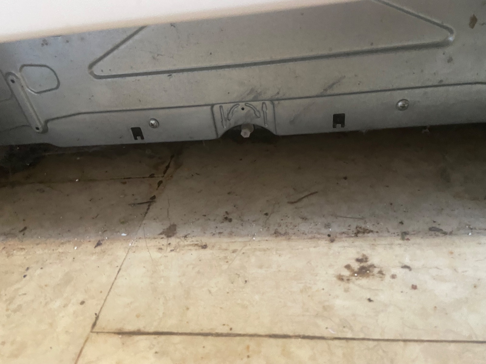

I was also going to check flood tray for the DW. According to AEG manual it’s at the bottom of the DW and revealed by a few screws. Again, photo attached. Do you concur with this.

Don't know if the access on your dishwasher for flood tray is that shown in your pic ,but suspect it is.

Thanks re flood tray. There are six retaining screws for that.

By the way the leak on the washing machine hose ,if it is where it connects to the isolator , a new washer will sort that.
Thanks again. No lights when dw turned on. Leak-the water is emanating from the area directly under the blue plastic screw. (As per image) Will source replacement washer.

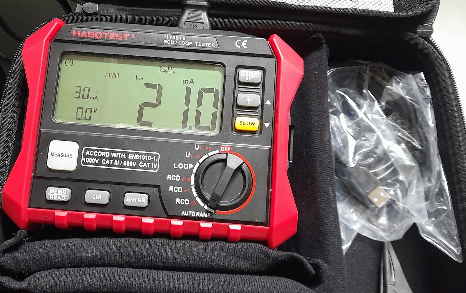

First what is tripping PartID_CU.jpg second how are you testing, VC60B.jpg insulation tester, RCD tester ramp.jpg RCD tester, Diffrence line neutral 8 Feb 24 reduced.jpg and clamp-on ammeter can all help, I had the RCBO trip on front of house ring final, I went all around house unplugging things, and on unplugging dishwasher RCBO stopped tripping, just to be sure, I tested dishwasher, no fault found, and tested the ring final and ramp test showed well within limits, so plugged back in, and all running again, and I have not a clue why it tripped to start with.
I will assume an interference suppressor had a faulty capacitor or something similar, and the insulation tester has blown it clear, but likely I will never find out what it was.

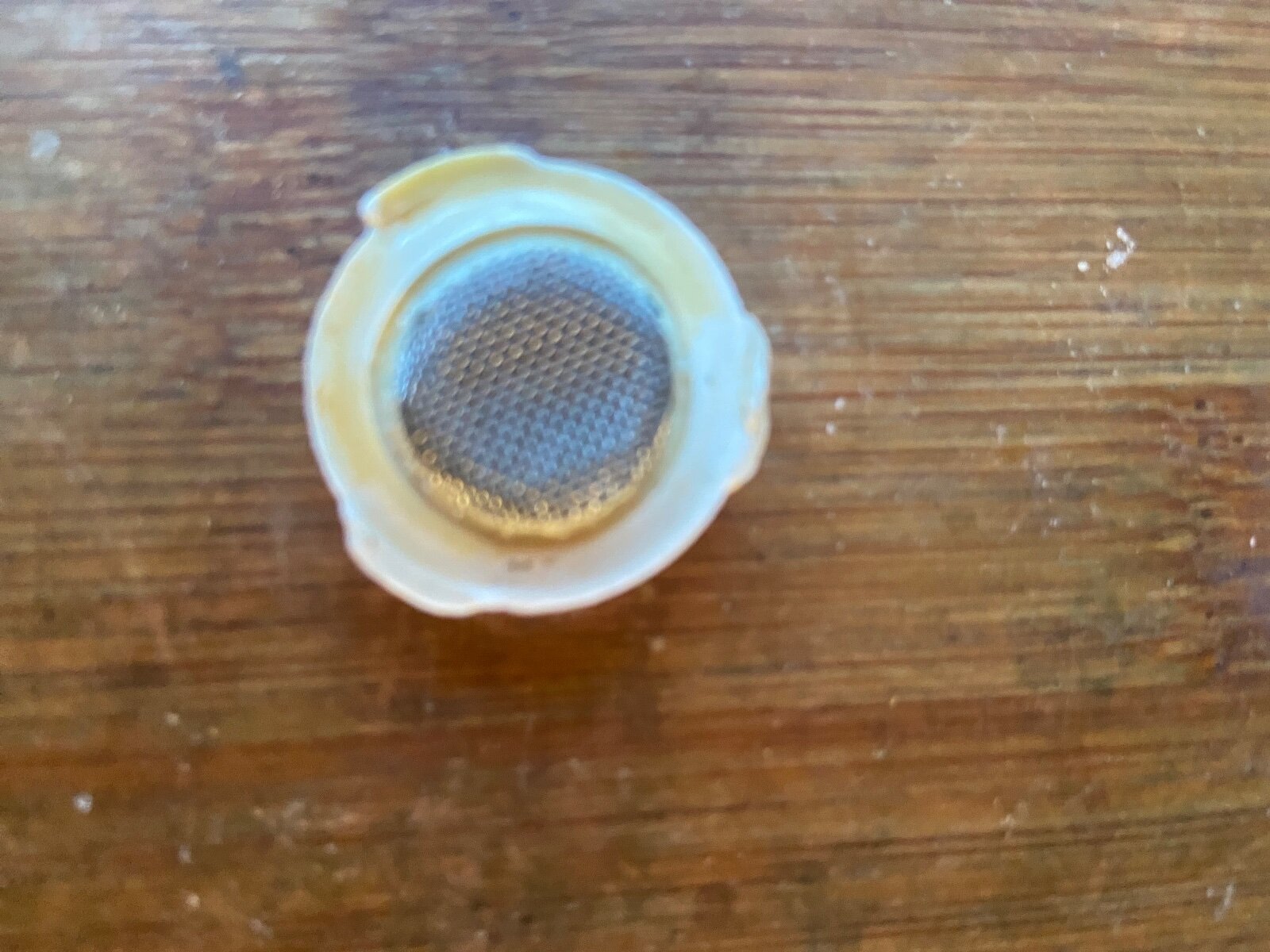

This is the washer in the inlet hose. Are the current ones like this?

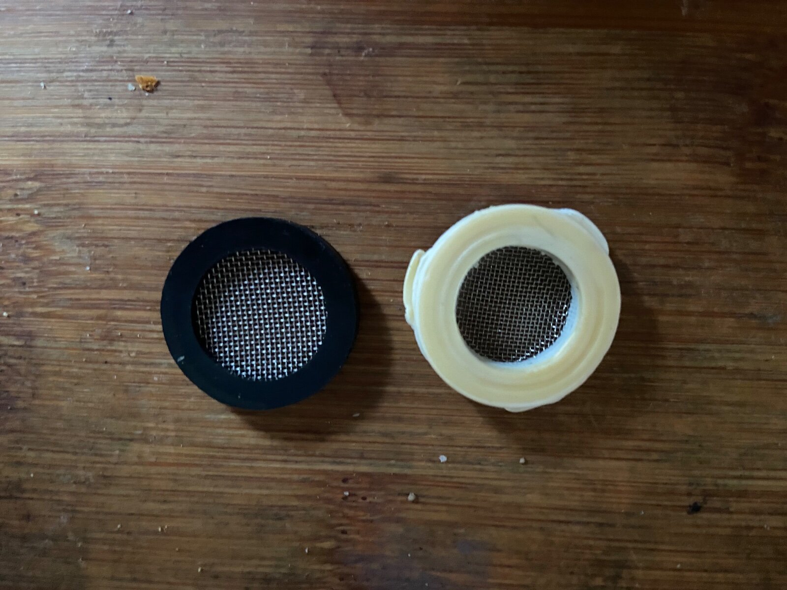

Bought these 3/4 hose washers as replacements. Fitted but leak still present. The only difference appears to the lugs and on the old washer, thickness and bigger filter. Diameter is the same. There’s no washer in the isolator so has to be this one causing the problem. Have included new images.
It’s an LGFWV686WTE.
Should the new ones work?
