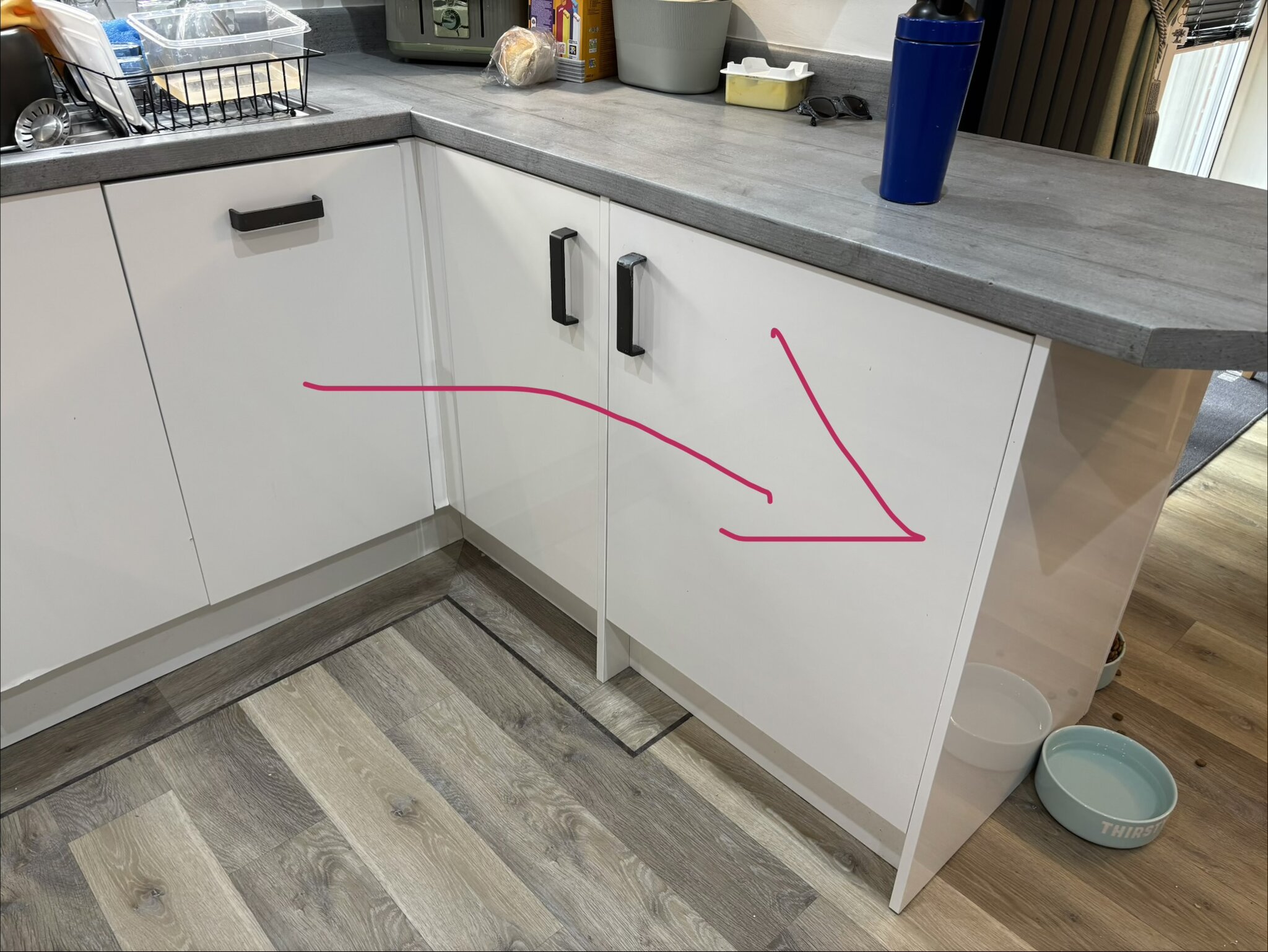

Morning all,
Moving the dishwasher so the waste will be approx 3 mtrs away.. do I extend the waste pipe or use a longer dishwasher waste hose?
Thanks all
Mark
As long as you weren't extending the waste too far and could get the fall then that would be the ideal, though the pump in the appliance should deal with a 3m drain hose no bother too, only issue with that is it may not clear the hose properly at the end of the drain, depending on how the hose was run.
