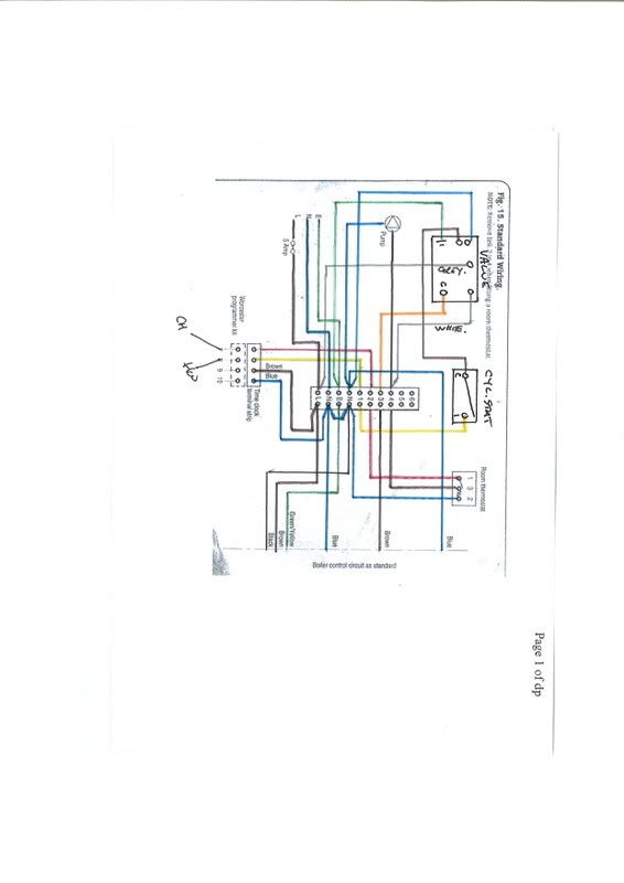

Thanks, I have seen that before... but I cant seem to work out how to wire it into my current control panel.
Attached diagram of current wiring... any idea where \ how I would wire it into this?

You say that it need HW on when the CH is on. Is this through a switch on the boiler or do you have external timer/programmer?
If you have the WB two channel programmer, there is a switch on the back which selects between fully pumped and pumped CH/gravity HW.
You can find the boiler installation instructions (if you don't already have them) on the Installer Section of the Worcester-Bosch website. They give instructions about wiring up for Y-plan and S-plan.
