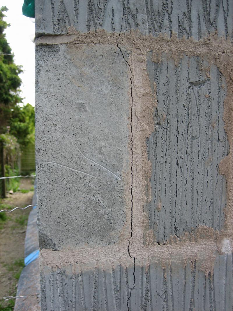

Do all aerated blocks crack - picture attached
6 Jun 2007
51
3
Lancashire
I'm building my extension with Celcon standard 3.6N blocks both inside and out with a fully filled 100mm cavity. I'm using stainless steel ties at 450mm centers vertically and 600mm horizontally.
I've read a number of threads about settlement causing aerated blocks to crack. This hasn't been a problem for me - until now!
A crack has appeared on one of the external corners of the extension - see picture below ---
The crack extends upwards for another 3 courses and downwards for another 2 courses but only as a hairline. It stops 2 courses above the DPC and 5 courses below the top of the wall. There aren't any cracks on the inside of this corner or indeed anywhere at all in the inner leaf. There is one more hairline crack in the outer leaf about 4 meters away.
I've carefully followed the SE's spec with the mortar mix and the manufacturer's instructions with the plasticiser. The walls have been laid carefully and are plumb. The bulk of the blockwork has been in place for about 6 months.
Is it inevitable that my walls will crack because of my choice of block and won't this eventually compromise the overall strength of the building?
If this is settlement cracking (and I hope it isn't anything more serious!) will it continue for ever. The external finish will mostly be render, is it likely that it too will continue cracking for years to come?
Has the wall integrity already been compomised and should I be looking to replace the blocks shown in the picture?
Any thoughts would be very welcome. Thanks

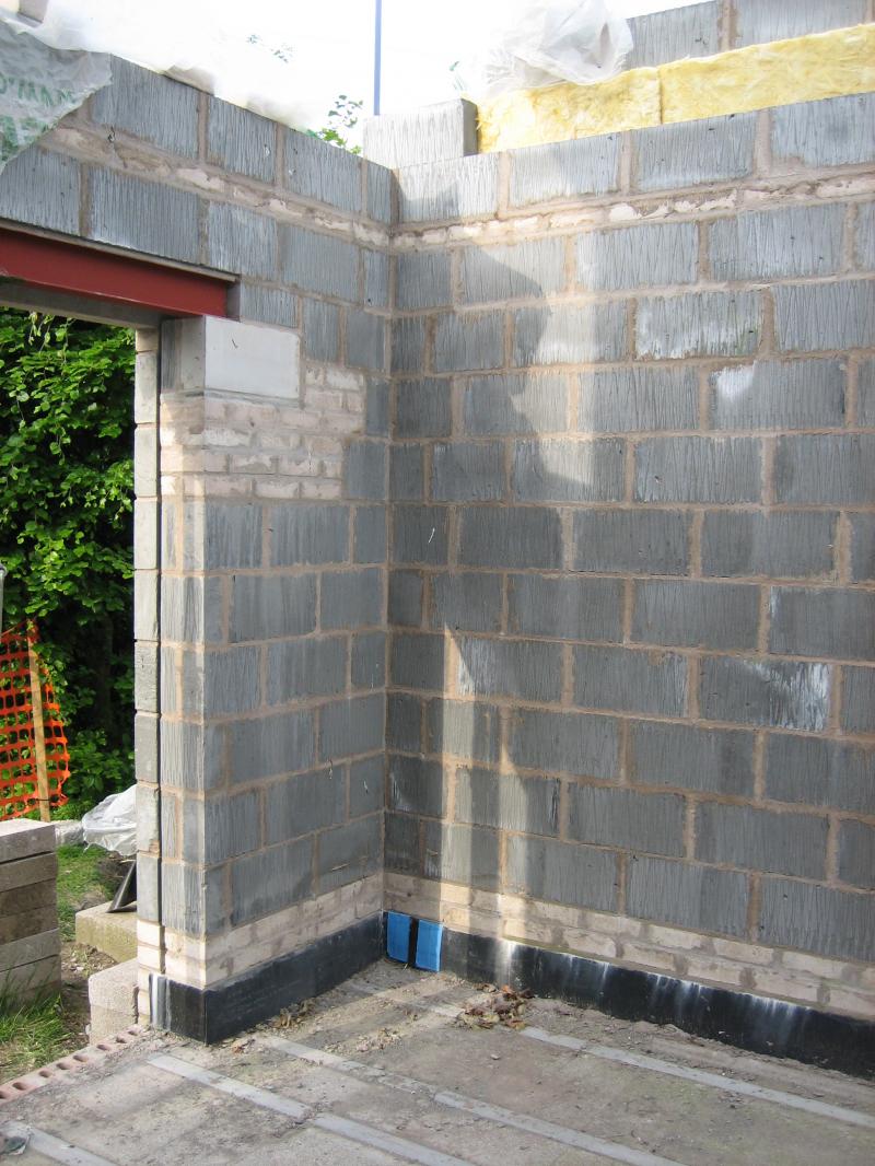

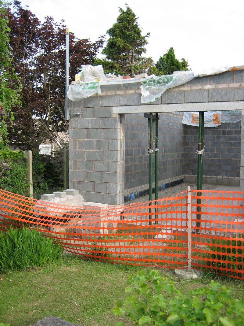

OK, I just nipped out and took some photos. These two are showing the corner in question.
The block shown end on in the earlier close up is the first full end on block you can see showing above the dwarf wall in the foreground currently under construction. I couldn't get a shot of the side of this wall but it's about 10m long with an expansion gap about 6M down from this corner and a small window about 4M down.
This photo is of the inside of the same corner just to give a feel for things.
Hope this helps. Thanks
it looks like a settlement reaction.
is the dwarf wall tied in and on the same size foundation as the main wall?
The dwarf wall isn't tied in to the building. The dwarf wall foundation is as deep as the building foundation but wider. It's 1100mm wide (yes really) - 300mm wall + 200mm limestone clad either side + 200mm extra either side.
Oh, and about the bricks. I live in a small village on the Lancashire/ Cumbria border, all the houses are a mix of limestone and render - no bricks in sight.
Thanks.

Looks like a classic expansion/contraction (shrinkage) crack.
Its a bit soon for settlement, the wall either side of the crack seems to be level, and its not a typical place to crack
We have had some extreme weather of late, and if this wall is getting hot/cold wet/dry then its going to expand and contract.
I've looked at a building the other week where several vertical cracks have suddenly appeared in the external face after 30-40 years - its the second one I've seen since March. In this case the resident actually heard the cracks appear when he was in the garden. I'm putting it down to extreme hot and dry weather immediately following a period of cold and damp weather.
It may be worth cutting the blocks out and replacing rather than trying to glue it. Also add some expanded metal to the bed joint.
Out of interest what mix was specified to inside and outside walls?
Were the blocks saturated when laid?

The forces that cause cracks tend to run at right angles to the line of the crack. Thus, a vertical crack tends to be due to horizontal forces and stresses. Thermal movement and overstressing cause horizontal forces and stresses. The crack stops at the dpc level, as the blockwork can slide on this.
The wall is not overstressed, as there's not much load on it, so it's a thermal crack. As Woody says, the weather's been quite warm of late and that's the probable cause. Nothing serious, but if you're rendering directly onto the blockwork, then leaving the crack will result in this being reflected through the render; as such, would go with Woody's repair advice.
Thanks a lot Woody and Shytalkz, your thoughts are much appreciated. I will indeed follow your advice and replace the cracked blocks.
