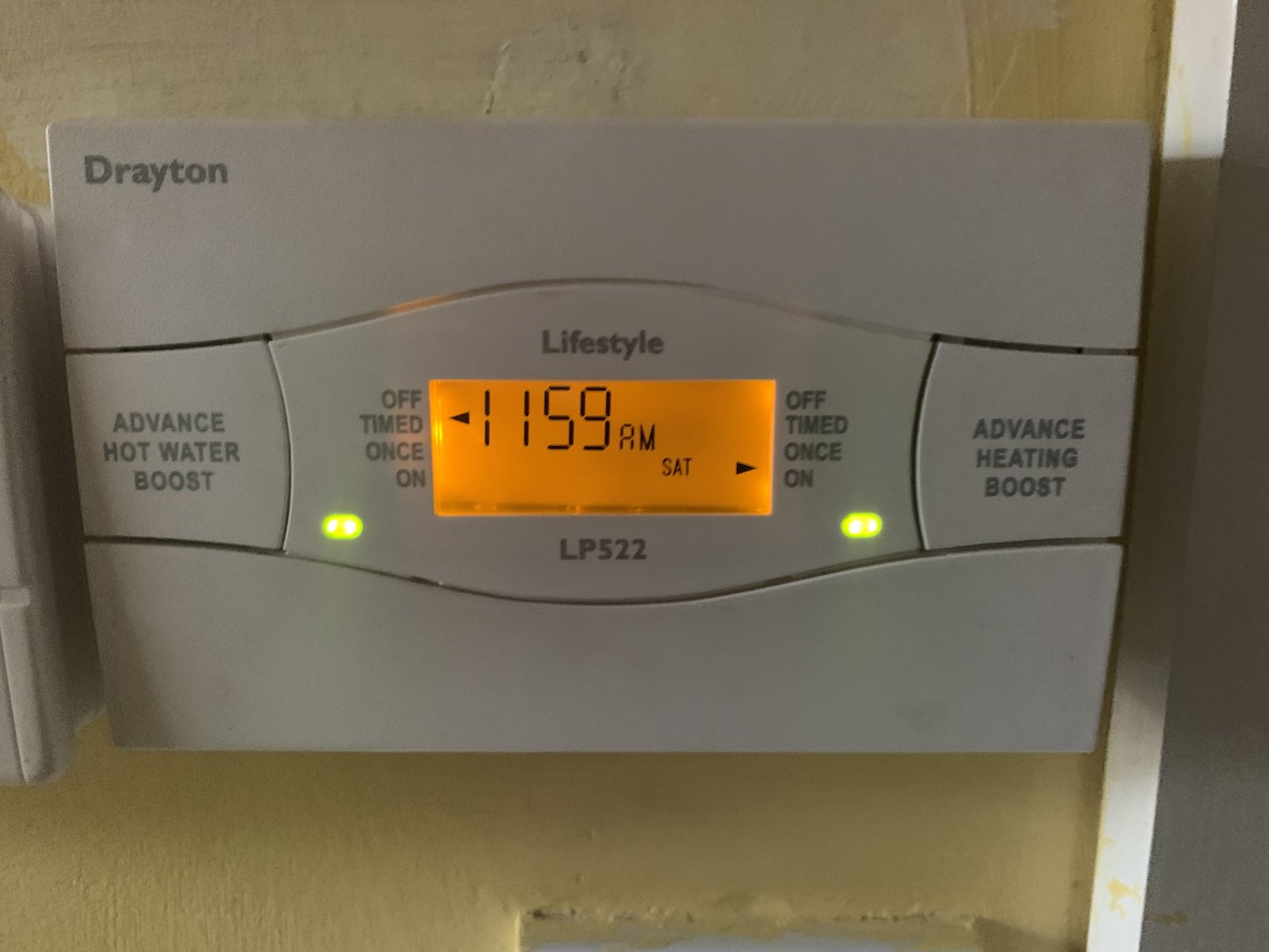

You haven't mentioned Hot water, is there a third timeswitch for that somewhere? Smaller properties were allowed to have one time switch controlling two thermostats, just want to check that isn't the case with yours. If you don't have a third timeswitch are you sure the second one isn't for the hot water.
The downstairs timer also is for water heating, see pic.
I have two timers as stated previously, one for upstairs other downstairs, a thermostat in hallway and a room temperature controller for conservatory which only controls the conservatory radiators.

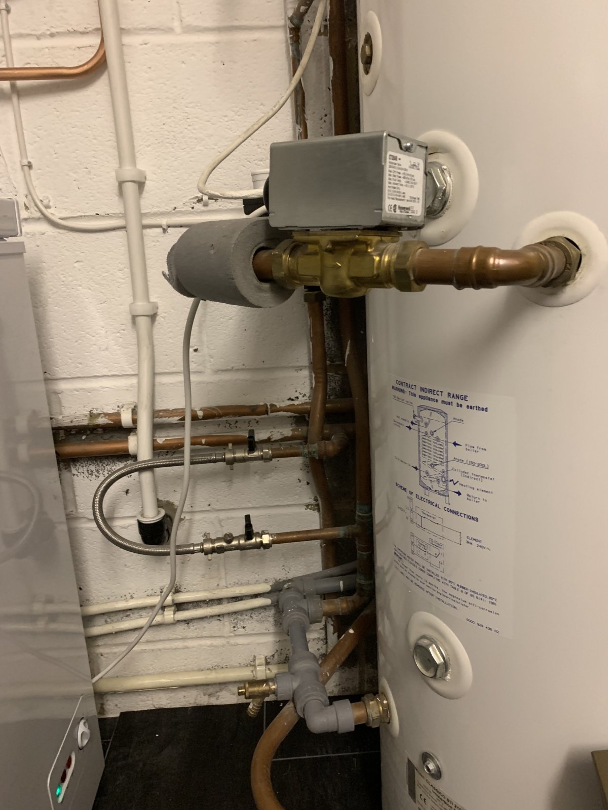

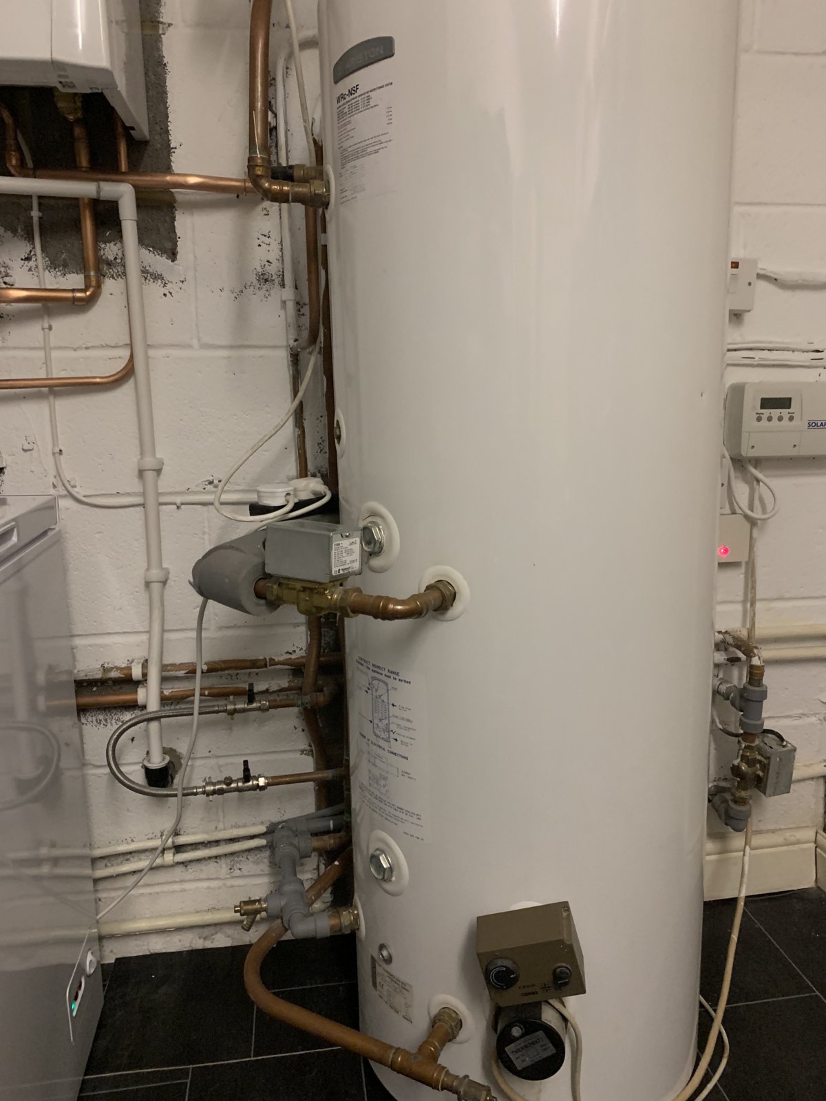

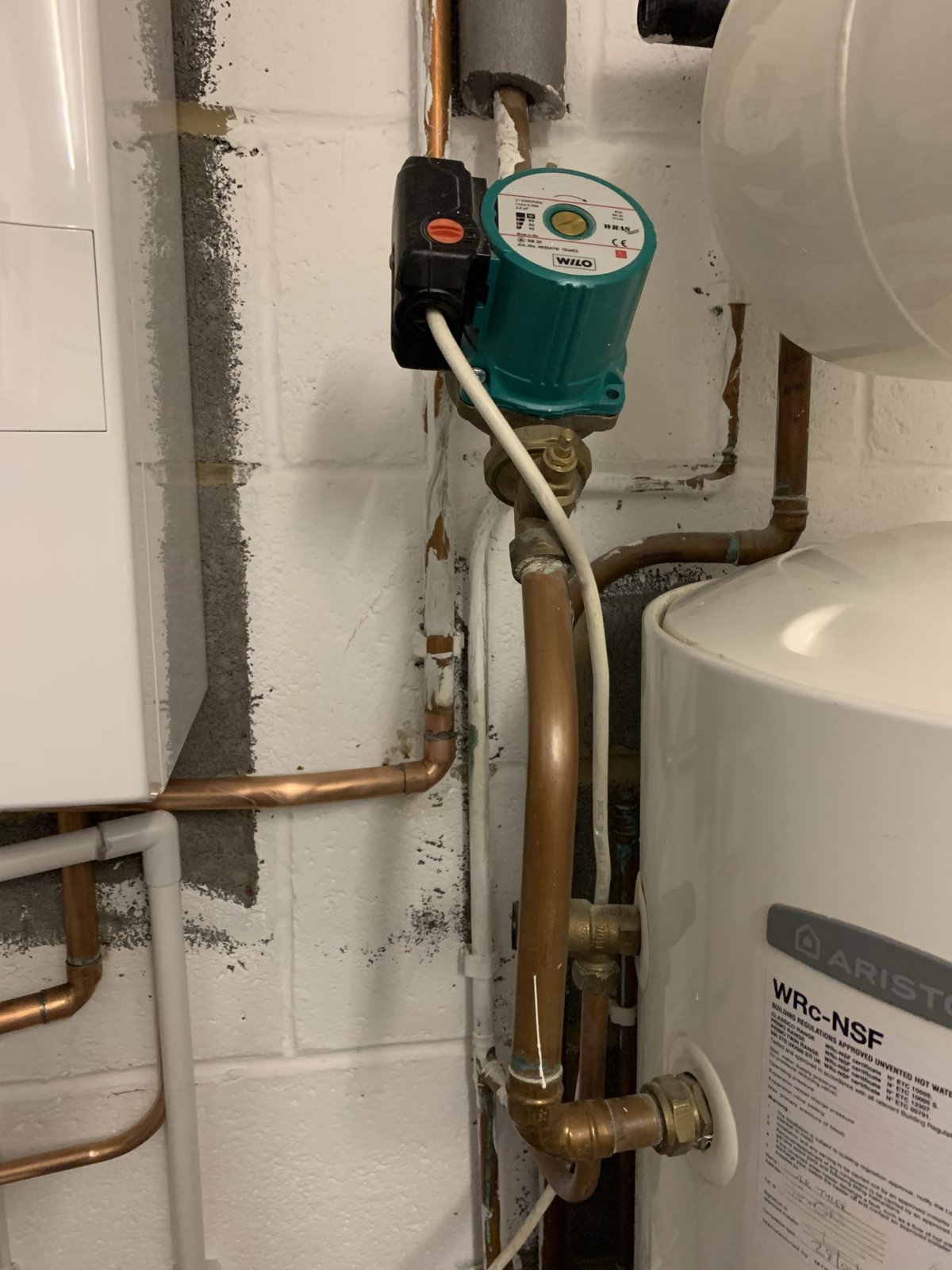

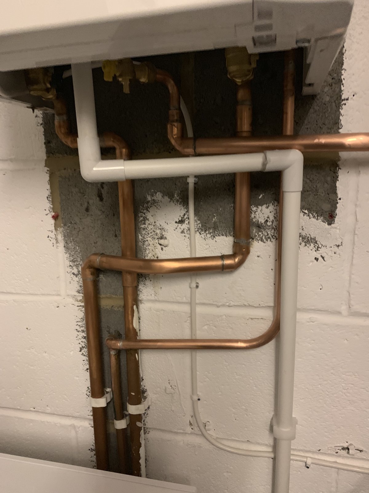

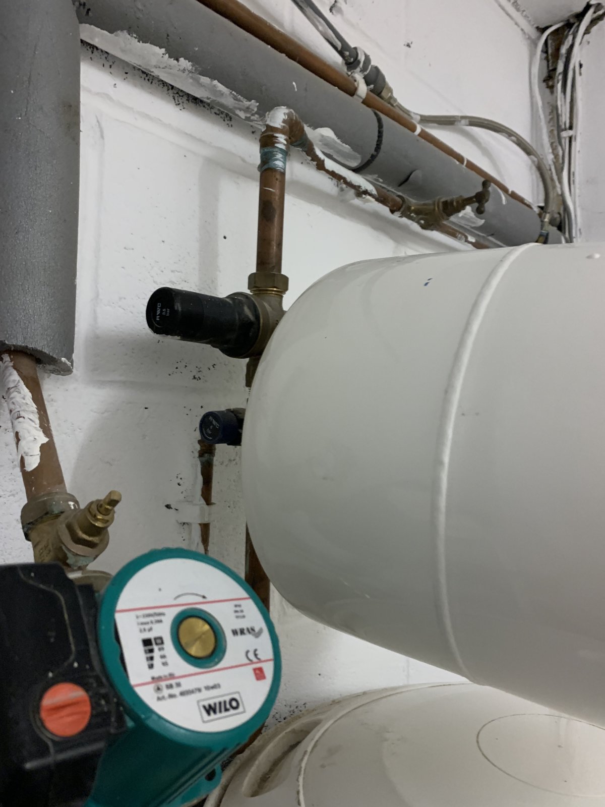

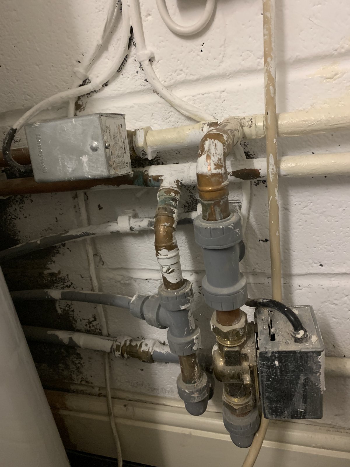

Here are pics of the setup, I know one of the valves switches the conservatory on only.

Difficult to see in the photos as they only give a snapshot (no pun intended) rather than the big picture. I thought it was perhaps a new build or at least after 2010 when the regulations came out, but it looks to be an older system that has undergone quite a few alterations.
I can only see three valves though, and if one is for downstairs, one is for hot water and the other is for the conservatory..........It doesn't mean there isn't an upstairs zone valve somewhere else, but normally they are close together.
How easy is it to fit one if it doesn't exist? Unfortunately that's a how long is a piece of string question. It depends upon the layout of the existing pipework and how the upstairs and downstairs relate to each other, if the upstairs doesn't have it's own pipe system and is tapped into the downstairs system it could be quite extensive and then there is also the wiring to consider. How much of it is there and what it is actually connected to.
I'm don't have any plumbing qualifications (my qualifications are electrical) So, maybe those who are can better advise on that aspect.

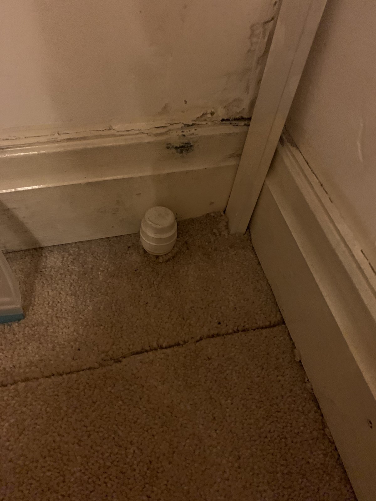

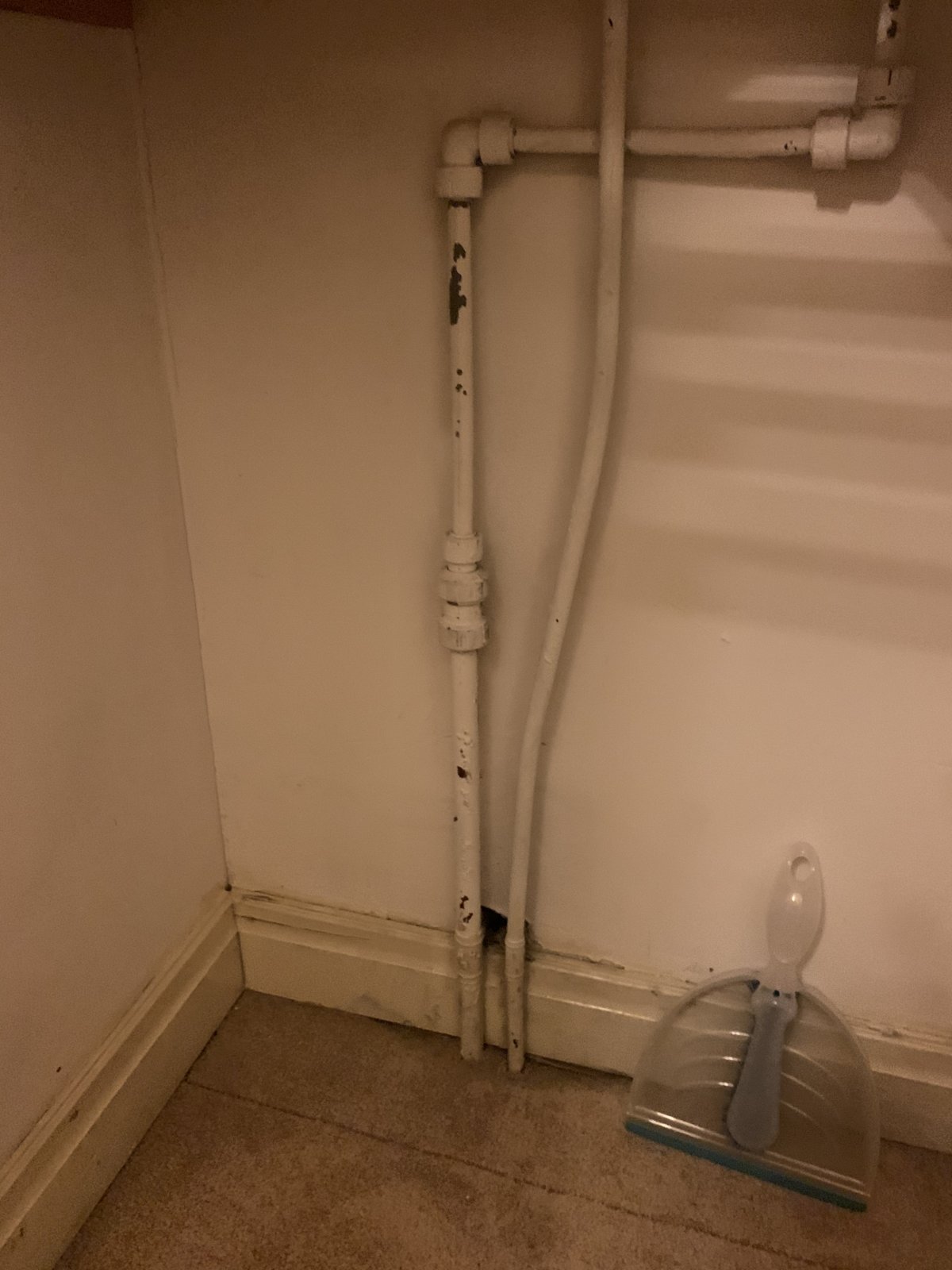

Nothing in cupboard upstairs either
Your system has been installed / modified by a total gibbon. I'm on the wrong end of a bottle of Cote du Rhone and one of my gin and tonics which should be declared a WMD, but those pictures are not showing anything promising.
