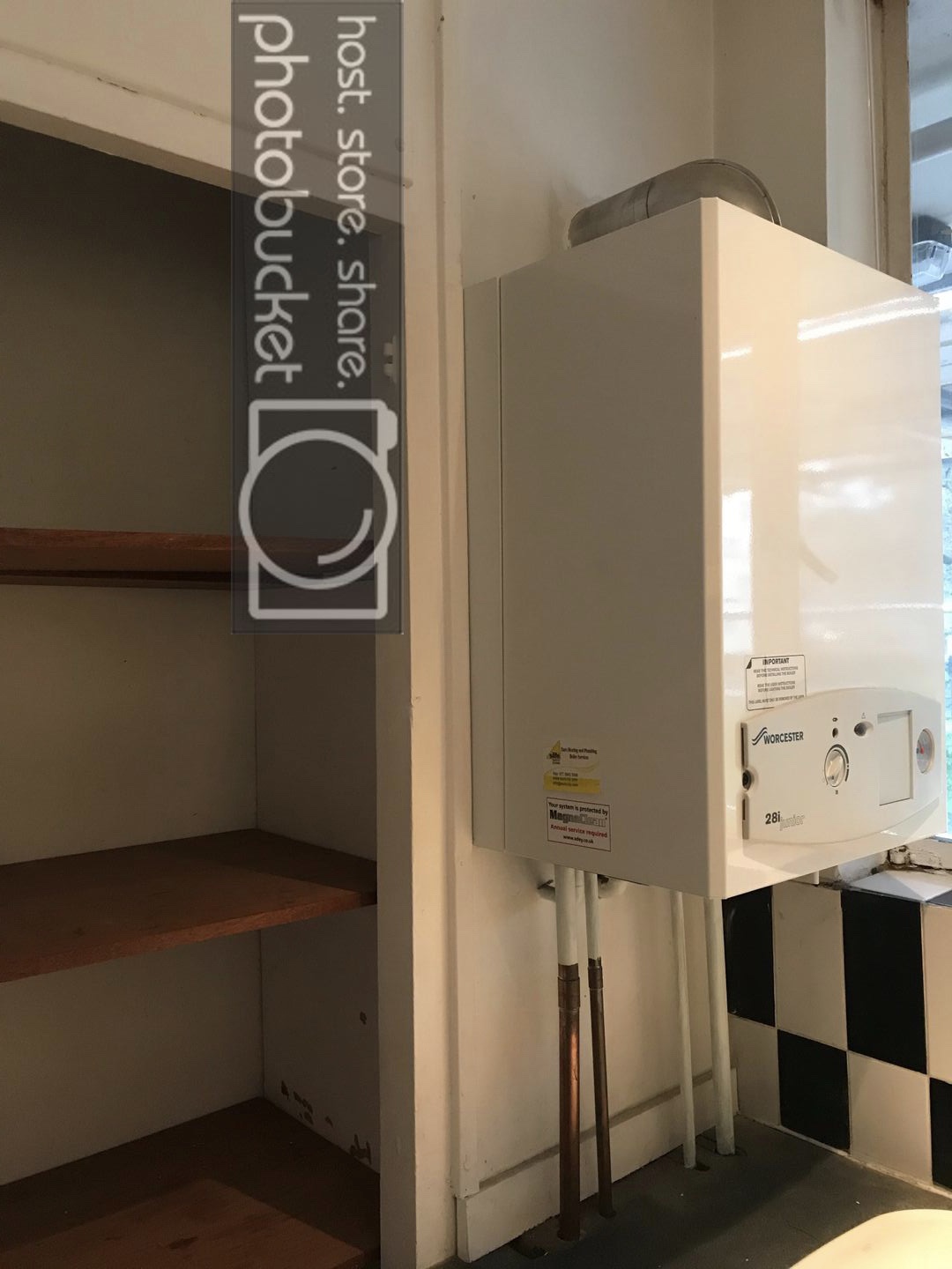

Hi all - sorry for delay, I wanted to upload photos as requested by The Novice but had to work out how. I have a nasty feeling you might have to lie on your sides to see them properly but no idea how to turn them sorry.
First, here is where it is now, sticking out in front of the window. Also in this photo is where I want it to be. This is in the very corner of my flat. So you can see that there's a floor-to-ceiling square-ish chunk cut out of my kitchen space. I don't have access to whatever's behind there but I believe it to be vertical pipes.
You can see where the vent hose goes in to that void space, it then turns a sharp right and comes out next to the window (slightly further away than the minimum gap required between a vent outlet and an opening window). If I move the boiler to the cupboard, the vent hose will go in a straight line through that space to the outside wall - at least, that's what the guy said to me (presumably, although I didn't think about this at the time, there might be a pipe in the way meaning it won't be this easy?). Somebody's going to need to hack their way in there to re-route the central heating pipes and so on, but clearly that's been done before now in order to install the system in the first place and so mustn't be a massive problem.

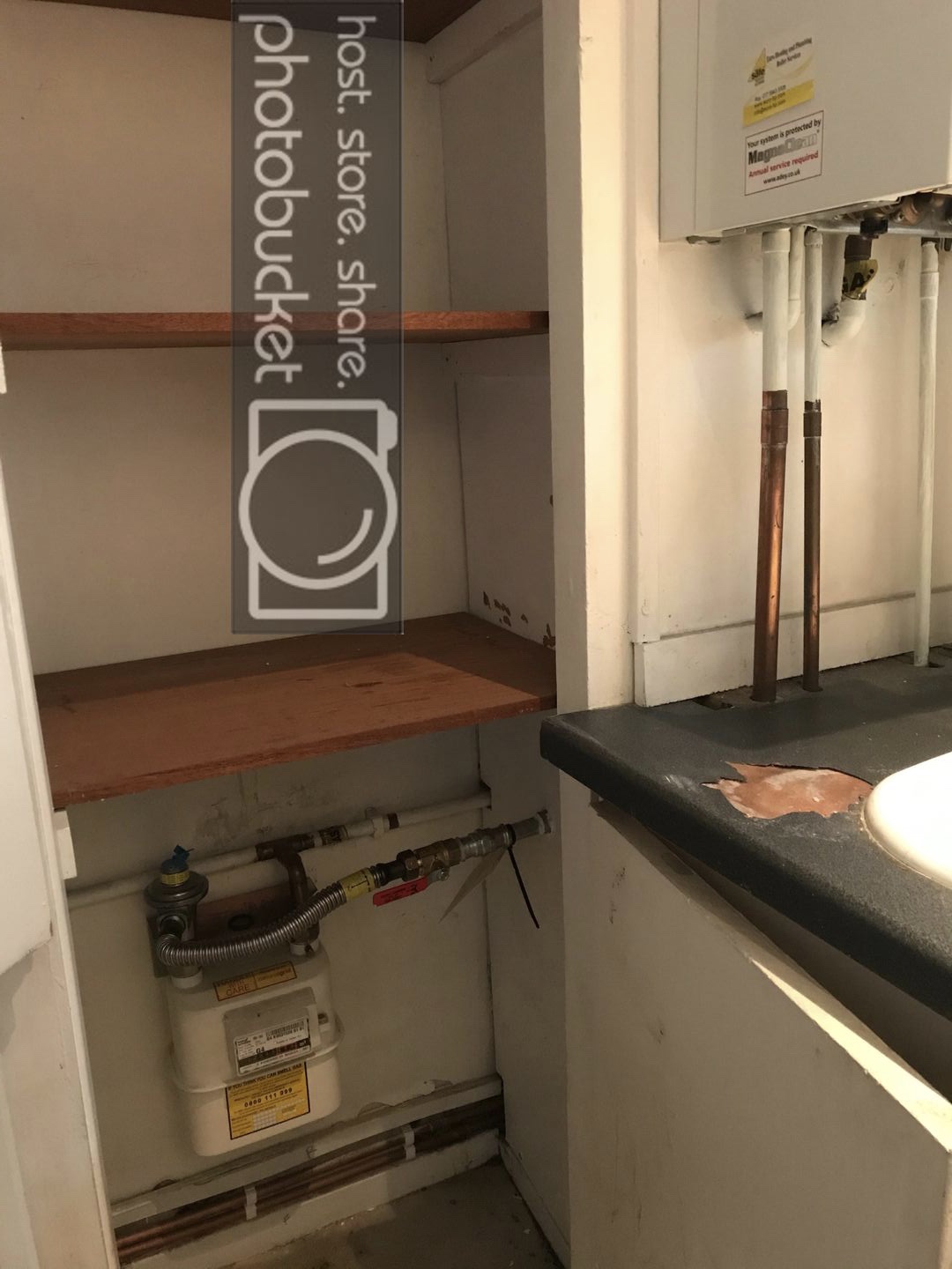

Second, photo content similar to the above but a bit lower down so you can see the location of the gas meter in case this matters to anything.
The cupboard isn't as shallow as it looks. I got hold of the boiler manual online and measured it and there is plenty more than the minimum clearance above, below, sides and in front.

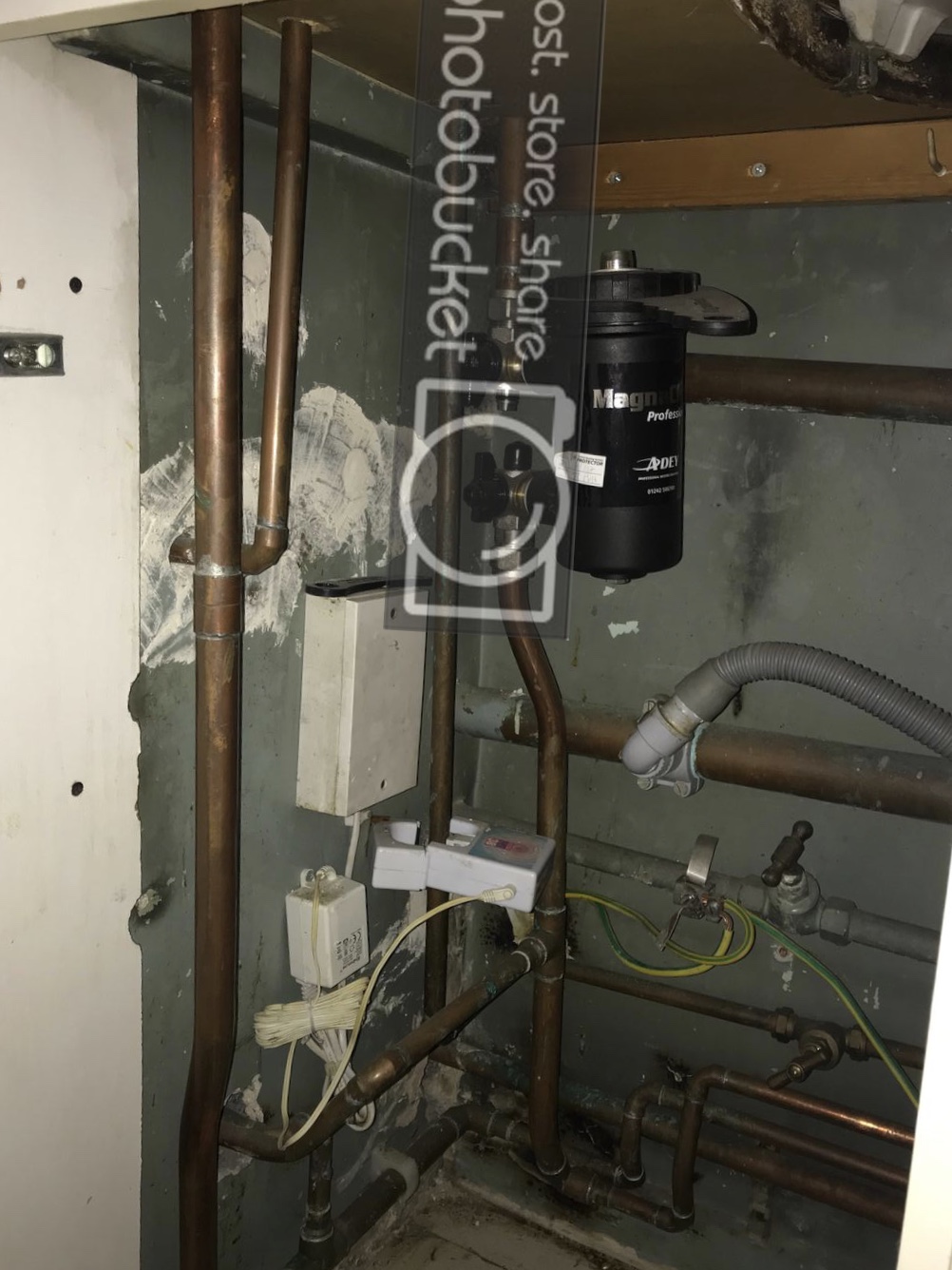

And third, is the cupboard underneath the current boiler location, so you can see the pipes and stuff.

You would need a new flue and I’d like to know what’s behind it at the moment. If you are doing a major refurb then take the opportunity to change the boiler for one with better hot water delivery. That vintage Junior isn’t that too bad but I wouldn’t want to move it. Consider an Intergas or Atag, two very reliable boilers. The meter is very close so you could get one that puts 30-36kw into hot water. You’d get 16ltrs a minute as AppleScript 9 if you are lucky.

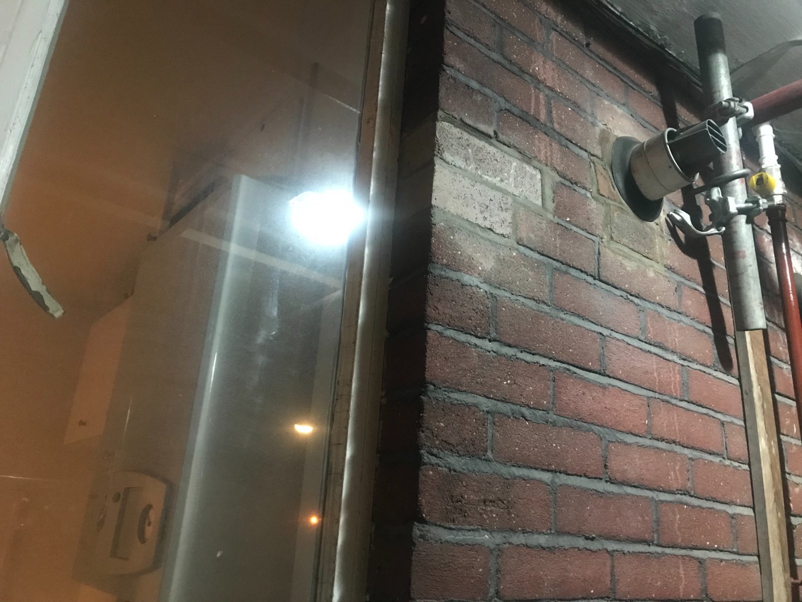

I'm sure this wasn't what you meant, but here is the flue outside. (Also there in the picture: scaffolding, a random bit of wood nailed to the wall which has always been there, and new gas pipes which are the brown/white vertical ones.)

I used to be able to get in to the bottom part of the void space, but when they installed the meter they put some stuff round the new gas pipe so that the (wooden) "wall" is now fixed in place unless I want to risk pulling the gas pipe out (rest assured messing around with gas pipes is not on my list of things to do). So I can't take a photo now as it is not accessible without ripping out the side wall of the cupboard - in other words it can be done but I don't personally propose to do it - I have no tools and if the boiler move doesn't go ahead I don't really want my cupboard permanently opening on to pipes and the outside wall!
From memory behind it was a big vertical pipe, some smaller pipes (can't remember what direction they went in, and no idea whether they went all the way up) and a metric tonne of tiny little insulation beads. If it helps with the Random Unseen Pipe Identification Game, it's kitchens all the way up - I'm on the first floor of a ten-storey block - and my neighbour's kitchen backs on to mine so it's kitchens on both sides.
So you can probably see from the photos, at the moment the flue goes in to that space and, presumably, turns a right angle where we can't see it. So there's enough space around/between whatever's behind there for it to do that... does that mean it could also be flued in a straight line from the cupboard, or is this something I would specifically need to confirm to avoid an "oh, $%*&!" moment? Outlet hole is, I think, not moveable because the outside of the building is listed and they are funny about you knocking new holes through. So I suppose there's a chance it might be "can't get there from here"?
As I thought, there is a service duct behind the boiler. You need to get someone better experienced to take a look.
My money is on the communal soil pipe and water supplies being behind that boxing in, unlikely you'll be able to route a flue through there as well. Only option, (if possible), would be to put a couple of bends in the flue to get it around the boxing in and use the existing hole in the wall.
Well it looks like the flue goes in to the boxing in then there's an elbow to the right and it exits where it does.
So it looks like it can be moved easily enough.
