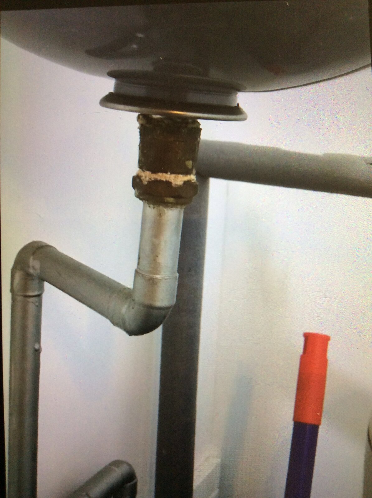

2. Please post photographs of hot and cold tanks and pipework around them.

Sorry I having problems with taking photos. If it were a pressurised system, do I need to drain the tank to change the pipe to the toilet?

As @just pumps suggested, does your HW cylinder look something like this?
th
Small tank above it
Yes you have an unvented cylinder.
Find your mains stop tap and shut that off and see if the toilet stops filling.
