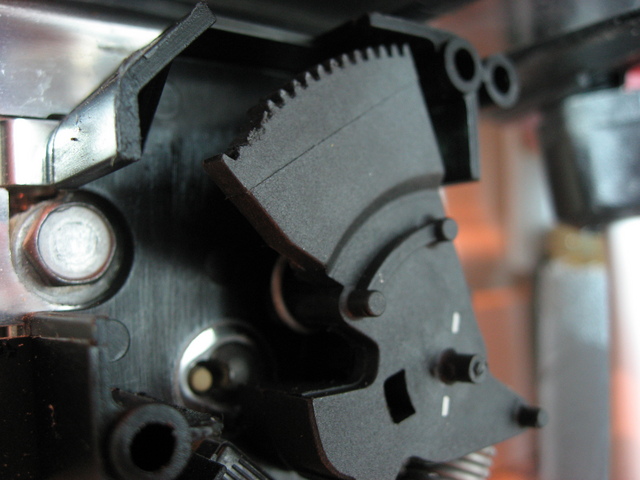

Decided to take the valve apart and found the problem:
The first few teeth of the valve arm had been worn away. Presumably it is only a matter of time until there's nothing for the motor to grip to start the valve opening?

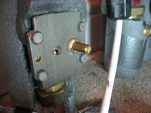

I can pick up a new valve off eBay for £20 but something tells me it's likely to happen again as the plastic arm is clearly an achiles heel. Will other actuators fit this valve, perhaps you can tell by this picture of the valve body?
I could of course replace the whole lot but I'd rather not if at all possible.
