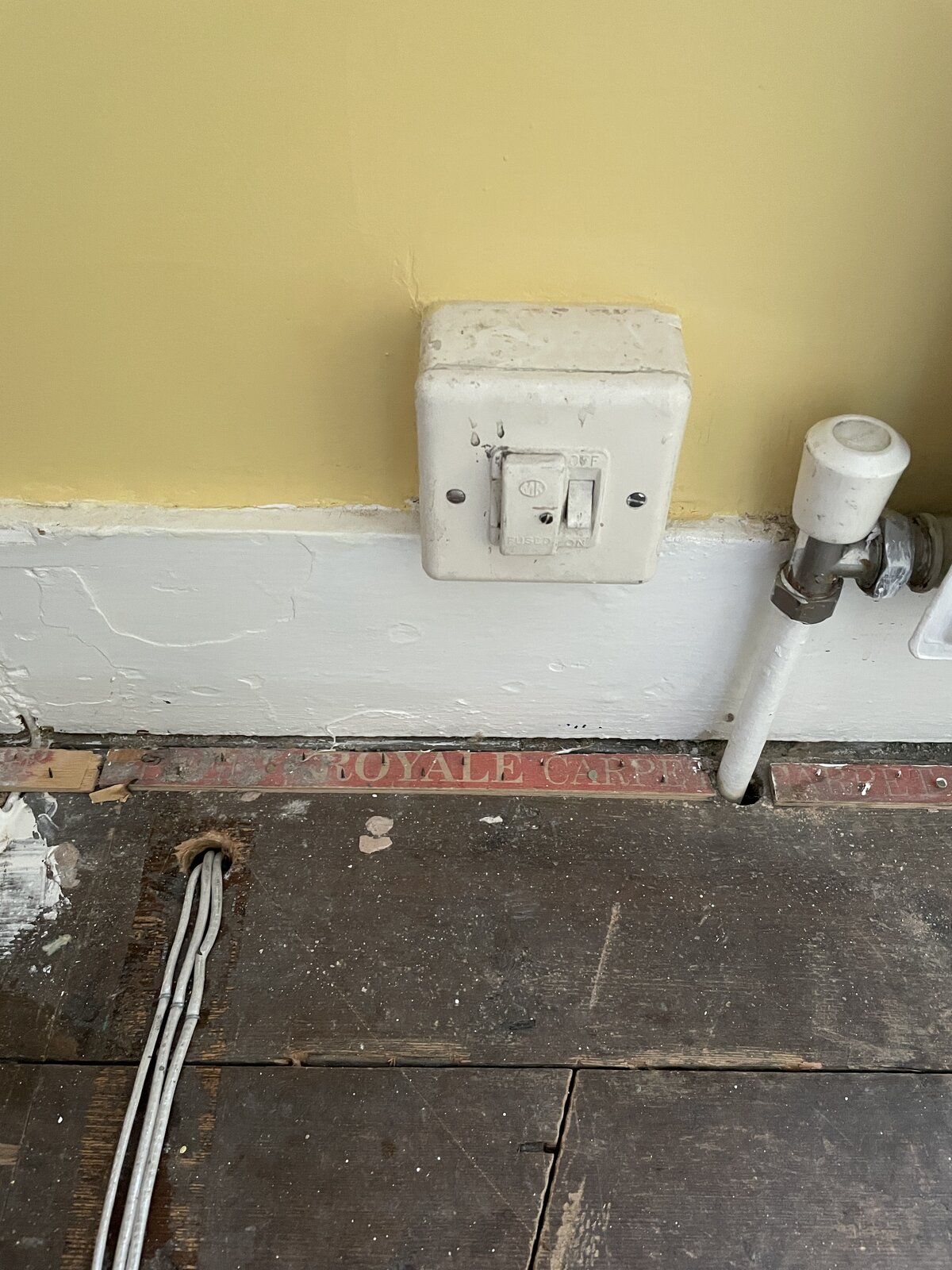

T Turnyourtvoff Joined 27 Dec 2015 Messages 19 Reaction score 1 Country 9 Jul 2023 #1 Hi, does anyone know what these switches are? I have a few on the second floor. Thank you.
A Astra99 Joined 1 Feb 2011 Messages 977 Reaction score 214 Location Gloucestershire Country 9 Jul 2023 #2 They are very old Fused Connection Units. May have been used for electric heating at some time in the past.
T Turnyourtvoff Joined 27 Dec 2015 Messages 19 Reaction score 1 Country 9 Jul 2023 #3 Thank you - so I am guessing it would be ok to remove provided I follow the standard safety precautions? There are no electric heating units.
securespark Joined 11 Jan 2004 Messages 46,209 Reaction score 3,652 Country 9 Jul 2023 #4 If they are connected to the daytime supply, you could convert them to sockets.
