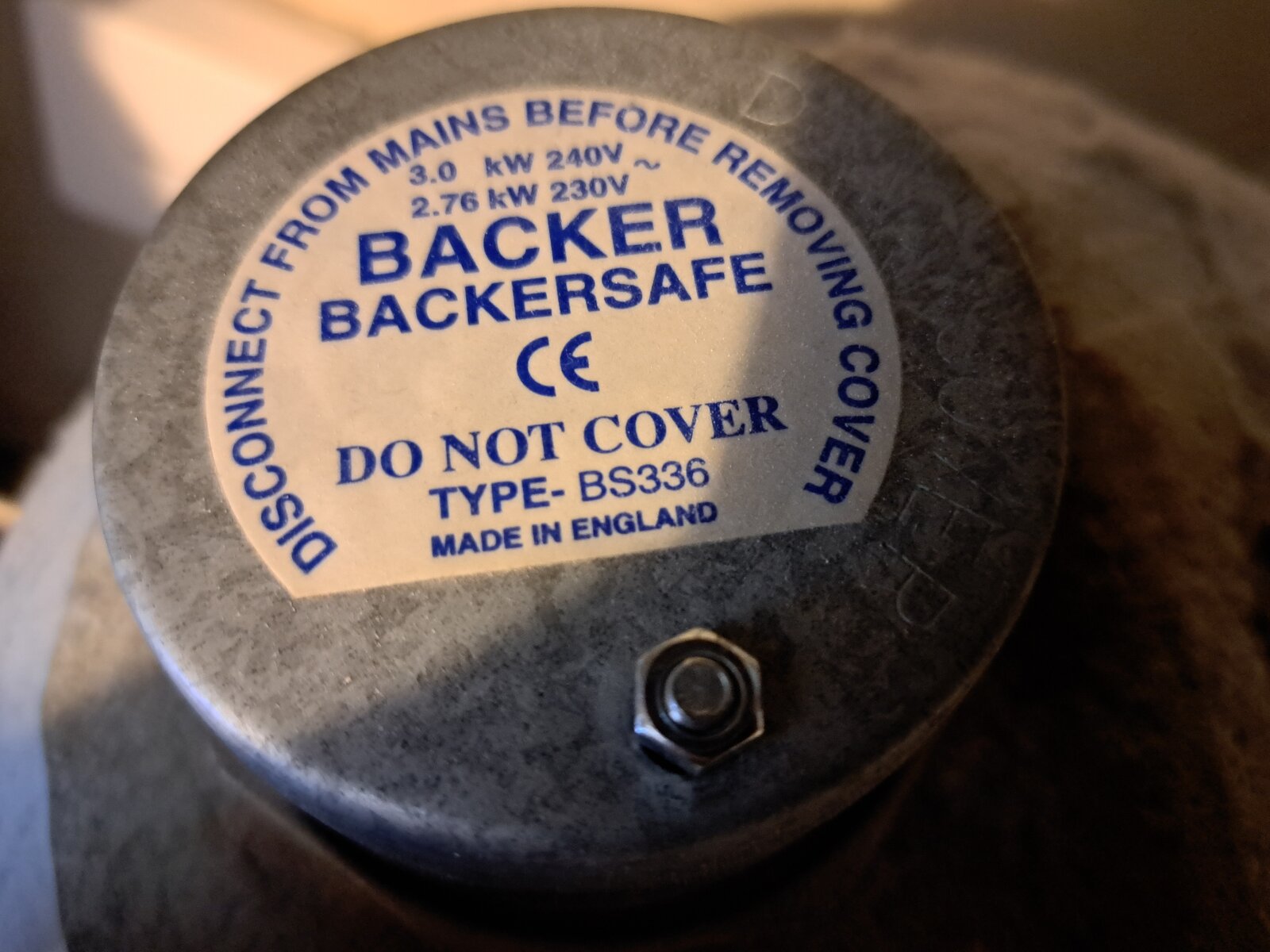

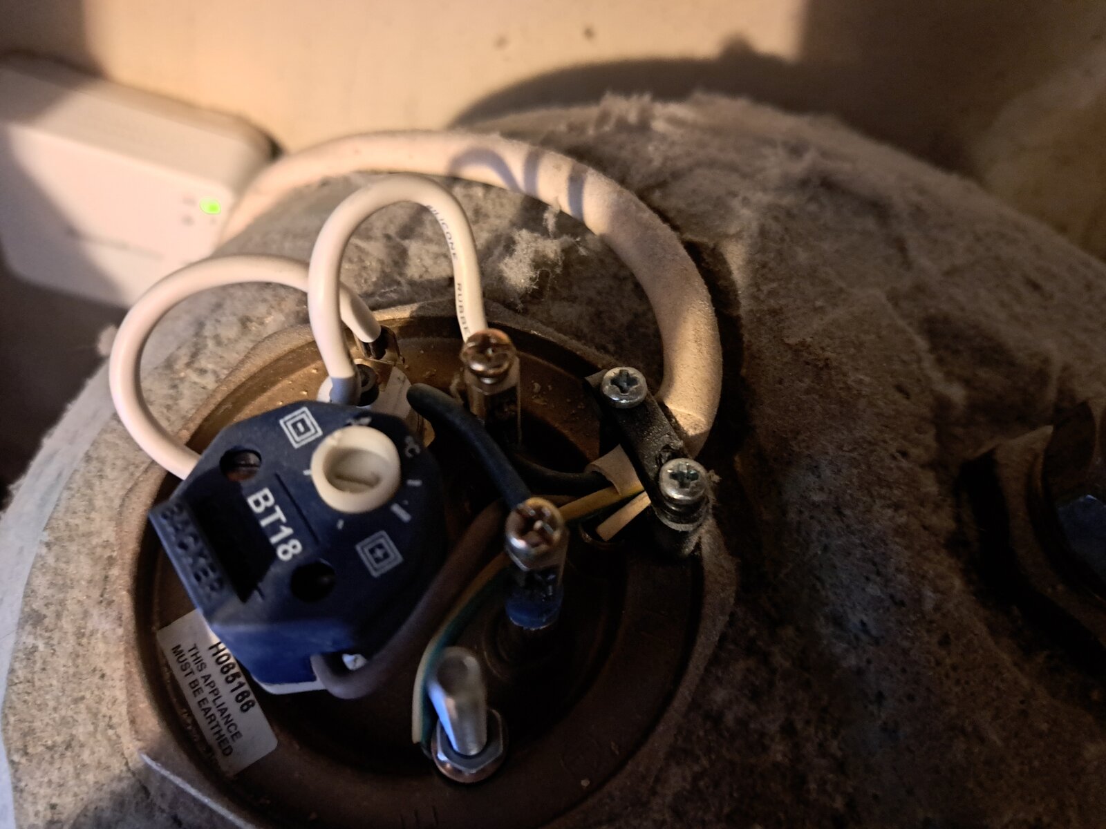

I've had this since about 2018 and have never thought to check if it has a cutoff which prevents the water from boiling if there's a fault. I have googled but there are several models and I'm a bit confused. Can anyone help? Many thanks.

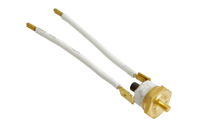

The more recent BT18 thermostats, include the cutout. Your photo suggests you have a separate cutout, as zoomed into by Eric, but I think I might be able to see a cutout built into the main thermostat - see the tiny, recessed white button, next to the larger, white temperature adjustment.
Perhaps the thermostat has been replaced by a later version?
I have seen both, the older type were just a control stat with a (the) separate o/temp stat attached as shown and wired in series with the control stat, if the o/temp stat operated on the one I saw, then the immersion cover had to be removed to reset it. The more modern type have a combined control & o/temp stat(s) and there is a reset push button in the immersion cover top.
So will mine still cut off the supply if the water gets too hot (boils?), but then can't be used again and will need to be replaced? How much water needs to be drained from the cylinder in order to replace it? I have tested the gate valve where the cold water comes down from the loft and that still works so I can cut the feed to the cylinder. The drain valve at the bottom looks a bit iffy though, so I'll probably leave the job to a professional.
You have two safety systems on that, to prevent it boiling. One with the two white wires, which is resettable, then one built into the thermostat. The latter, should it trip, is not resettable, you would need to replace it, should it trip.
None at all. The thermostat simply pulls out of a 'pocket', like a sealed tube.
