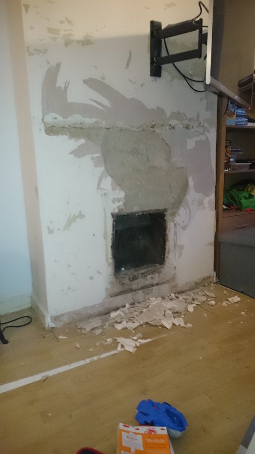

Does this look like a lintel?

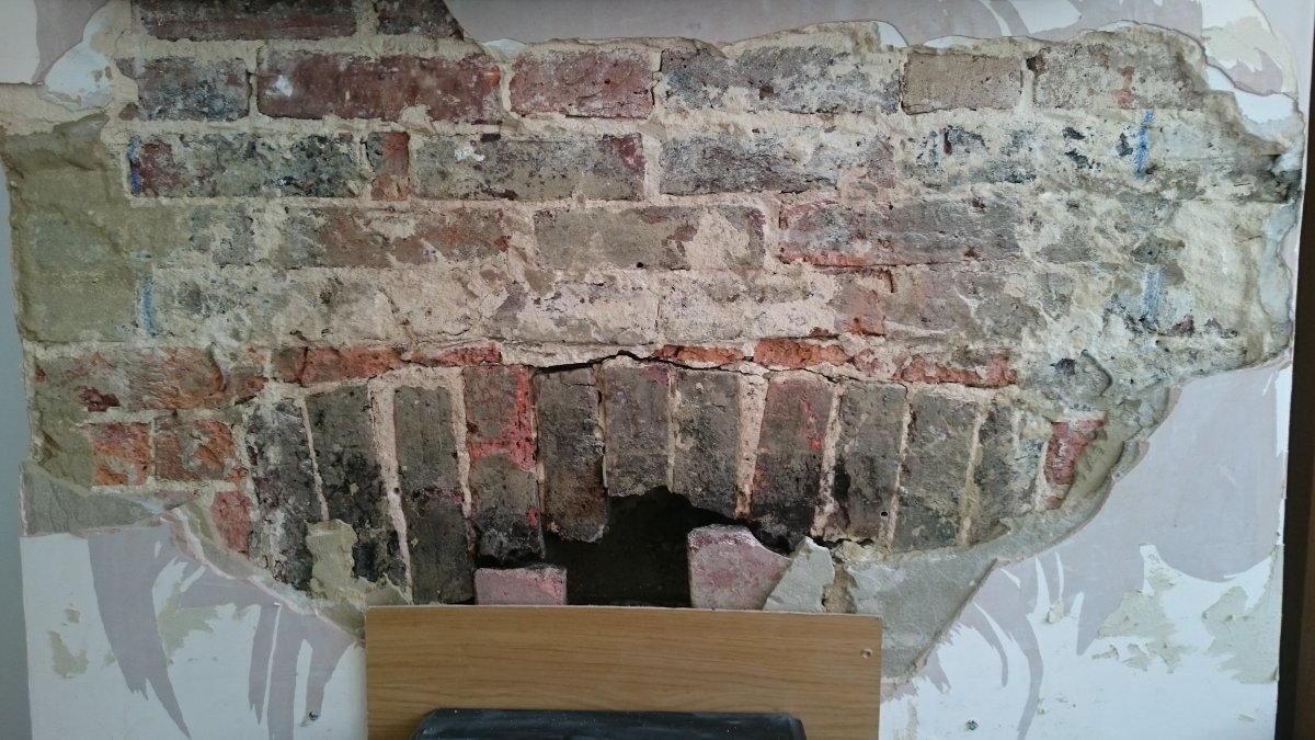

UPDATE!! I've reached the brickwork. Great news, there's a lovely arch! Bad news, arch is in a state :-/ what would you do..? New pics in comments below :)

I'm trying to open up our fireplace, but I'm feeling nervous about it. I've taken some of the plaster off, and by the looks of it I think there could be a lintel hiding in there? What should I do next?
I'm pretty good at diy, but never touched anything structural before, so any advice/reassurance would be great! The chimney breast is 130cm wide, how big do you think I can safely open it up?
Thanks in advance!

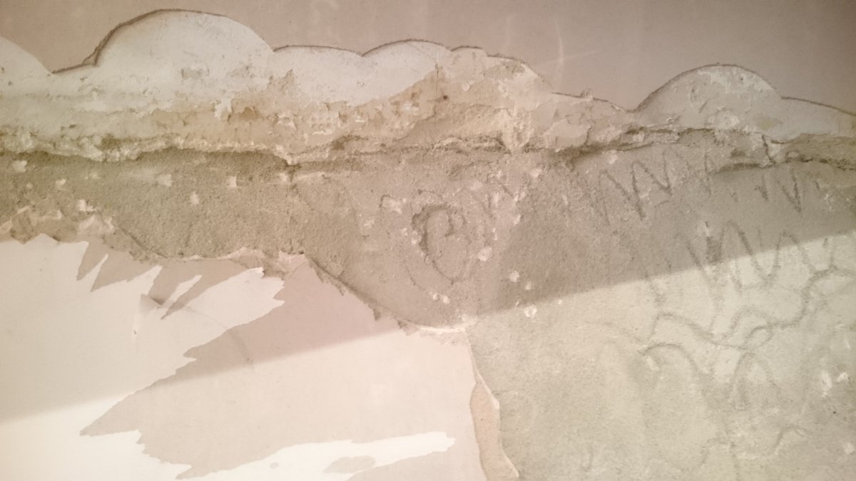

looks like youve only taken the skim off, theres another layer of plaster to take off
knock that off then post another picture
dont worry to much it will either have a lintel or an arch

Thought that might be the case :( I was hoping to get away with something like the link below, but I'm not sure it's in good enough condition to get away with it.
Off to get my Google on and look up installing a lintel - any advice before I do? Other than get a builder to do it! ;)

its right what that website says in your link, at the most all that might fall is a triangle above where the lintel is going, but very rarely does that happen.
have a go yourself, most of the time you'll get the odd one or two coming loose but more often than not none fall at all.

Jackie, if you've got this far, doing the rest shouldn't be beyond you're capabilities. This isn't really what you'd describe as structural, so don't panic too much.
First determine how far you want to open the fireplace up. Is it going to be just the original opening, or are you going to take it back to brickwork. Are you happy with just a lintel, and then plastering over it, or do you want to see the original arch that was there.
Assuming a square opening with a lintel; cut back the plaster etc to clear the line or bricks above the arch, and and at least a brick width either side of the opening. Cut out the line of bricks above the arch, and a further 6" either side of the opening, Get a concrete lintel from wickes that is 12" wider than the opening, and cement it in place, and use bits of slate whacked in above the lintel to push up the bricks above, and then cement in the gaps. Remove the arch below, and more of the plaster above to check for any bricks that have dropped and loosened themselves, and refix them in, and then get the plasterer in.
It would be worth taking some more of the plaster/render of further up, I have come across a secondary lintel being there.

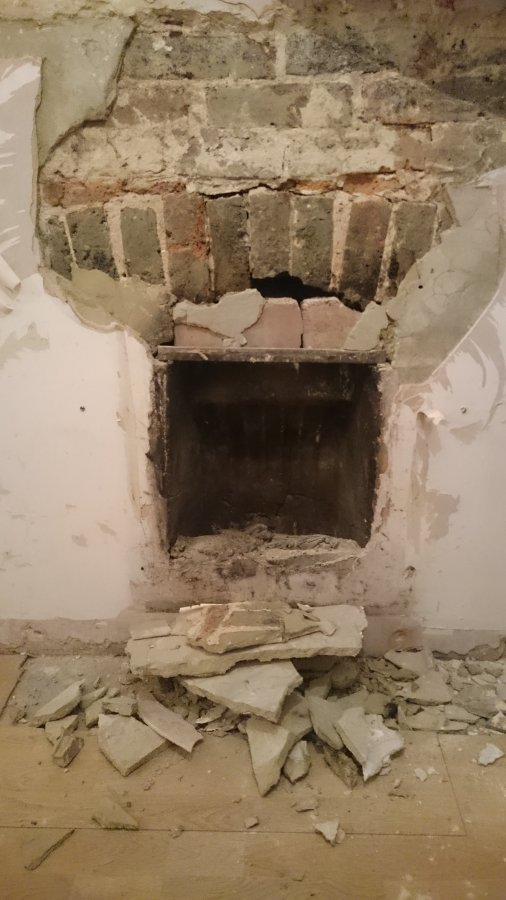

But the arch looks tired and if you are considering opening it up, use of the arch is not opening the distance vertically that much.
I would also proceed with caution when undertaking a task when it is unknown how sound the chimney breast is and removing structural elements of it!
These do collapse and can cause serous damage and injury+, so if you are to remove supporting elements, I would be using props to hold the chimney together.
I personally would be requesting a structural calculation by a SE, but that is up to you!

Brickwork isn't completely awful, but definitely seen better days! Think I'll put the lintel where the bottom row is (marked blue either side) - the bricks above that seem in better condition so would be happier about removing below there. What do you think about the bricks below though, do you think that when I've taken the arch away it'll have enough overlap to support it? The space between the bricks directly below where the lintel will be 75cm which is fine, but the last brick on the arch eats into the next row if you see what I mean..?
when you take out the arch youll have to repair the bit the arch went went into, as long as there a bit to sit the lintel on for now, get the lintel in place on a bed of sand and cement, then very important, pack the top of the lintel tight with sand cement and bits of old slate if you have any.
then repair the side of the opening if needed afterwards
That is bad luck, I would go ahead and fill the missing bit of the bricks up with mortar. It would be too thick to fill the hole in one go, but should do it in a couple of goes. leave the surface of the first layer scratched so the second layer will stick to it.
