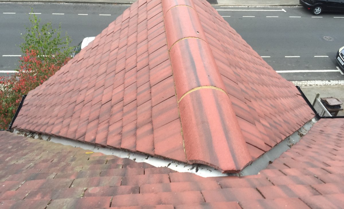

Does this roof tiling look OK?
2 Sep 2016
Hi,
Had a new roof fitted a couple of years ago and I've noticed that the way it has been done is different from any other of the houses nearby. And for that reason I am concerned as to whether it is up to scratch. In the attached image, I am talking about the joins between tiled sections not being tiled - I've seen on other properties that these are usually tiled and not left bare. Any advice is appreciated.
Thank you.
the topper course is missing, ridges may not be covering second last course
I think they maybe santoff 20/20 which look like plain tiles
or ashmore even, which would mean they don't need a topper coarse.
