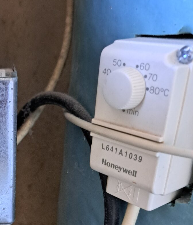

Your pics are not sharp enough in focus ,but I suspect the leak is from higher up ,and tracking downward, collecting on the nut .
You should be able to see staining on the vertical pipe above the nut where water has dribbled downward.
The top of the pipe has an air release valve on it ,and they are well known for slightly weeping.
