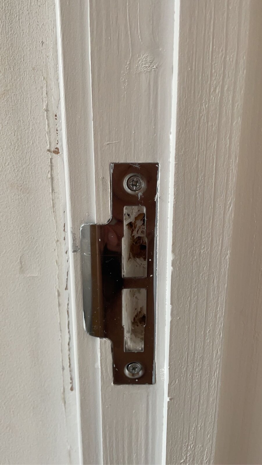

Hi all,
Basically my bathroom door doesn't close with ease. When pushing it closed, it doesn't fit into the plate unless pushed hard.
Not sure what to adjust.
I have attached a picture of the plate.
Also see Imgur link below for a video:
You need to match the catch plate shown in the second pic a few mm to the left, the existing recess will need some chiselling. That way the catch will sit in the recess.
