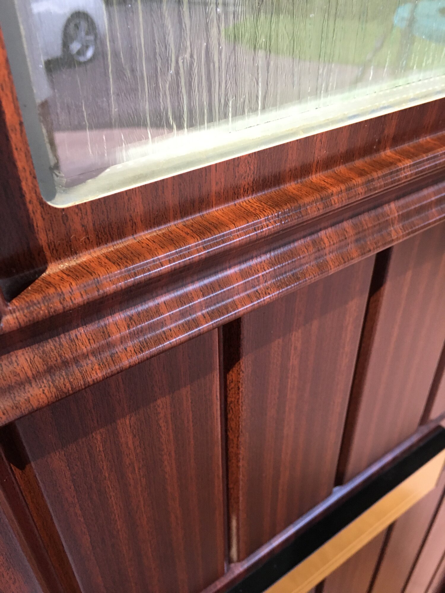

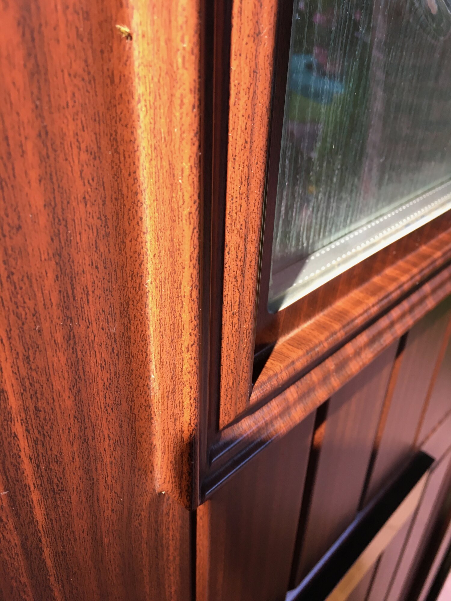

We want to replace the bullseye unit on our upvc door but I can't find a way with all angles seemingly sealed shut.. see pics.
I'm sure there are a few Ethan Hunts out there so any help welcome.
Unfortunately on panels such as yours the glass unit is sandwiched between both skins during assembly and put in a press, its staying put now or a new panel is required
Mmm..The tape has self destructed.
That's what I thought but thought it was a bit of a rubbish design. Ho Hum. Thanks for the reply anyway!
